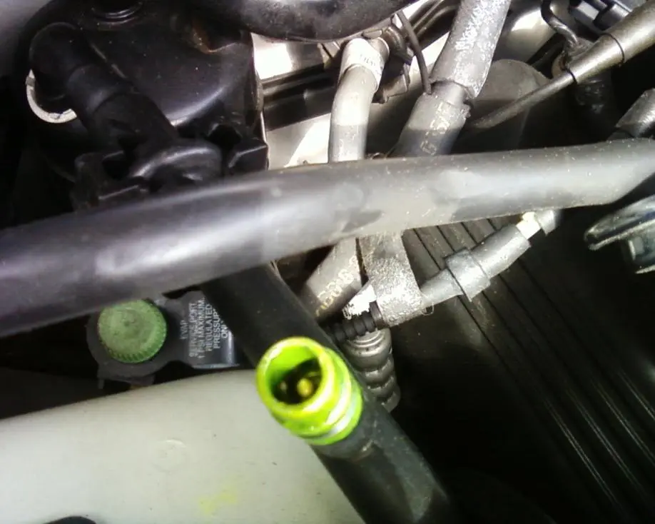

I looked under the hood at the A/C system, and this is what I found.
First pic, is this the a/c low pressure fill?

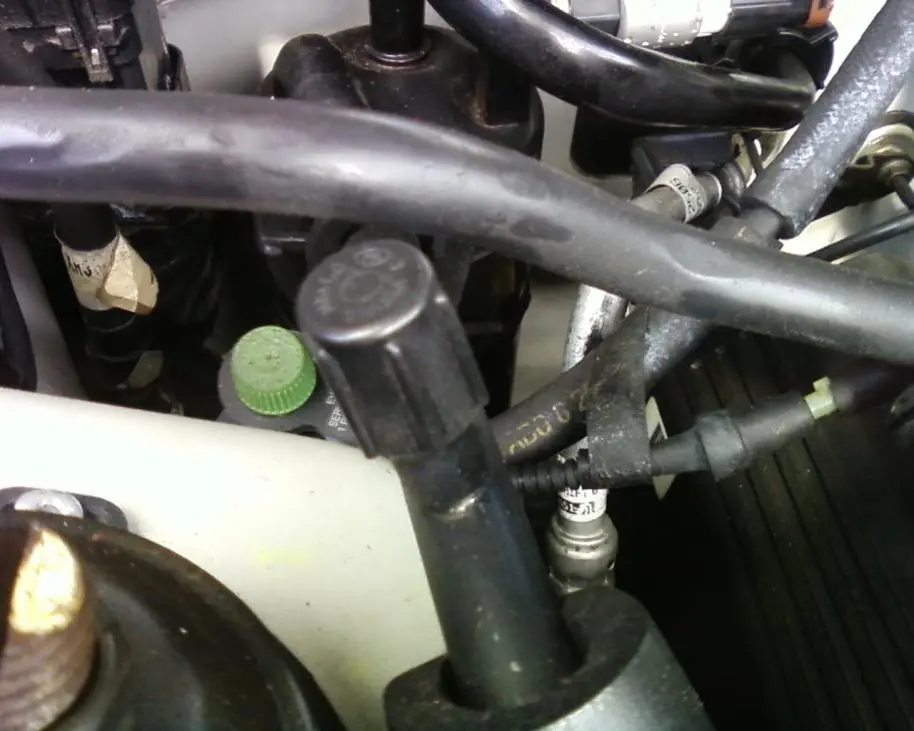

2nd pic, this is what I found when I unscrewed the cap.
