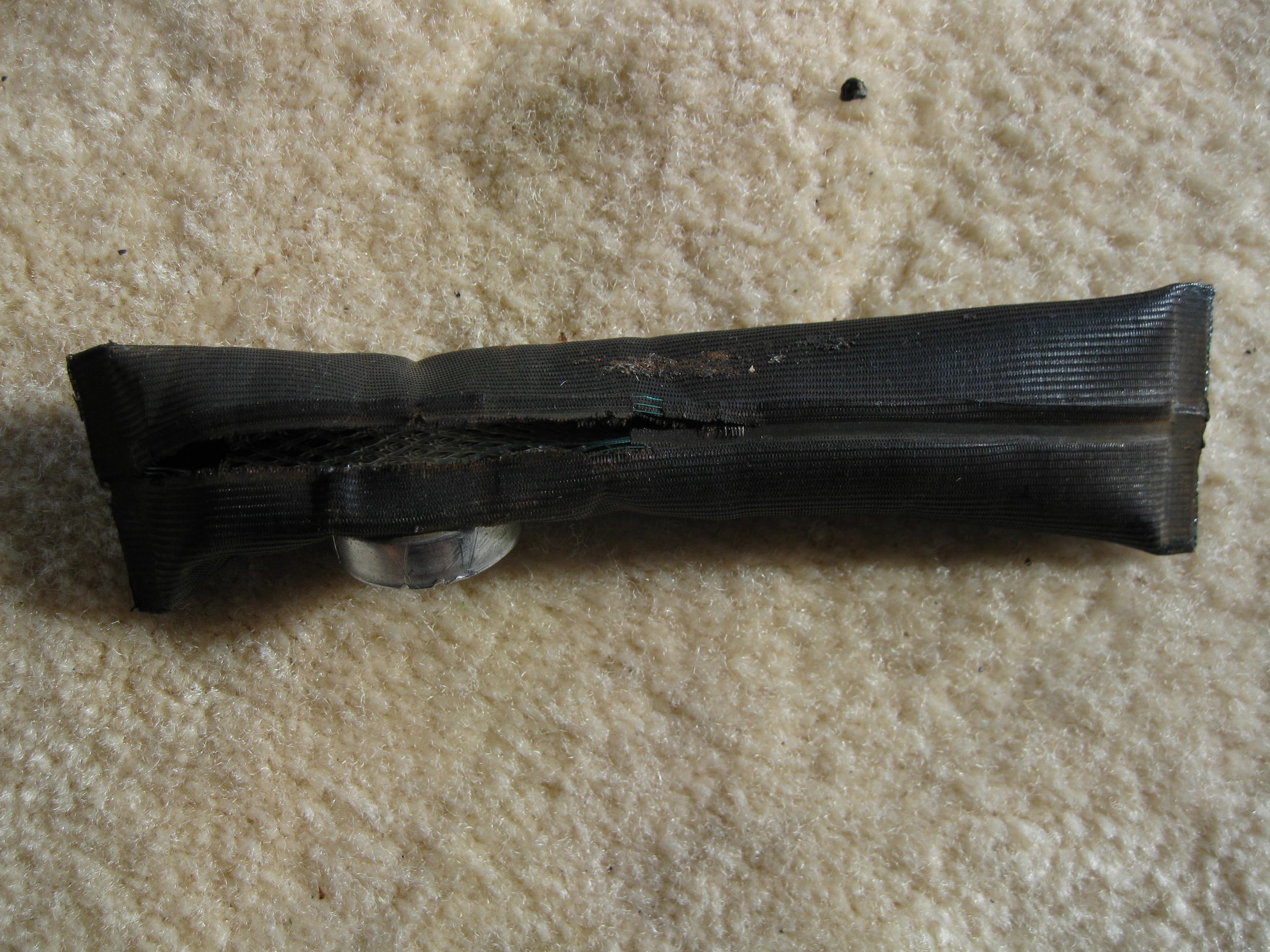

Stang9050 said:
...Car runs well until it starts to warm up, then it jerks, bucks and stumbles...
Fuel Pump. They can run perfectly at idle, but when under load (car in gear on the road, not on lift), they will do exactly what you say. You will see the mechanical fuel pressure gauge drop to zero & then recover, over & over again. In my case, the pump sock had come apart & a bit of plastic was covering & uncovering the pump inlet.
Reactions: Shakerhood and Stang9050
