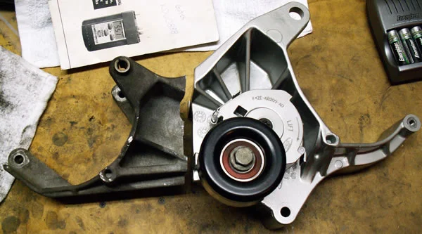

I should find out how it works pretty soon. I currently have the smog delete and A/C delete pulleys. I want to pull them off, and just run a shorter belt, then cut the brackets off to make it a little cleaner in there.

Good info to know. I chopped off my smog bracket.... if my A/C ever goes south, I may chop off that bracket too. :D
