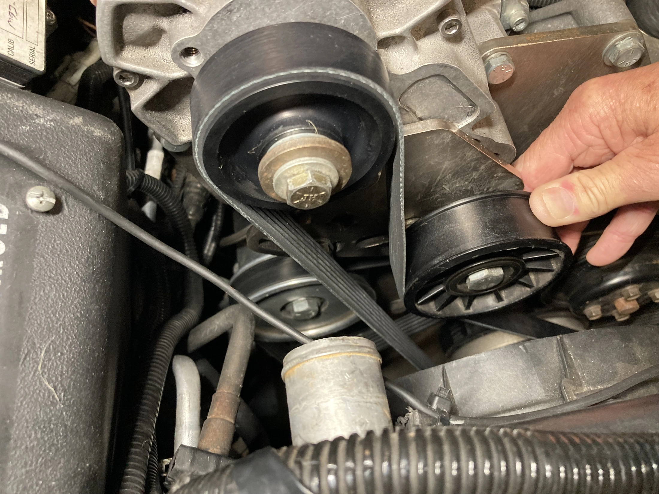

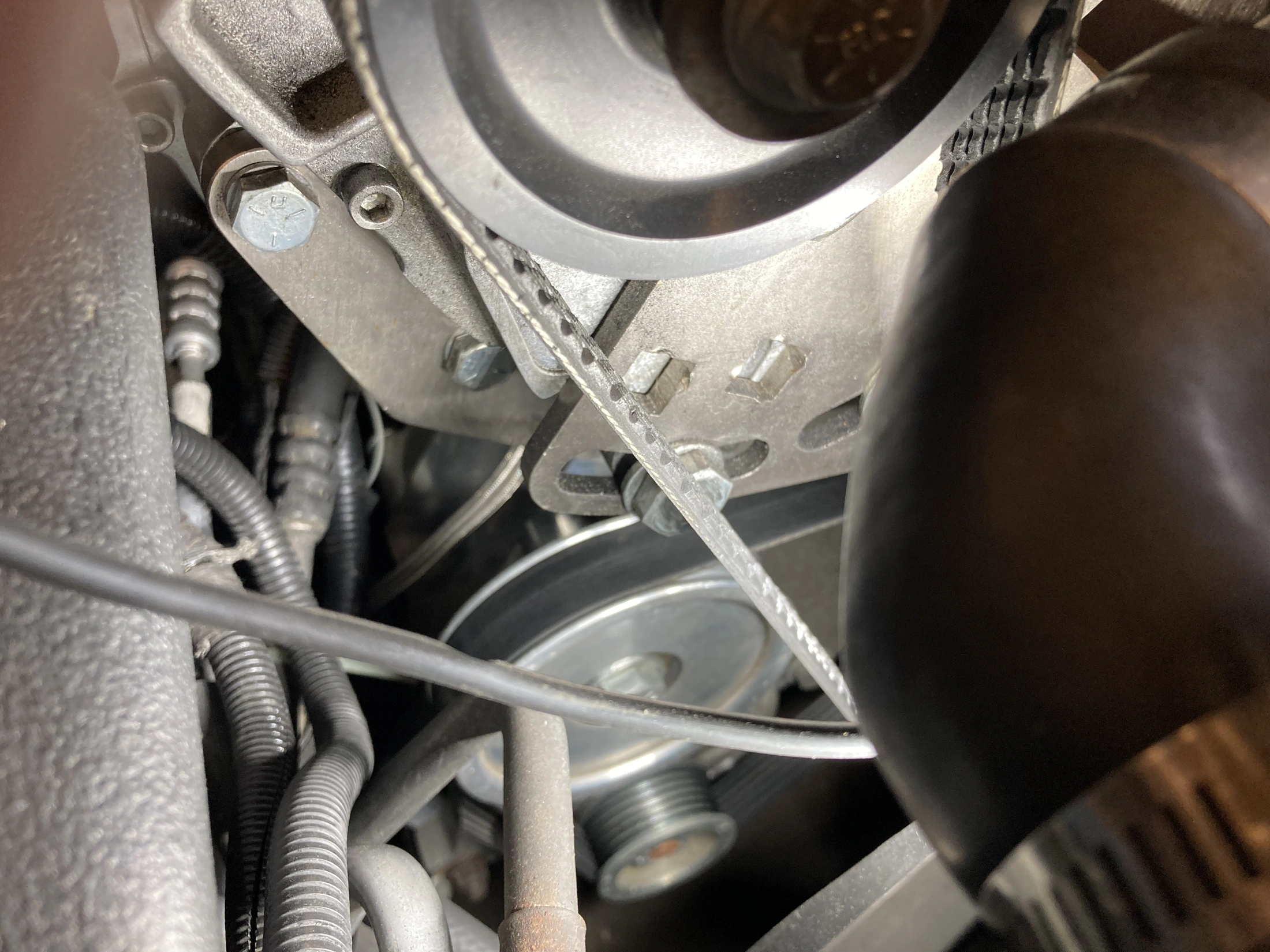

I want to change from the entry level 3.33” blower pulley to a 2.62”. I’m wondering if my current belt will work or if I’ll need a shorter one. As you can see in the picture, with the 3.33” at proper tension I’m the middle of the adjustment slot. Is there enough adjustment room left to take up the slack created by the smaller 2.62” pulley?

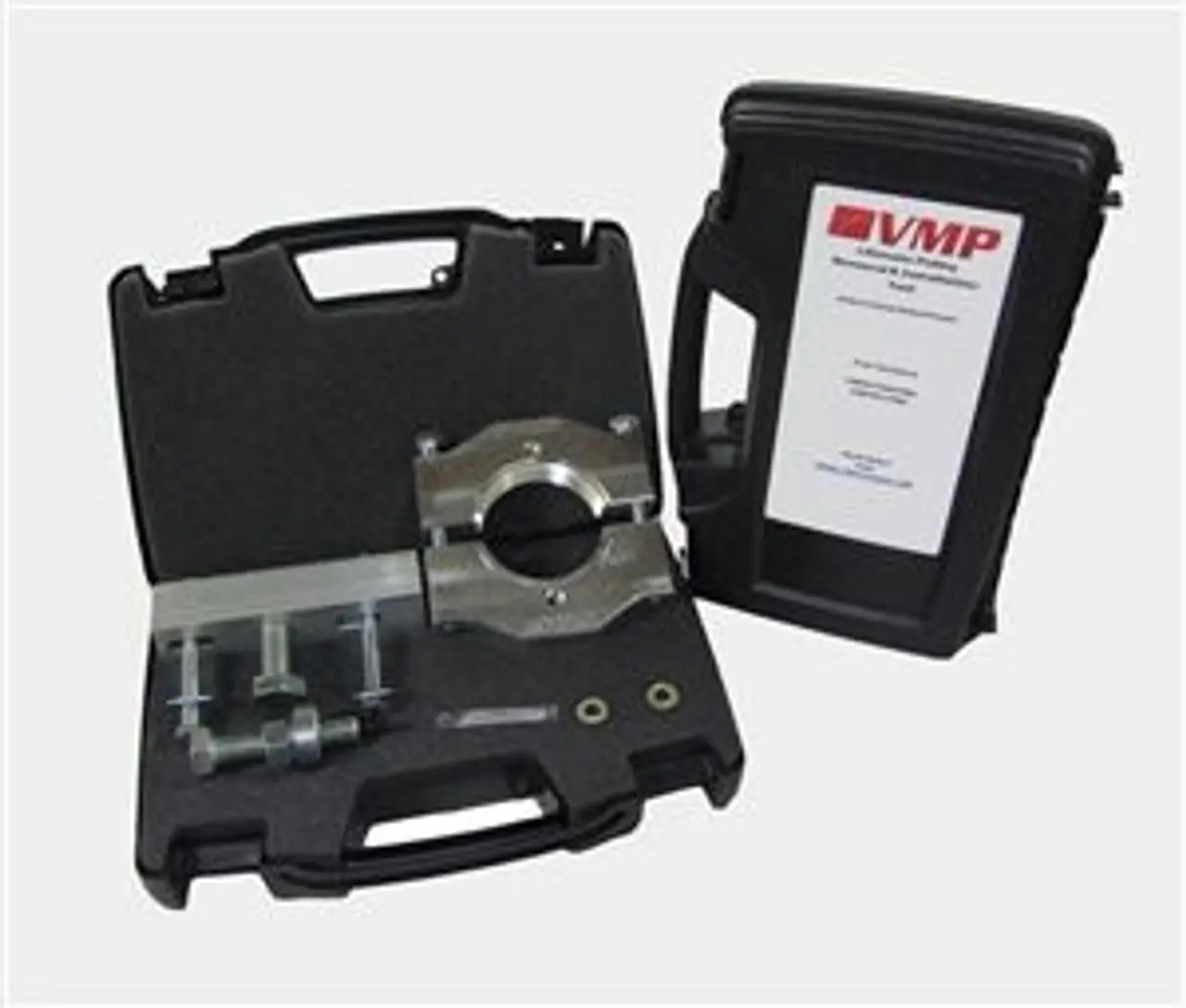

Vortech does not appear to offer their own tool. Most say to heat it and slide it off by hand (ok use a glove or something, it's hot!!!). :D Use anti-seize when installing the new pulley.
It's nice to have a clamshell puller standing by for stubborn aholes:
From Vortech's FAQ Page:
What is the best way to remove or install the supercharger pulley, and the appropriate torque specs for the supercharger retaining bolt?​
Using a plumber's torch, carefully heat up the outside perimeter of the pulley to be removed or installed, as this will help to expand the opening to ease installation. When installing the pulley, apply a small amount of anti-seize on the input shaft and key, and then slide it on. Steel pulleys may rust themselves to the shaft if not lubricated. Never force or hammer on the pulley or supercharger shaft. It is also recommended that a small amount of blue Loctite be applied to the threads of the retaining bolt prior to inserting into input shaft and then torque to suggested 25-30 ft./lbs.

The supercharger pulley I have that I want to swap to is actually a 2.95”, not a 2.62”. I tried it with my current 6PK1345 belt and its a no go. Just a tad too long for the 2.95. I’m running a 6” crank pulley so I really want the smallest supercharger pulley I can get. Thus, I have a 2.62 on order from Vortech. When I put it on, I’ll set the adjuster at an appropriate position and tie a string around the whole thing to get the number for a good length belt to get. I’m guessing something close to 6PK1300. The 1300 is millimeters. I’ll post back with the final belt length that works with a 6” crank pulley and a 2.62” supercharger pulley.

The 2.62” pulley was delivered yesterday. It would not slide on without applying heat. About 90 seconds of heat gun action while slowly rotating and it pushed on fully by hand.
I set the adjuster in the center of range and tied a twine string around the assembly, cut it off and measured it. 51” is the number. A 51” belt is scheduled for delivery today.
