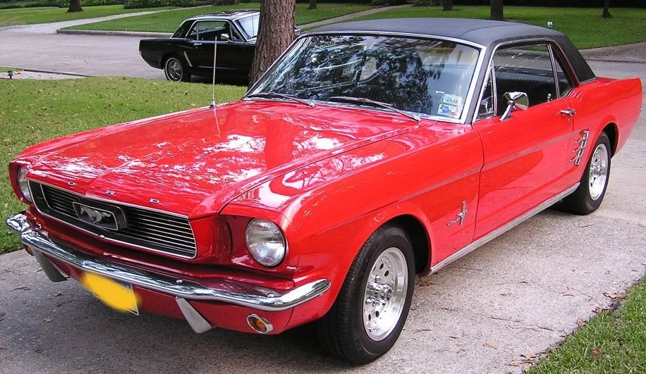

I have budgeted 10k for the engine and transmission for my 66 with the 289. I have decided to completely rebuild the motor from the groud up. I am looking for reliability and horsepower second. Our target is 300-350 HP when complete. We will also completely rebuild the transmission (3 spd. auto).
If this was your motor and transmission what exactly would you do? I am new to older cars so specific names/brands/model numbers will help me out.
here is the car

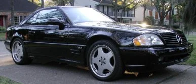

and here is my daily driver
