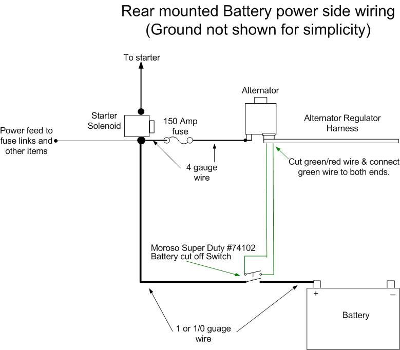

I found this on another thread, and would love to see his wiring diagram

Originally copied from the same source, Jrichker.
Hope this is the diagram you wanted. Anytime I see a helpful piece I save it to my computer for future reference.
