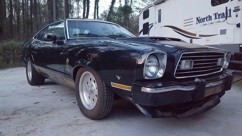

Got my lock cylinder replaced. Did A LOT of searching and experimentation, the GT keys did the trick after wiggling it a bit. I went through my carburetor, attempted to fix a fuel leak (the new line that feeds the Holley is now leaking.... :rolleyes:) and checked my fuel for any signs of contamination then put some fresh gas in her. She fired up after a little bit and I moved on to other projects. Last night I decided that I was tired of seeing her with all of the tree pollen and built up scum and took her to the car wash. She still needs attention, but it was great driving her and hearing her on the road! And the few little things I did to the carburetor when I went through it really seemed to help!! For those who are just now joining my $#!+ show, I swapped intakes on her but really never had a chance to go through my carburetor. All I did was take it back to the stock jetting and squirters.
Anyway, here's some pics for everyone! Strategic angles help hide her deficiencies.... lol
