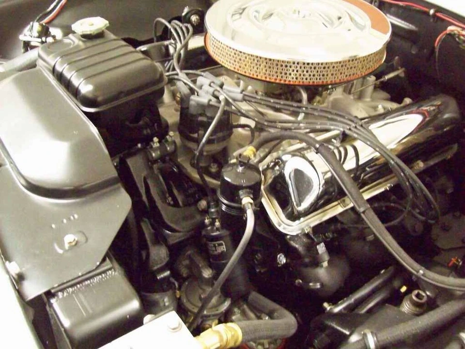

Well, considering the stock coil and distributor were used in racing vehicles, I'd suggest finding out what's wrong before spending a bunch of cash.
This is the ignition system is the #28 Dan Gurney Galaxie.

Exactly. I just came at it kinda sideways. It's no secret I have a low opinion of exotic, expensive ignition systems. The above advice is much more useful than my off-hand remark and photo.
If the stone-stock ignition was sufficient to drive such engines as the BOSS 302 and BOSS 429, and yours "skips under a load", you need to look at your carb and ignition adjustments real hard.
