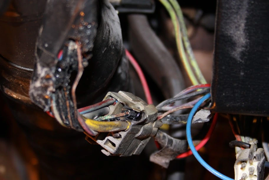

Found the problem
I took the steering wheel bracket off. I found the source of the smoke:
This is the 8-pin harness from the steering column. It's like a taco Bell commercial Crunchy, Melty hot and fried.
To the left is are the wires leading to the ignition switch. Among them is a big yellow wire, melted as the rest. They're actually melted on both sides of the plug, as is the plug itself. It looks like the little wire got it worse than the yellow at the plug.
I'm not sure which is the culprit.
Can I replace this section (keyswitch to plug, plug to ?) without splicing in wires?

I finally got back to it pulled the cover and looked at the switch. Damn.
The ignition wire (the "on" position, keeps spark running, as opposed to the starter) is melted and bare, from the switch terminal to halfway through the engine compartment. I'll start removing tape in the engine area, but I see burned bare wire across the back of the firewall, in the bundle heading for the battery/voltage regulator area.
Pics here:
http://picasaweb.google.com/scott.kolesar/Wiring#5378941755965890114
I think the wire on the ignition switch was pink. As you can see, BarnStang, the plug is not really a factor, as mine is melted; I'll have to replace it somehow.
Wow. The wire that got it worst is the Red w/green strip. It looks like it is wire 16 that goes to the coil. You can save the plug, just crimp on a male and female bullet connector to the new wire at the plug to go around it and still be able to disconnect it.
The other wire it took out is the Red w blue strip wire which is wire 32 going to key the solinoid. But I think that is collateral damage, you just need to repair that one.
Oh, yes, on the stock switch the wire that burned is a pink wire, on the new switch is might be red w/ green strip. I see now on my switch I spliced it to the pink wire. Intersting that the wiring book shows it as red w/ grn strip and not pink. Hmmm, there are two sheets for ign, start, charge, gauges. One with a tach and one without. The 70 wiring book is the worst next to the 71-73 book.
I think we need to know if your car has a factory tach at this point to make sure we don't fry anything else.
It looks worse than it is. You will have to peel the whole harness apart and make sure all the damaged wires are repaired or replaced-one wire at a time.
Again, you need to know absolutly what caused the short so it doesen't fry the new repaired wiring.

I'm halfway across the firewall, and about to start peeling tape from the bundle leading from the upper mid firewall to the regulator/solenoid/battery area. To this point it's been easy because the burning wire has melted it. What wire I can see to this point is bare from the ignition switch out across the firewall. It's the circuit you described, it's heading for the solenoid. Marked as 'ignition' in the wiring manual as opposed to starter or accessory. It looks to be the wire that maintains the 'ON' condition of the engine. [excuse the newbie-speak, I'm learning as I go here]
Unconfirmed: the harness may have fallen into contact with the engine, and shorted at that point. I don't see damage in the solenoid/battery/voltage reg. area at the other end of the bundle. At the rate of things around the homestead, it may be next week before I can dig in to confirm.
There is a fleeting reference in the shop manual to the fact that it was pink, but I see by your picture it is red/green. Also, I'll confirm that your switch is opposite of mine as to the bracket mount.
I'll probably need to get up under the dash when I go to repair, at which time I'll probably confirm the rest of the bare wire. For that, I'm probably removing the driver's seat for comfort. and get better task lights. It's going to take time to assess and repair. The previous owner has convinced his daughter (my wife and current owner) that a new harness is not necessary, and "we can fix it". There's no point in trying to sell another solution. I'll have to buy a new fire extinguisher though.
The plug is toast. I can't even separate the halves. I'll check continuity among the other wires across the plug and proceed with the repair. Is it possible to get a new plug and re-splice the cable into it? Surely there's something to put bullet/socket ends onto the wire bundle and snap them into a plug. I will be getting a new harness for on top of the engine, as the current wires are brittle.
