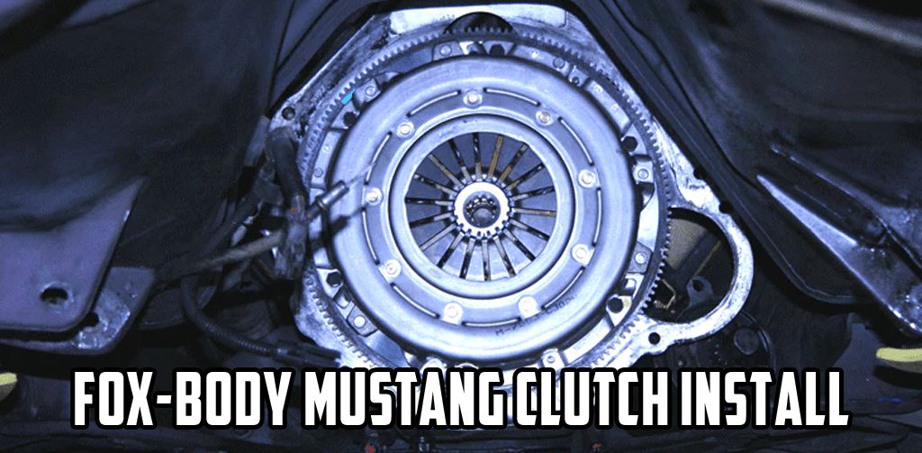

Here is a pretty good step by step. I would revisit everything you did, and maybe something was missed.
