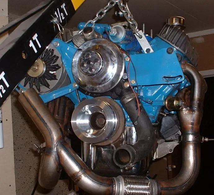

I'm ditching the stock power steering pump.
I works great, but I can't get the damn thing to stop leaking.
I don't know what god you non-leaky pumpers have been worshiping, but it must not be mine. I've gone through 2 different pumps and 2 different sets of hoses. I've had everything apart on numerous occasions. Tried new seals...you name it.
I'm giving up on the stock pump. Don't even want to look at it anymore. I'm trying something else.
So what do you guys reccomend I replace it with? The rest of my power steering system has been freshly rebuild and looking mint, so I'm definately staying with PS.
I want 2 things in a new pump:
1) Has to be something that doesn't fricken leak. Or even been known to have a tendancy to leak.
-2) Prefer something thats going to be fairly easy to retrofit. Have welder, not afraid to use it... but I like easy.
Here's what I've got to work with. This is a pic from last year, but it'll give you a good idea.

Due to the higher pressures, you cant use the hoses shown on the picture because they slip on the barbed fittings and will not stay on. You need to get high pressure hydraulic hoses with socket type fittings(also known as reusable), or swaged fittings(like the ends of the factory p/s hoses).
Aeroquip lists the hoses KRC sells as Power Steering Specific hoses. They have high pressure and high vacuum ratings. These are not the hoses shown in the picture above.
