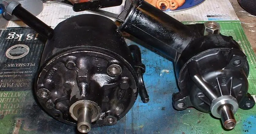

Stock '70 pump and mid 80's fullsize pump side by side. The newer pump is much smaller.

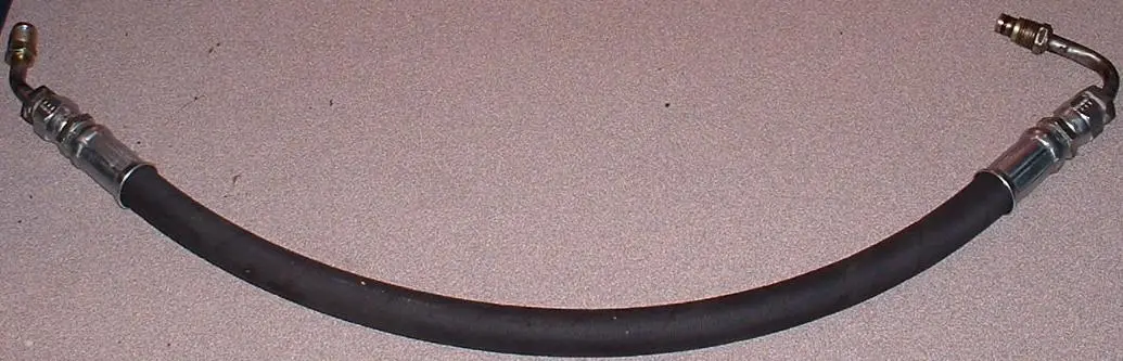

Here's the custom pressure hose that I had built. They just cut the ends off of my old hoses and welded them to new fittings. I forgot to mention to them that is was a light duty application. They used the 3500PSI hose. It works fine, but the lighter hose is easier to work with.

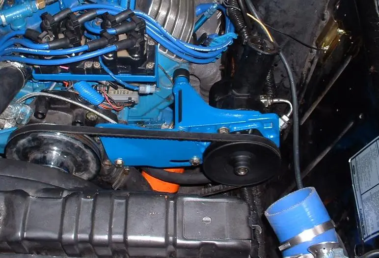

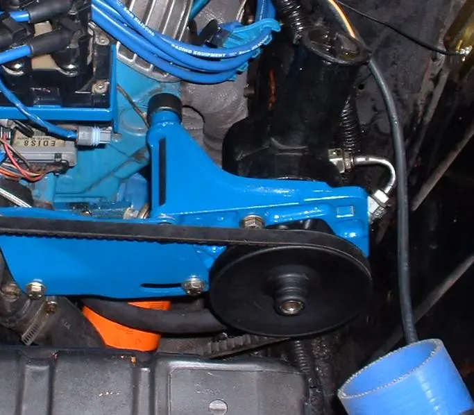

EDIS is new this winter. Haven't insured the car yet so I can't really comment on how well it works, but from what I've seen in the garage (starting, idle, reving, etc) it's certainly an improvement. With the turbo I didn't have enough spark energy above 5000RPM, I'm hoping the EDIS upgrade will fix that.

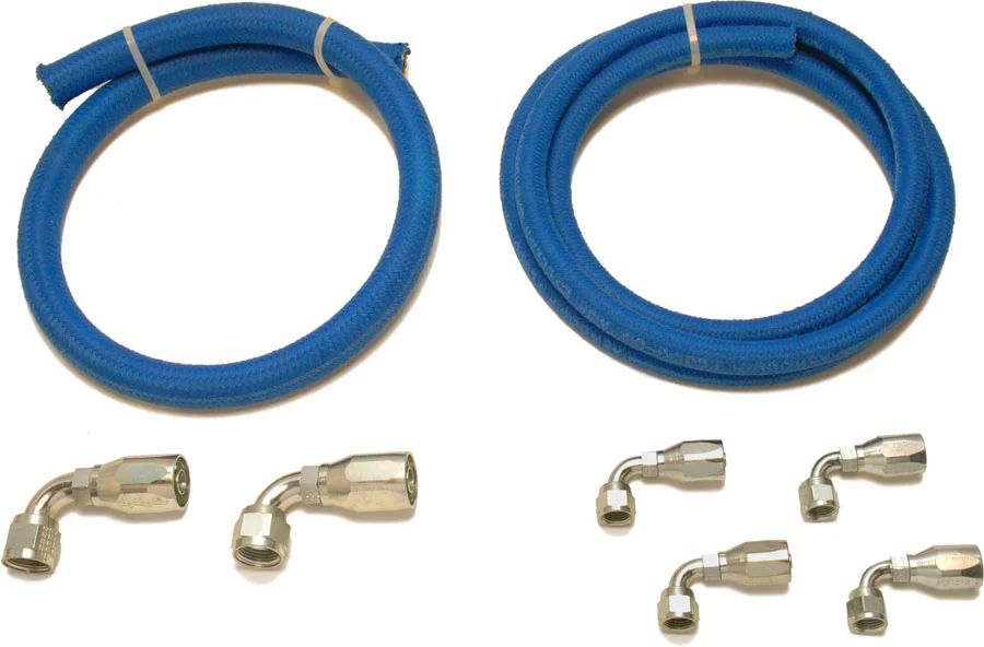

However, do NOT use the blue hoses!!!
Ya know, I read this and thought "gee, thats interesting, we put the blue hoses on two of our project cars with TCP power racks...they seem to be ok."
Weeeellllll, we had one of the cars out to swap the carb and swung it around in the parking lot pretty fast, so the steering was turned to the lock, and the hose blew off, sprayed power steering fluid all over the header and caught on fire! No damage, just flashed the fluid. Only a few seconds, lots of smoke, and lots of adrenelin...
So, hopefully this post will let anyone else who thought it was interesting to give it a second thought or two, if they have these hoses installed. Ours are coming off both cars...
Just to be clear... the hose kit shown in the engine bay photo is not the same blue hose kit that is sold through Total Control Products. We supply high-presssure-suitable hoses and steel, field-attachable fittings for both the low pressure -10 feed line and the -6 high-pressure and return lines.
General info in regards to BarnStang's post: The blue -6 high-pressure hose, when properly installed with the correct field attachable fittings, has a burst pressure of 2500 psi. When using a TCP rack and KRC pump, under normal driving conditions (donuts included :)), line pressure will generally stay under 400 psi.; well below the burst limit. Potholes, curbs, and such will give you line pressure spikes of around 1500psi or more, but normally not enough to blow off a hose.
