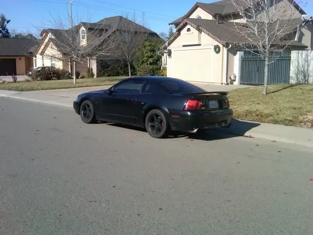

here is a pic of my car you can see how the front fenders and door are flat already, but very crappy flat. and the roof and rear quarters are stock gloss. bassicaly the flat parts of my car are about the right shade and color, which looks prety close to what you ended up with. i think it will be good. and im going to respray the wheels the same color. i cant wait for the weather to warm up so i can get to spraying.

Well the Kirker paint looks like good stuff for the price and alot cheaper then the PPG and you may get just as good a paint job as long its painted right and cleared , also you can clear over this paint but I did not see if they make a satin clear but they say you can use other products with their stuff , so if they dont have a satin or flat clear you can use the PPG Flexed "N" Flat clear mixed with a little bit of standard clear to get the amount of satin you want !
