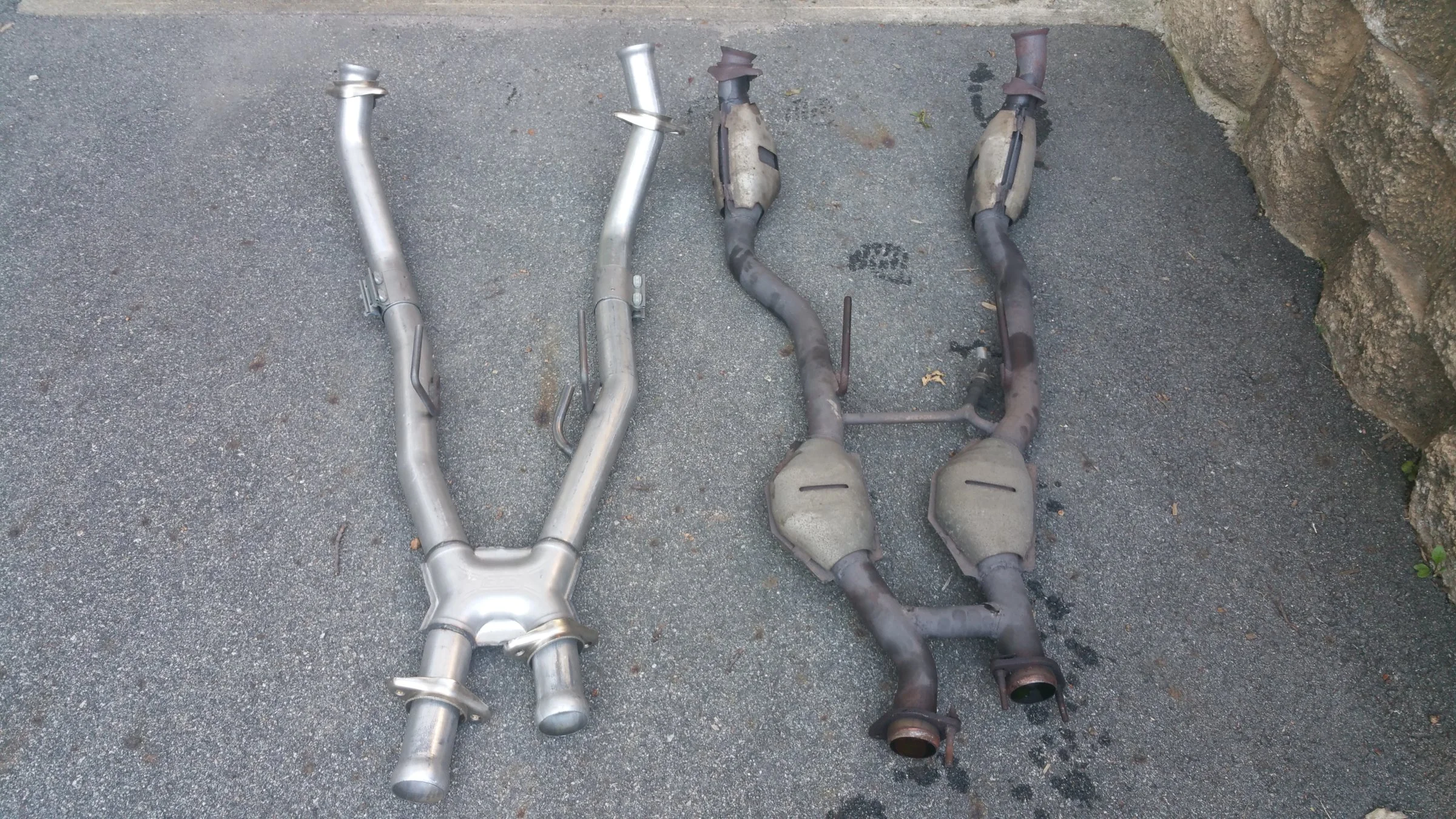

I have the BBK off road X pipe, the down tubes are both adjustable, I used a little copper RTV at the headers and no leaks yet. I had an existing flowmaster cat back so I did need to play around with the alignment, it seems the new x pipe sits a tad lower than the factory which caused the tailpipes to sit a little closer to the bumper. I may just go ahead and get a new cat back since the corrosion over the years won't allow me to adjust the tailpipes at all

The BBK X pipe looks good, I'll be going that route. I think what I was looking at was the older H pipe.

Although I should really think about a new mid pipe. I'm still running a stock h pipe.
Oh yeah, when you take the stock pipe off, toss that thing in the attic.
