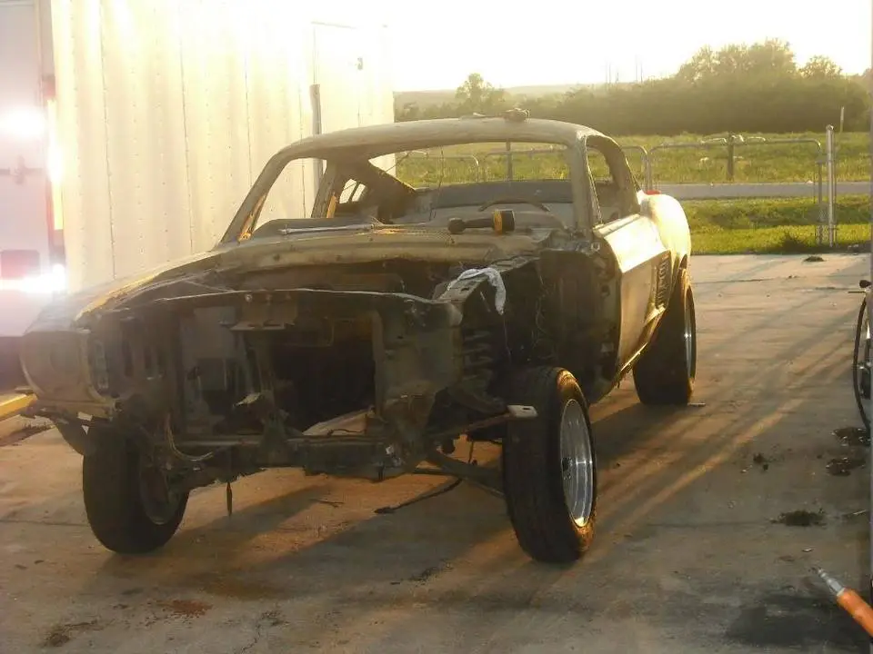

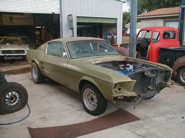

i started rebuilding it in may and i thought i would share. this is what i started with pics look good.
4-1.jpg picture by gr8one71 - Photobucket

forgot to insert pics sorry

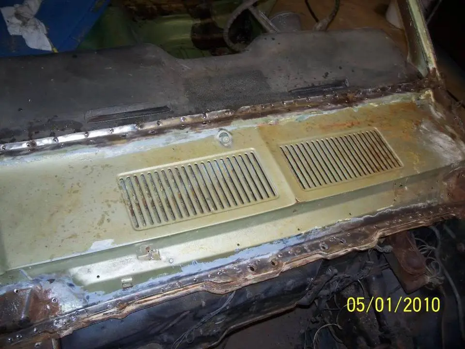

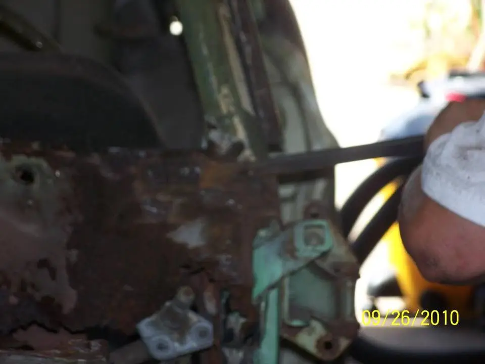

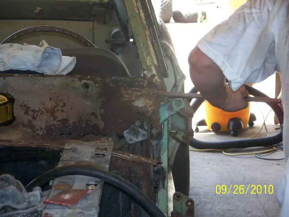

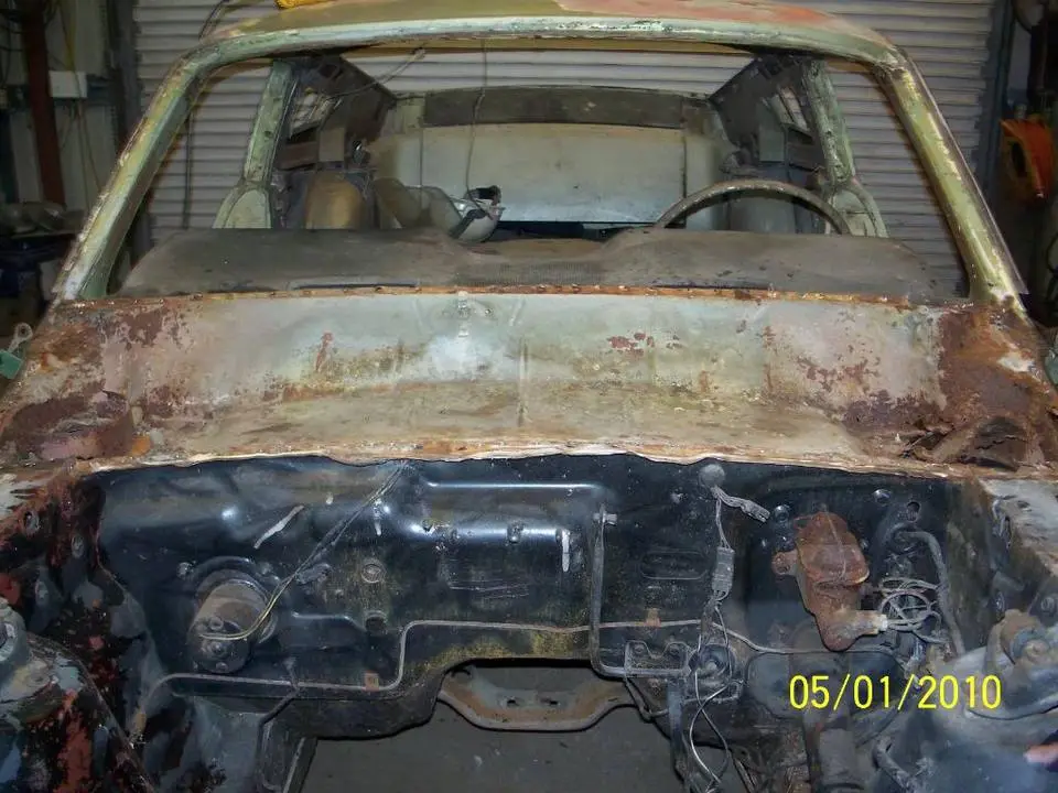

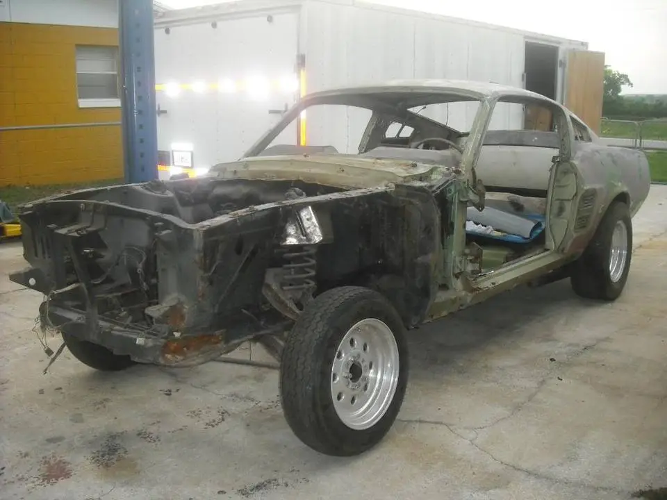

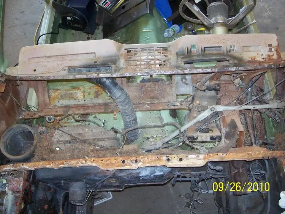

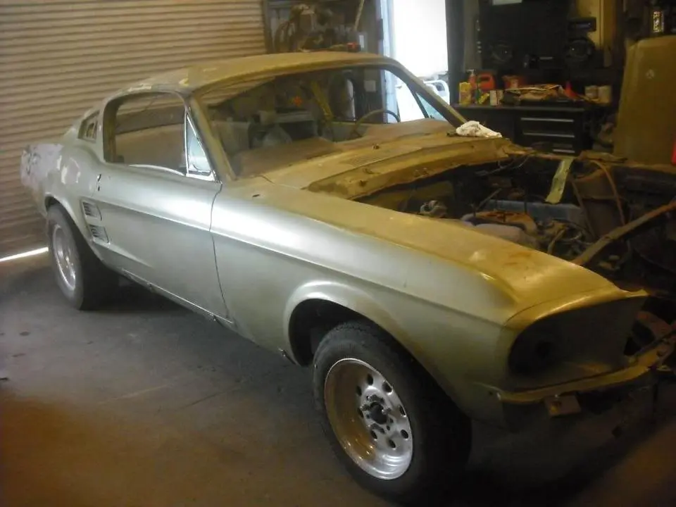

june started removing paint with a razor
http://i374.photobucket.com/albums/oo182/gr8one71/DSCF9733-2.jpg
removed all sheet metal

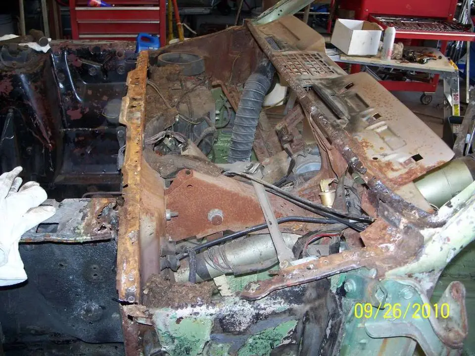

G
gr8one
Jun 28, 2008
52
Ft. Meade Polk Co FL
Oct 2, 2010
  • Oct 2, 2010

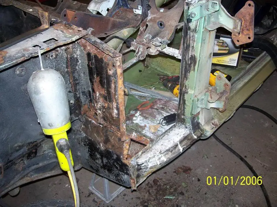

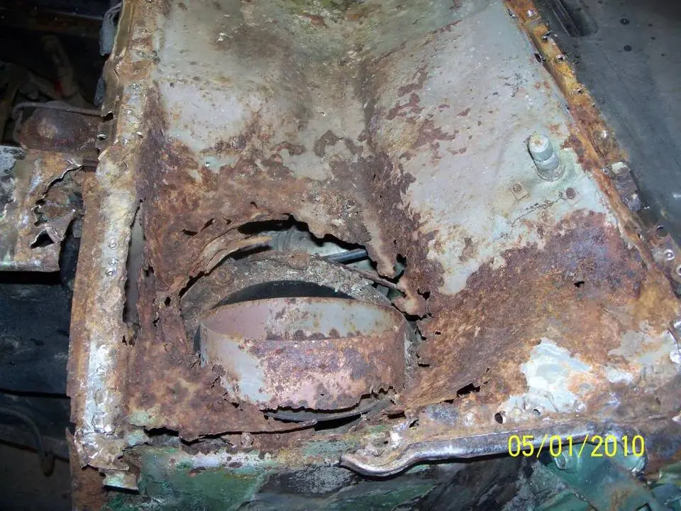

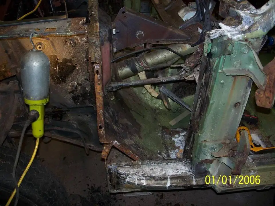

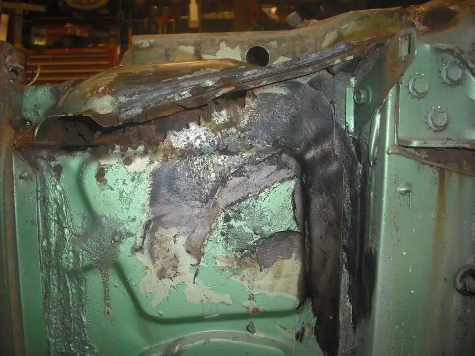

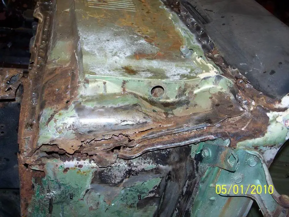

cowl section driverside was the worst

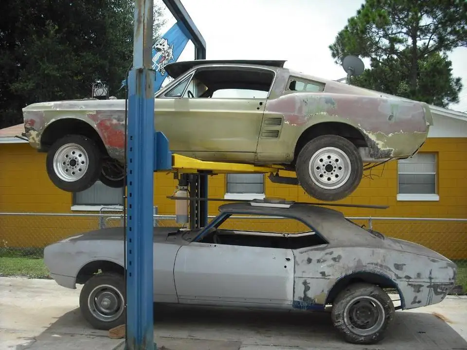

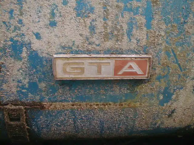

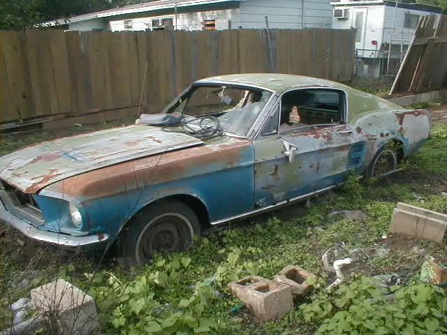

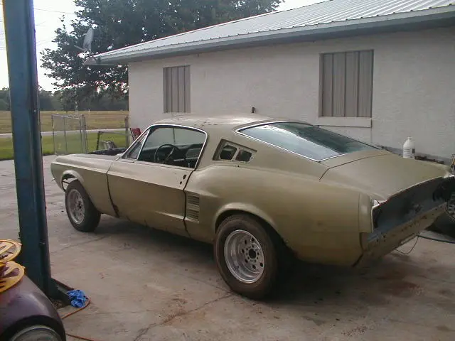

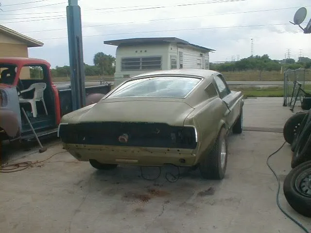

ive got 3 67 fastbacks, 1 gta with 63138 miles on the title needs total restoration i have a marti report on it. 1 has deluxe interior, and the other 1 has power steering. i stole all 3 of them from my father in law for 1500, he has had them since the 80's but hasnt done any thing to them.
the gta
the power steering fastback
i also have a 67 camaro rs/ss

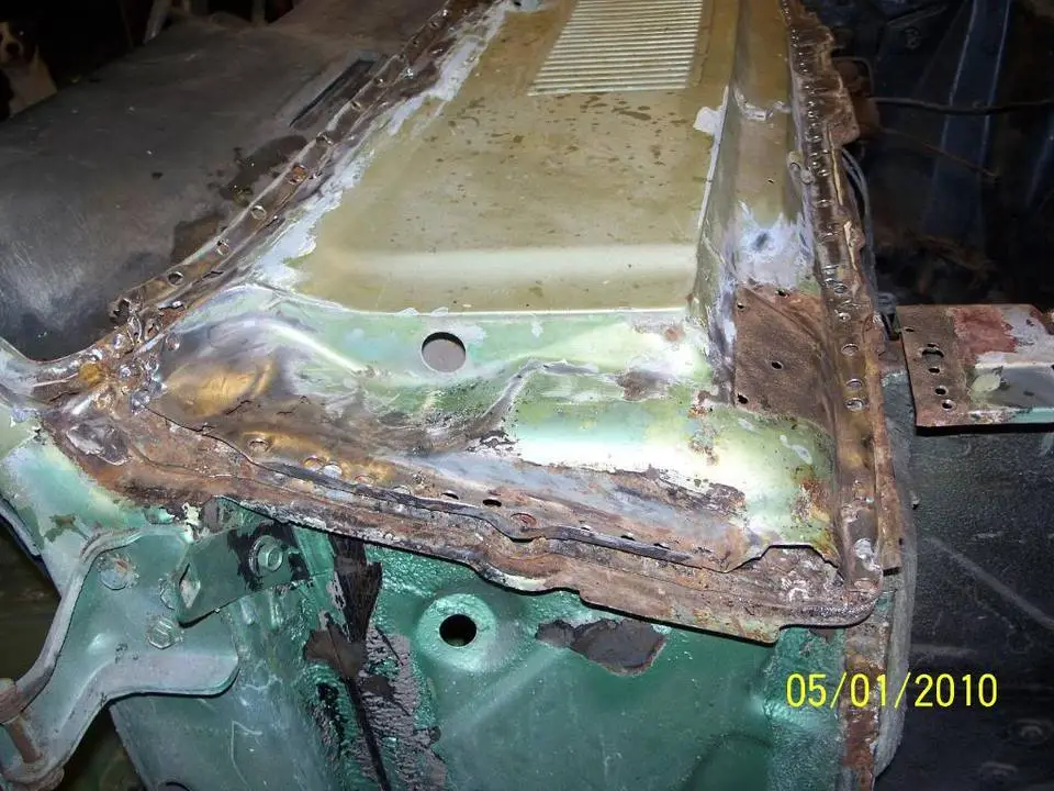

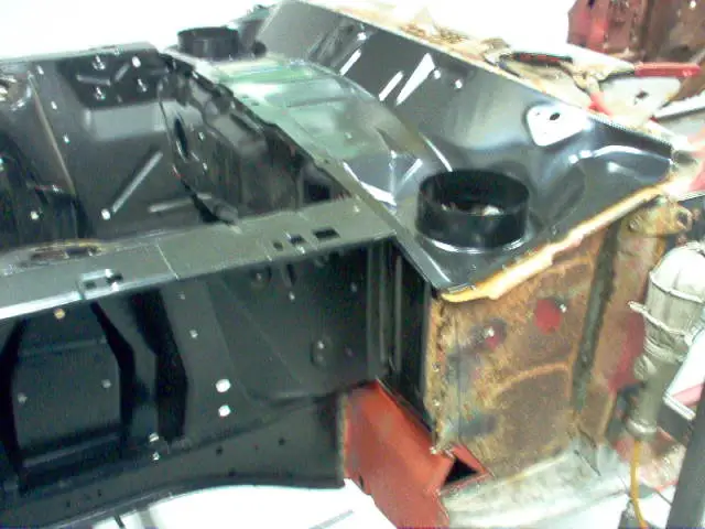

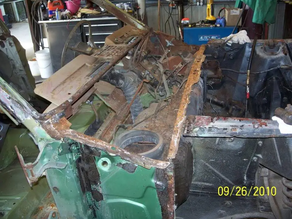

back to the cowl
side cowl removed
now that the side is removed i can get to the toe board that needs some patchs not replaced.

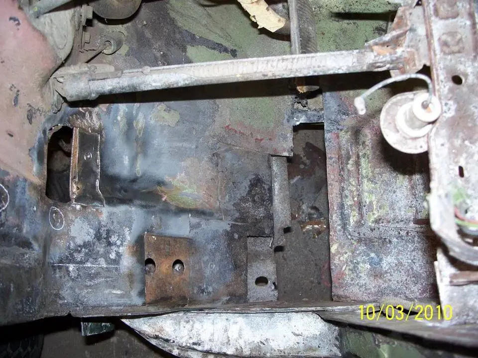

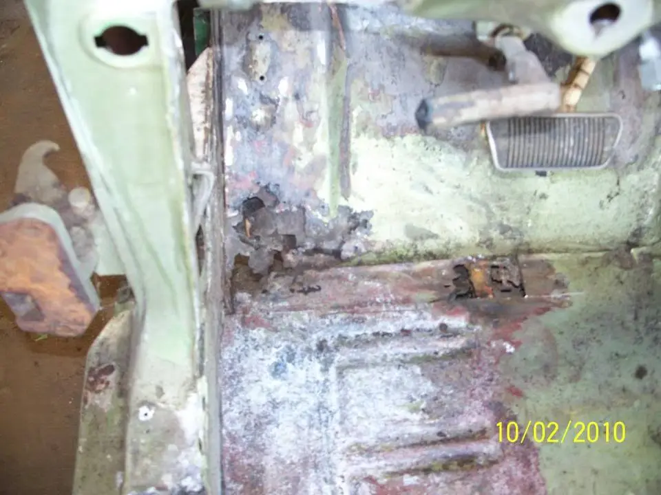

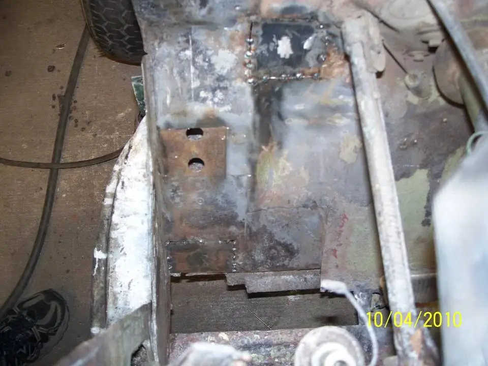

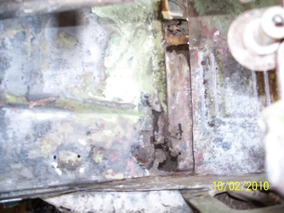

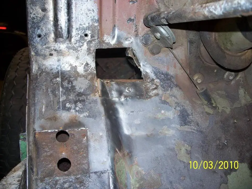

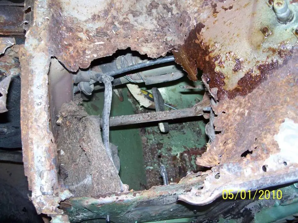

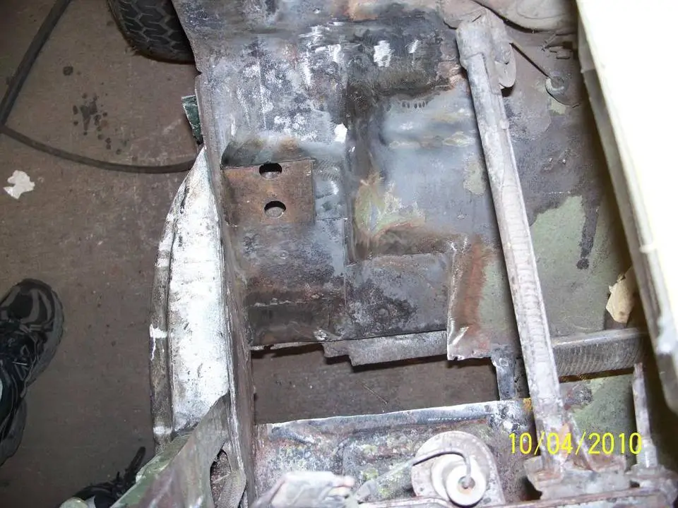

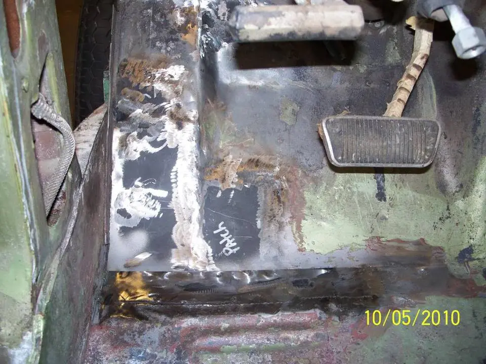

now for the toe board and small floorpan repair
all the bad spots are removed

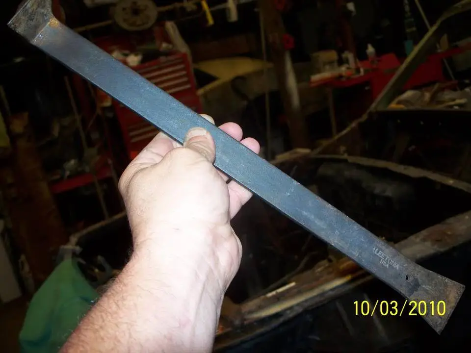

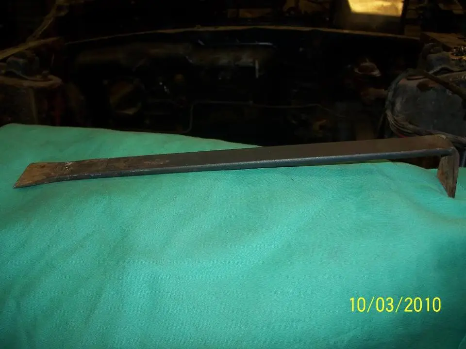

by the way here is a pic of the chisel im using its 15" long (i got it at work we call them dragline scrapers i dont know the name if anyone wants to know what they are i will ask purchasing) they work great and are long with a pry end. and they ARE SHARP on both ends VERY HARD steel.

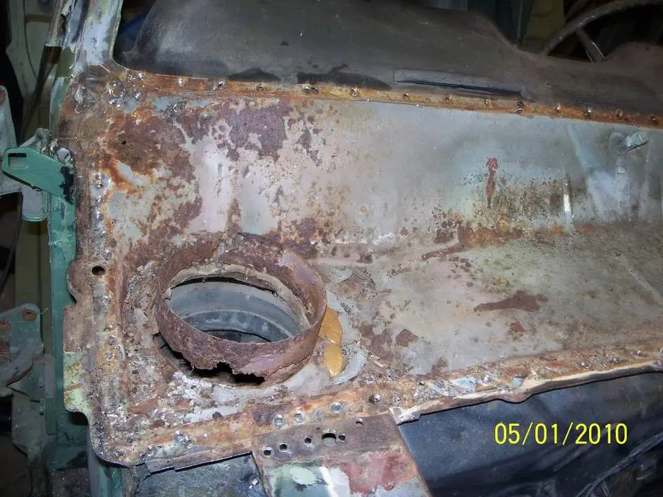

O i forgot to tell you that im using ospho on everything, that what the black and ask color is. thanx for looking if you have input. please give it and if you have a ? ill try to answer it the best i can.

internet searched leetonia tool from this
Leetonia Tool Company Catalog Page 11
double end scraper is the name of the tool.

That's a ton of rust in the cowl area. Looking forward to seeing the cowl come back together!

i hope to have the cowl back together in a couple of weeks after toe board and floorpan repair, rust treatment and paint all exposed areas.

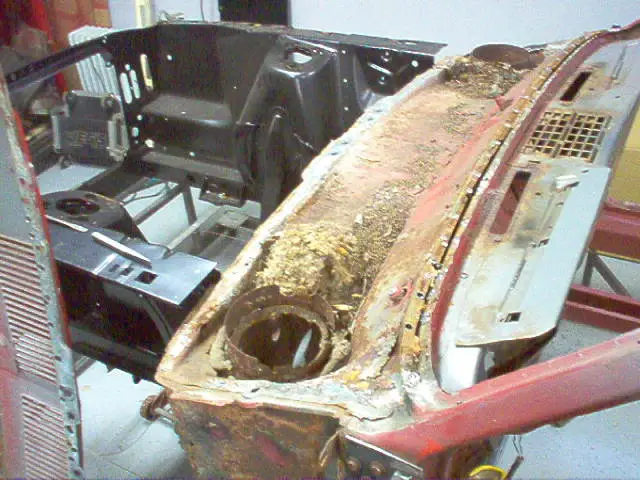

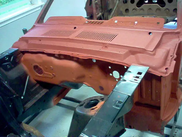

Look like you have some cool projects cars, I did the inner cowl as well and mine was in the same condition. The reproduction inner cowls fit great. Heres a couple pics.

free67conv
that looks great.

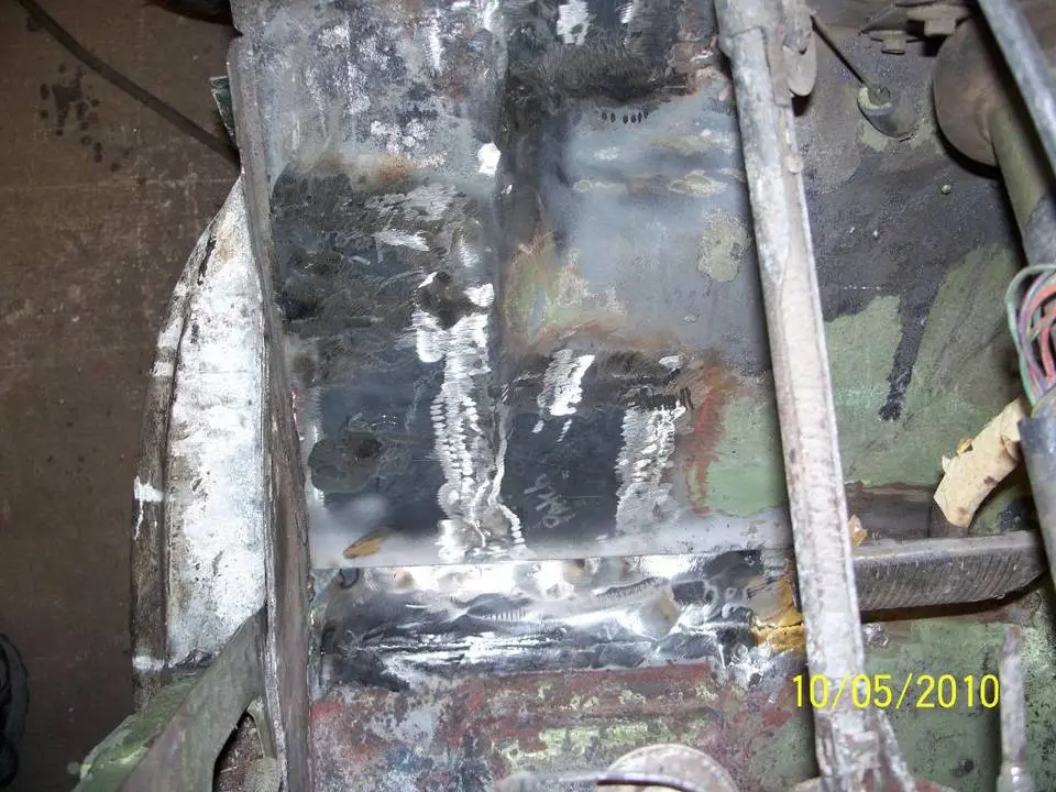

patched floorpans today
