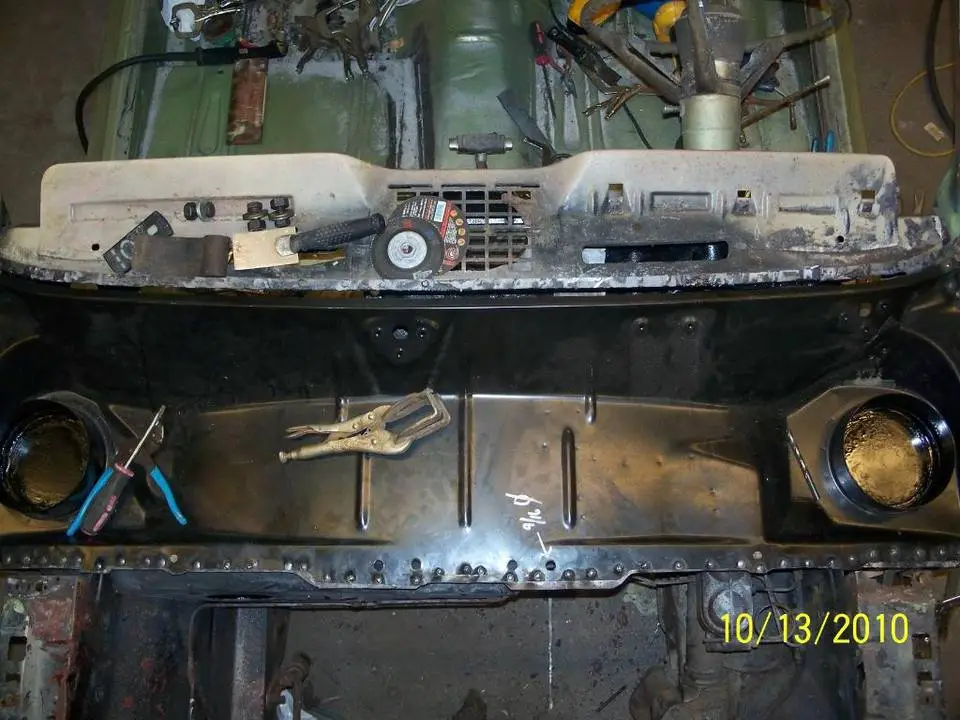

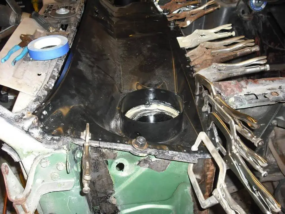

ok i was only able to work on the mustang about 4 hours this weekend. the cowl is ready to weld in.
painted toe board.

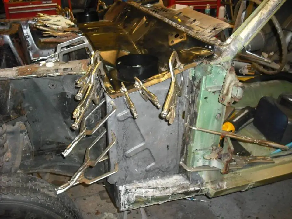

heres the side cowl fitted
i hope to weld it in tomorrow after work.

Now I remember why I have so many vise grips!
Bud, nice work, keep it going.

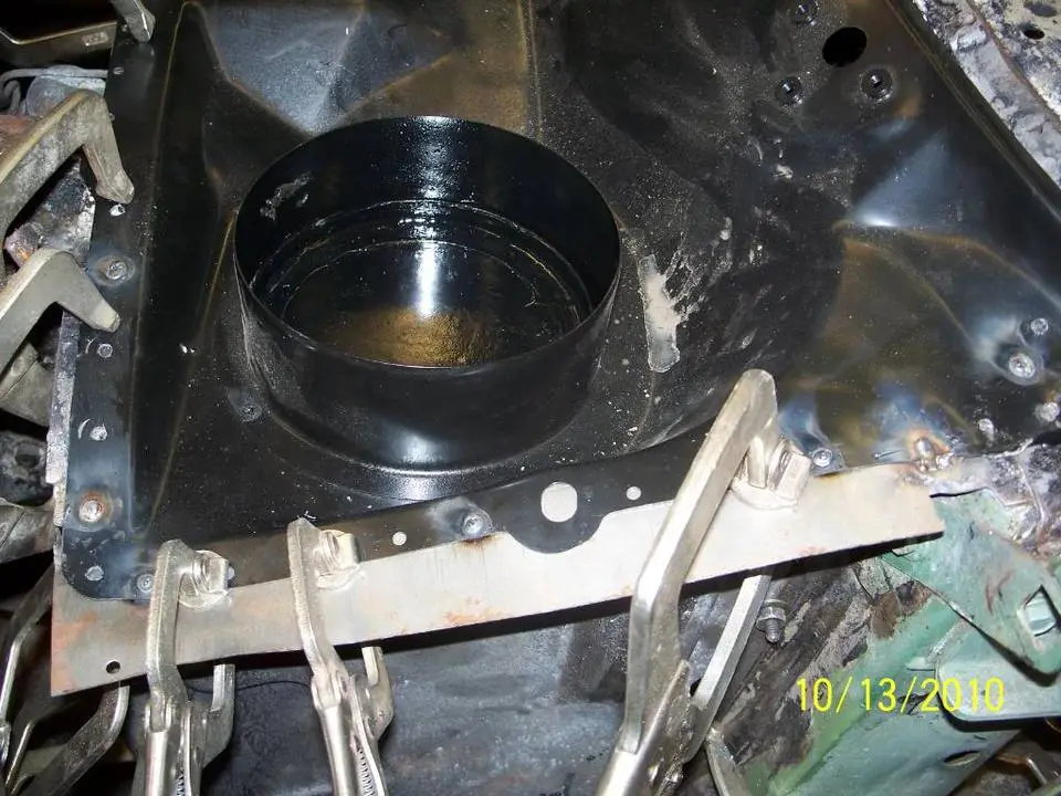

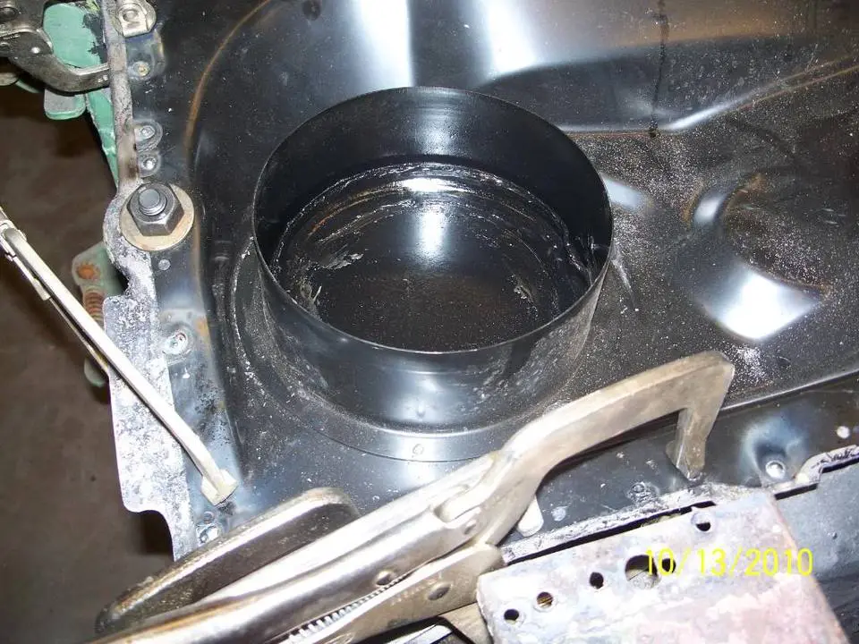

Oct 13, 2010
#23
  • Oct 13, 2010
  • #23

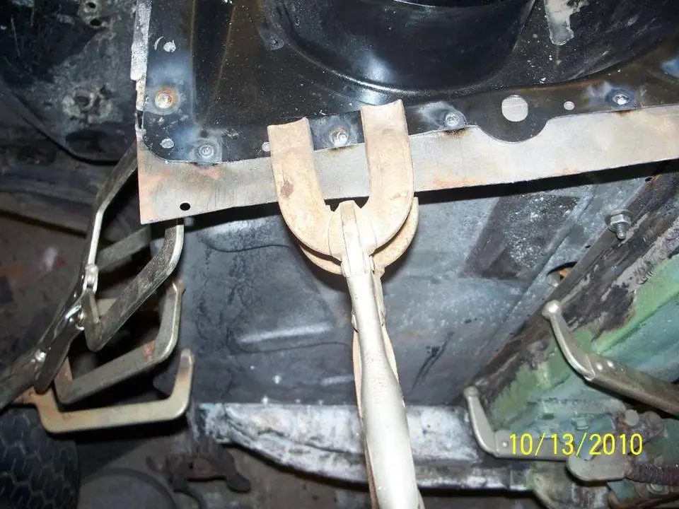

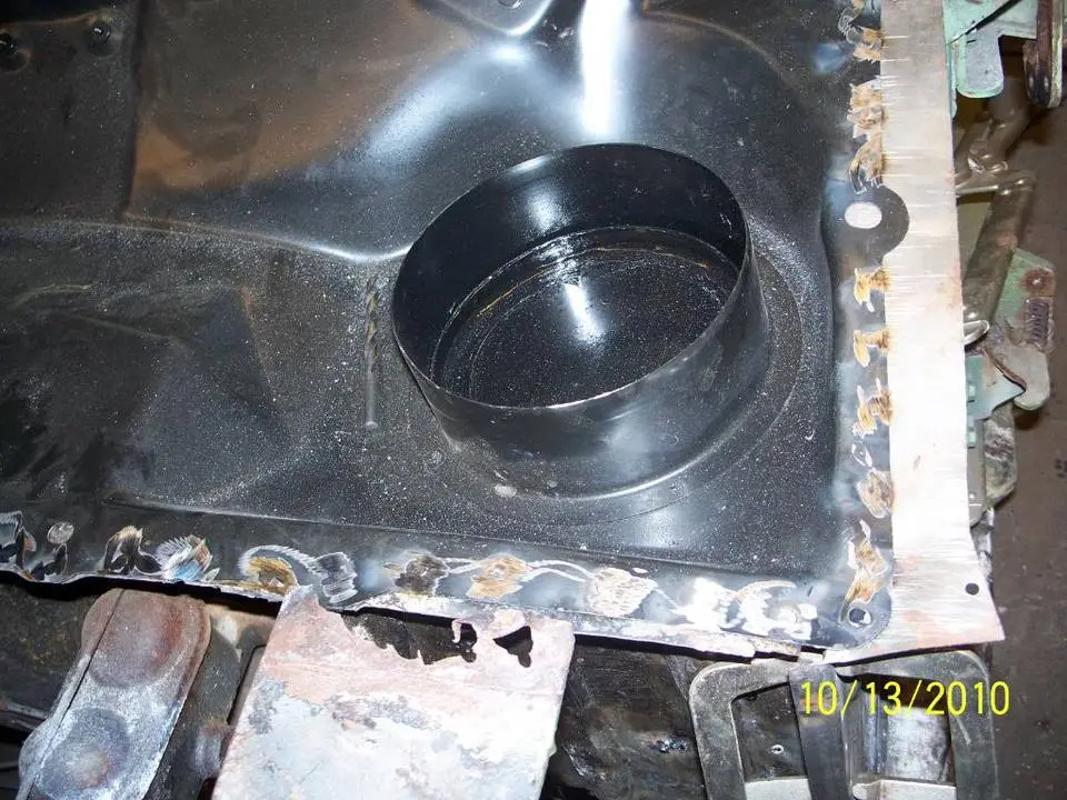

ok i didnt have to work over today so i welded the lower cowl panel, when welding panel jump around so you dont warp the panel.

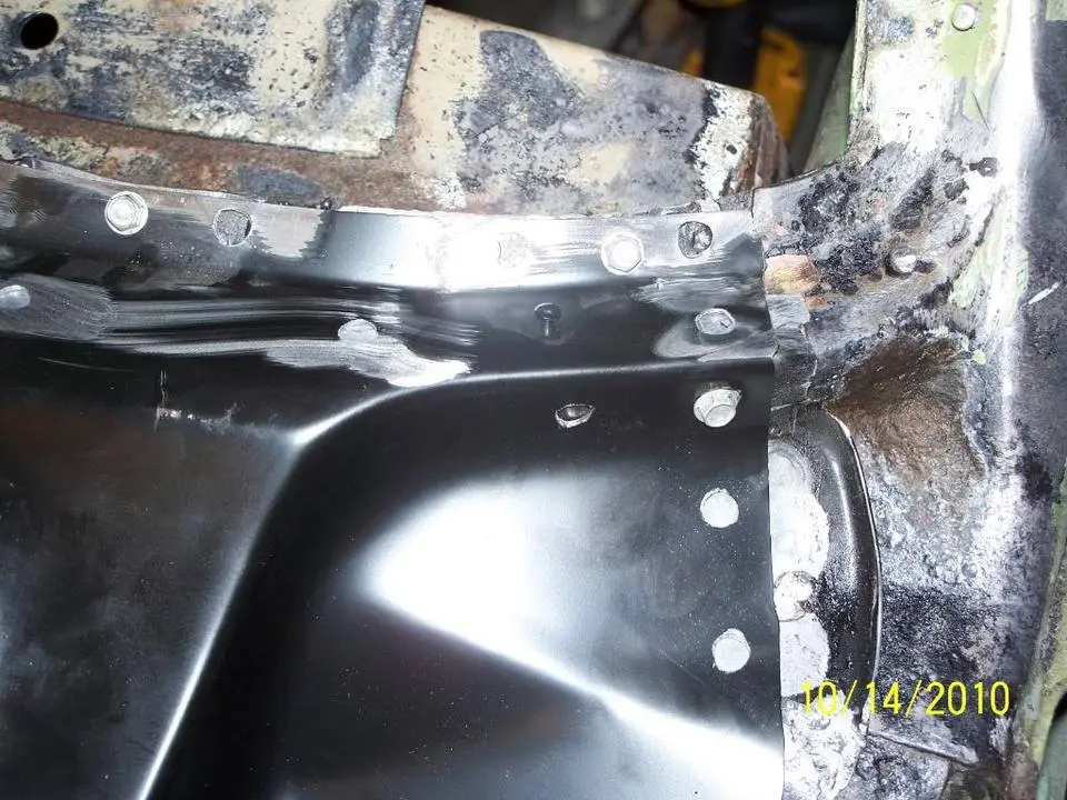

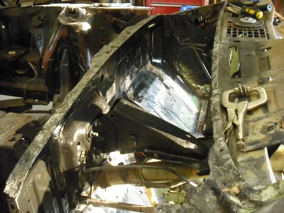

Oct 14, 2010
#26
  • Oct 14, 2010
  • #26

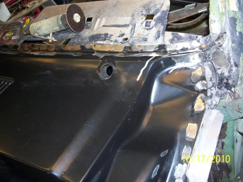

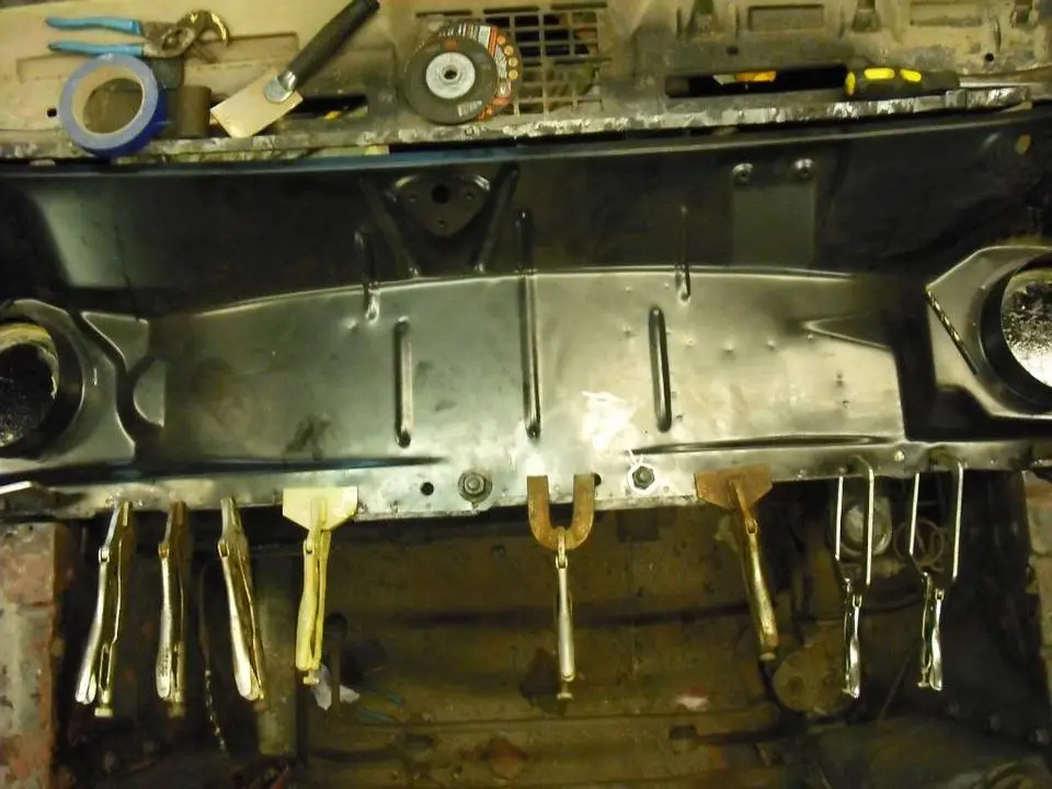

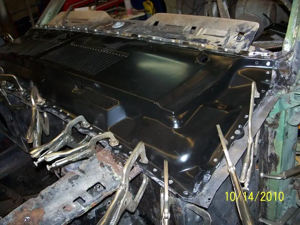

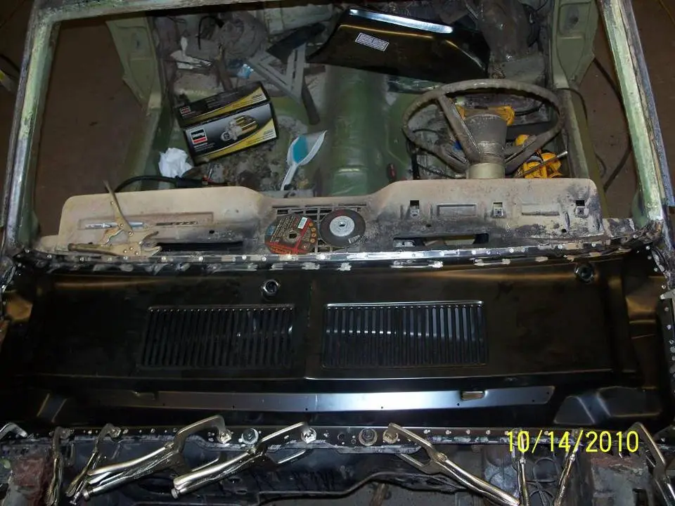

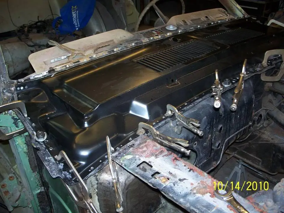

ok i drilled and fitted the upper cowl today hope to start welding soon, notice i used self tapping screws along the bottom of the windsheild cant get some vise grips in there.

rust preventative
Hey,
It all looks good! So what rut preventative measures did you take beneath that cowl? Also, when I did mine, I finished painted the area beneath the grill opening, as to create a more finished appearance. You are definitely, in control. Nice work!
G
gr8one
Jun 28, 2008
52
Ft. Meade Polk Co FL
Oct 14, 2010
#28
  • Oct 14, 2010
  • #28
ospho and paint.

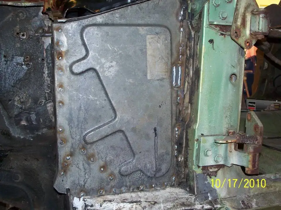

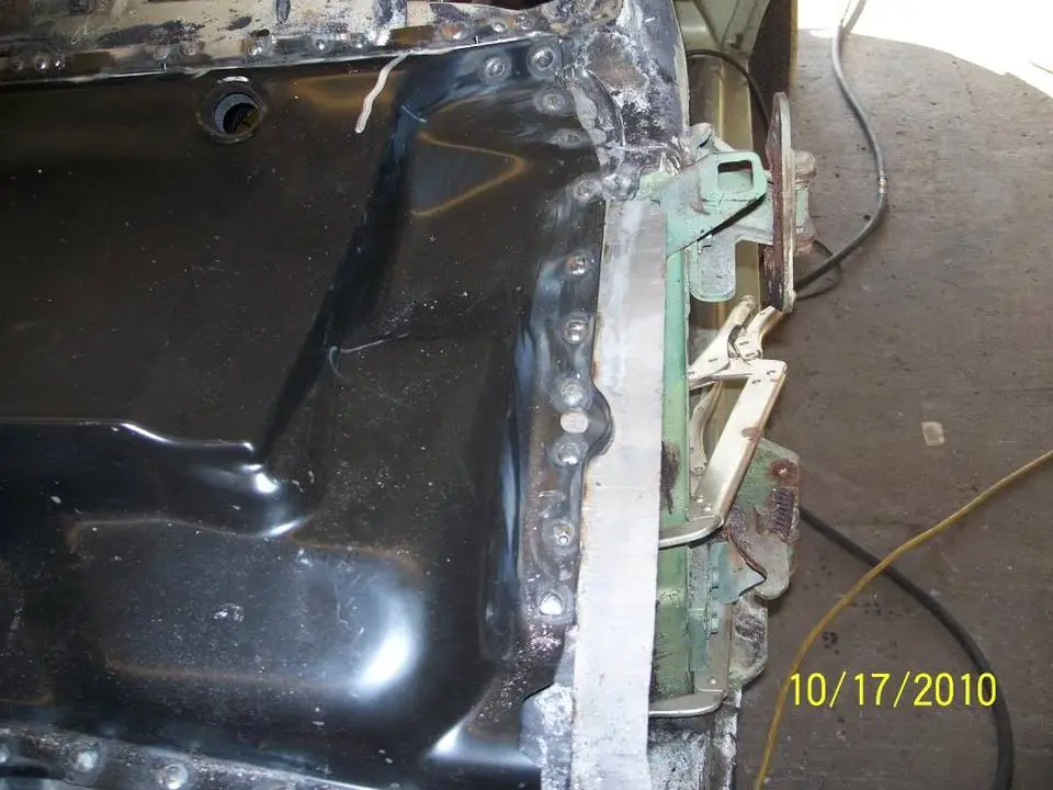

Oct 17, 2010
#32
  • Oct 17, 2010
  • #32

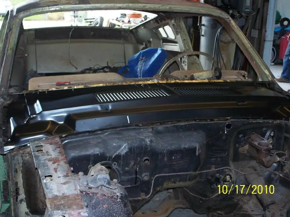

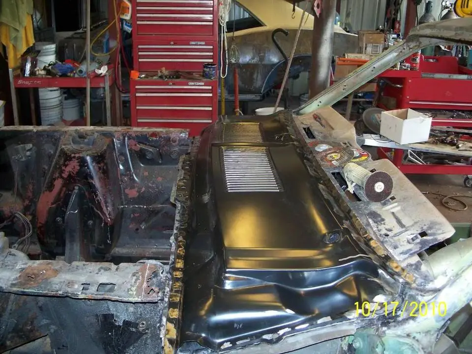

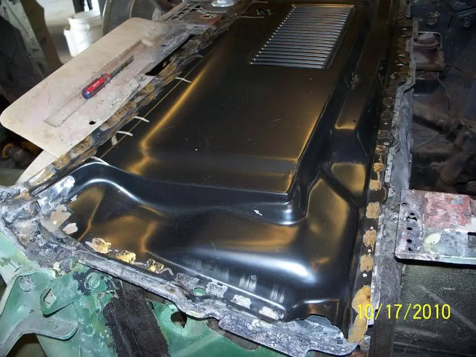

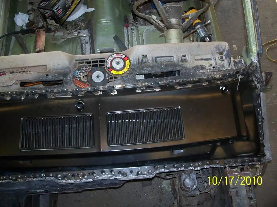

welded side cowl and upper cowl.
