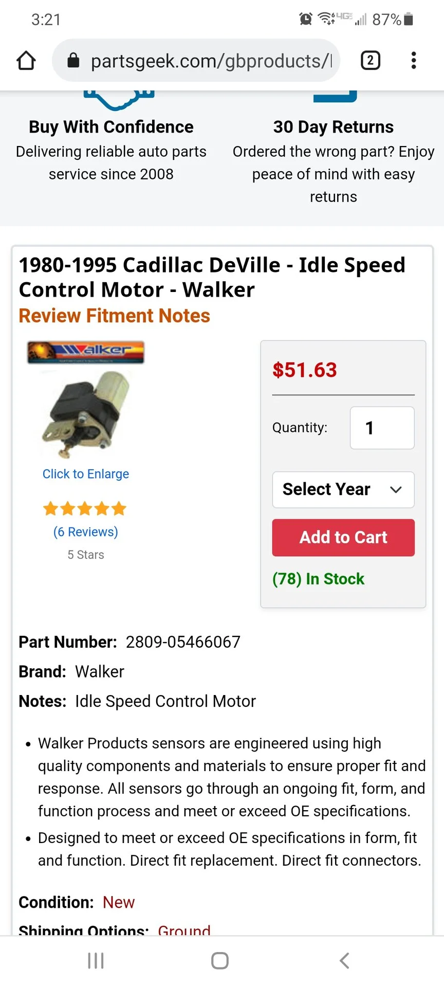

I used to take the stepper motors off of mid 80s cadillacs in the JY. They worked well to increase rpm. They are easy to fab to work. I'd use a relay triggered by the the low pressure switch.
