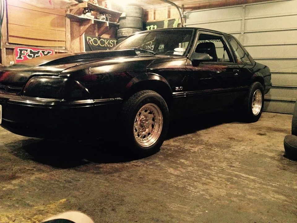

Here is my set up its a 1989 lx coupe. i need to know if i have to bump up to 24lb injectors im currently running stock 19lbs? The closest dyno is 8 hours away.

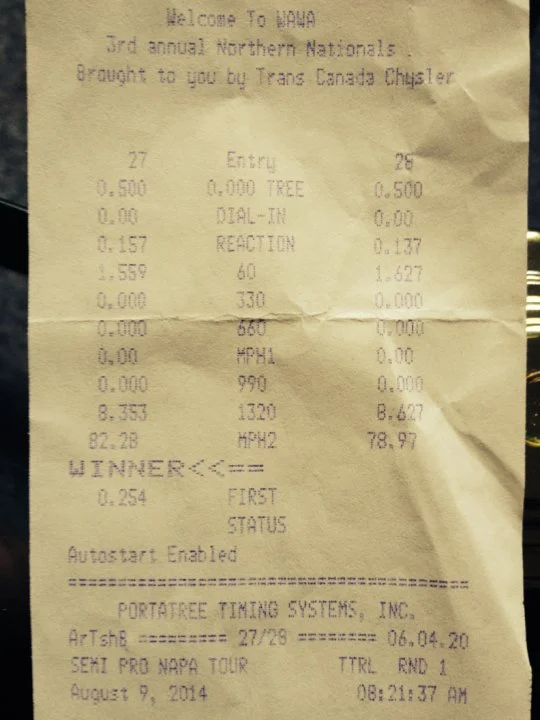

Is everyone else missing the GT40X heads? He was running 82mph BEFORE the heads and intake. That's showing some decent power. I think you should upgrade the injectors, and I would base the upgrade on planned mods so you can grow into them. 24lbs would work well if you'll stay N/A.
