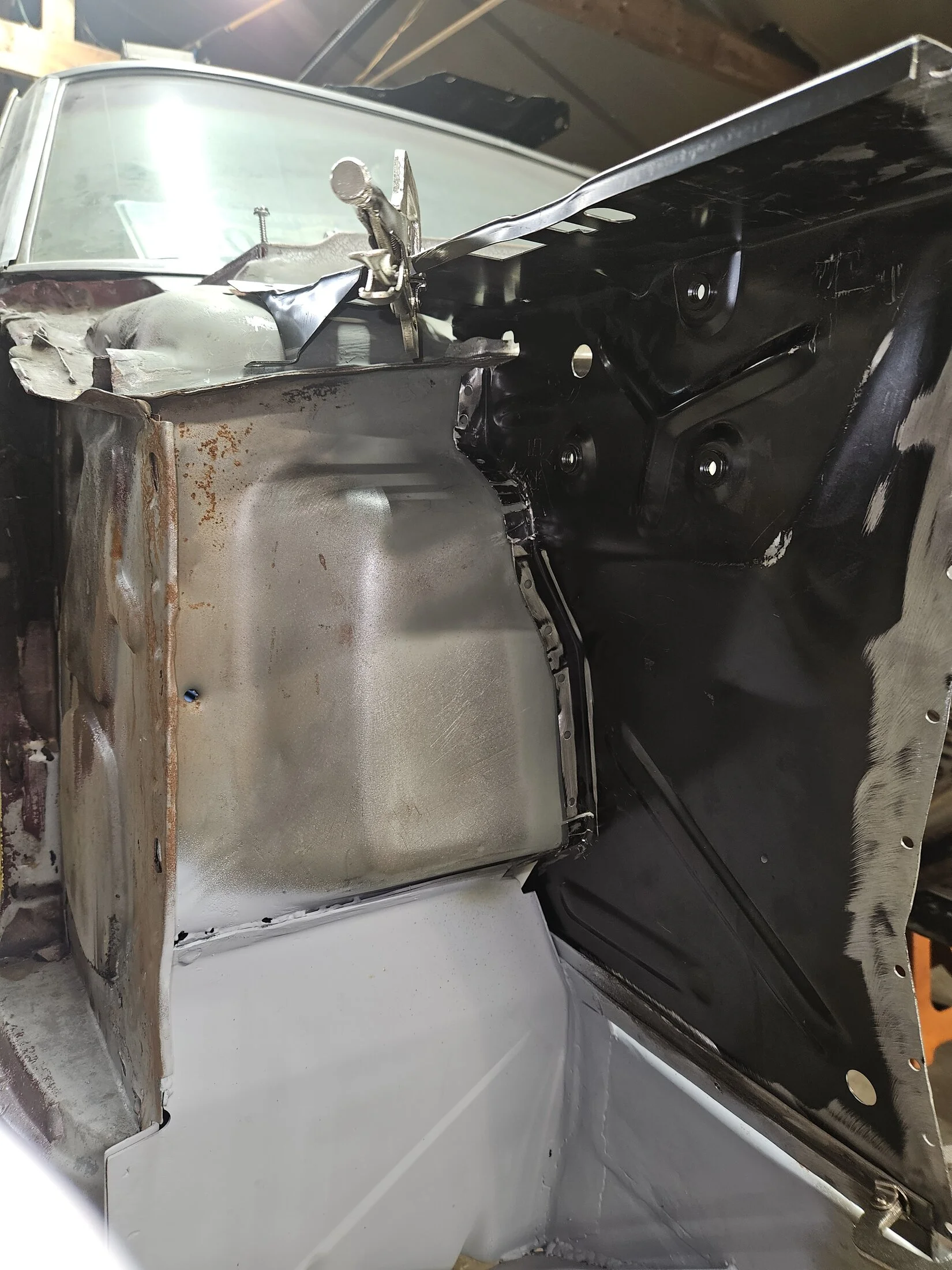

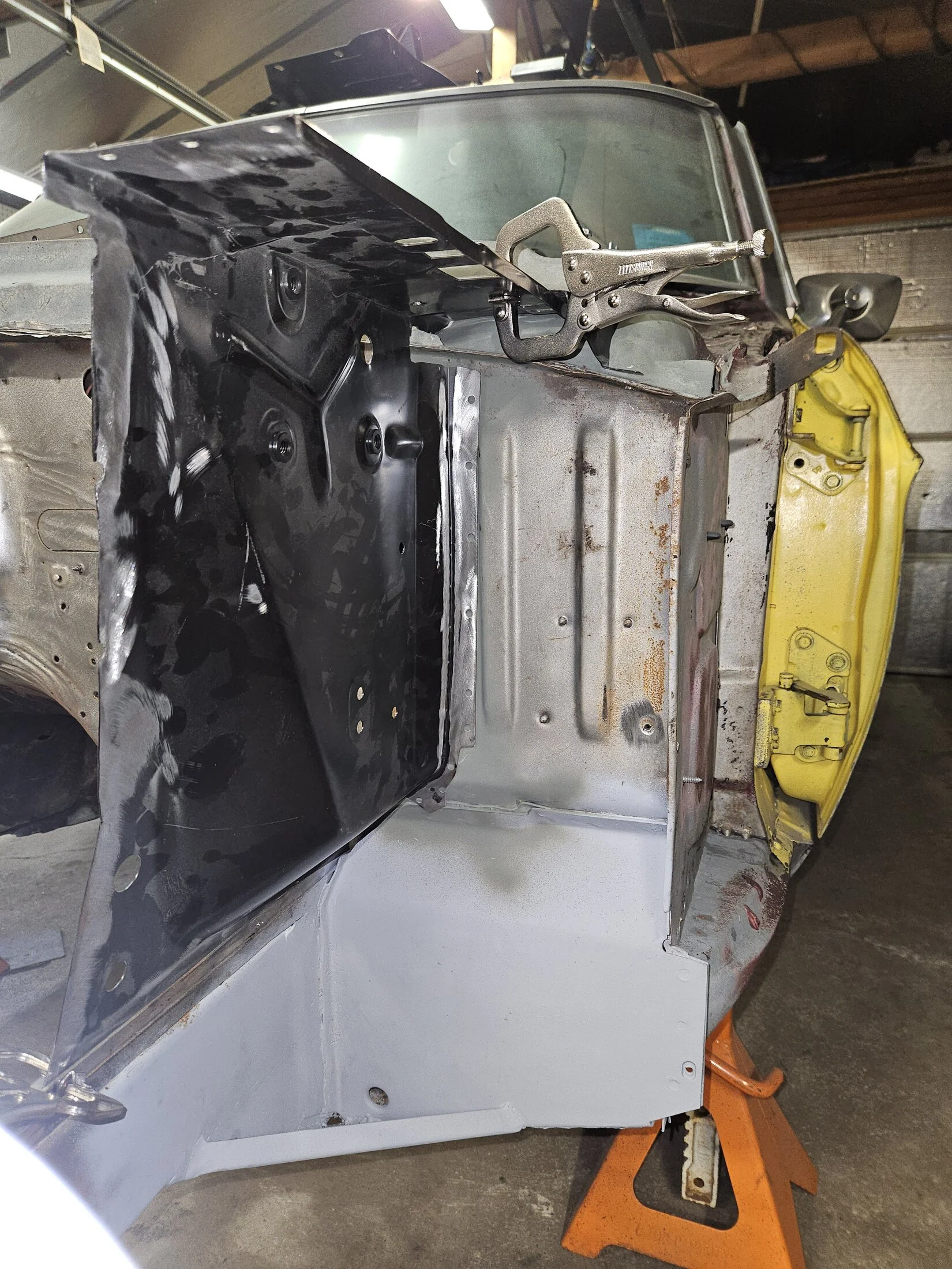

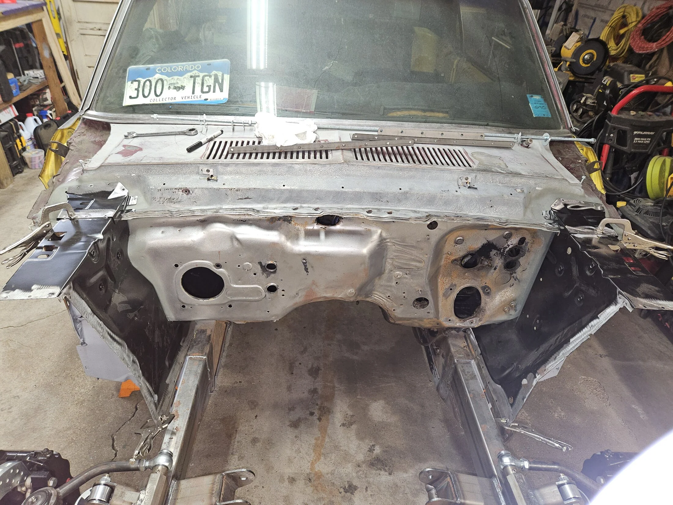

I'm looking for the measurements for the inner aprons that weld to the firewall! I need the distance between the aprons on the inside,and the distance from the edge of the firewall to the outside of the apron for both sides! And the distance from the frame to the top of the aprons! Please help! Thanks in advance!

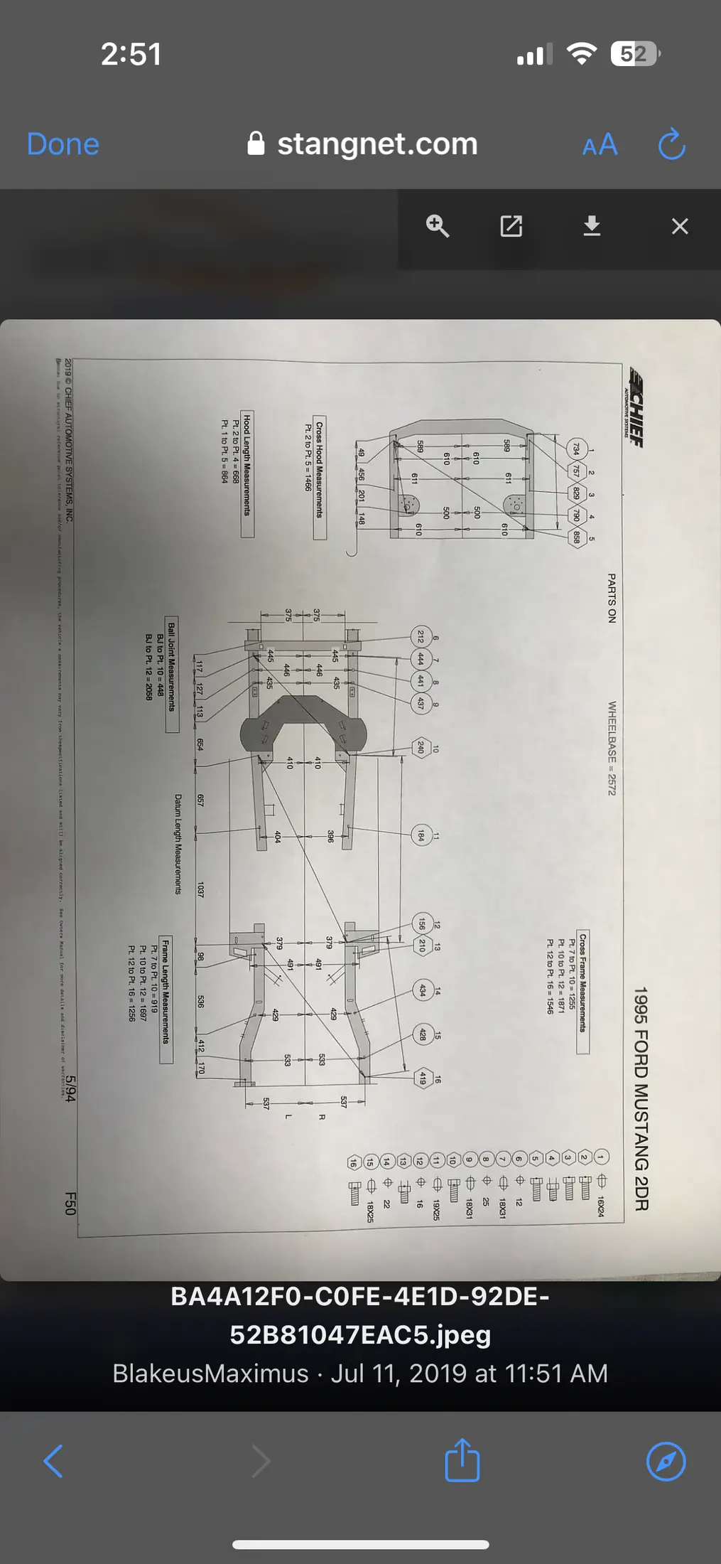

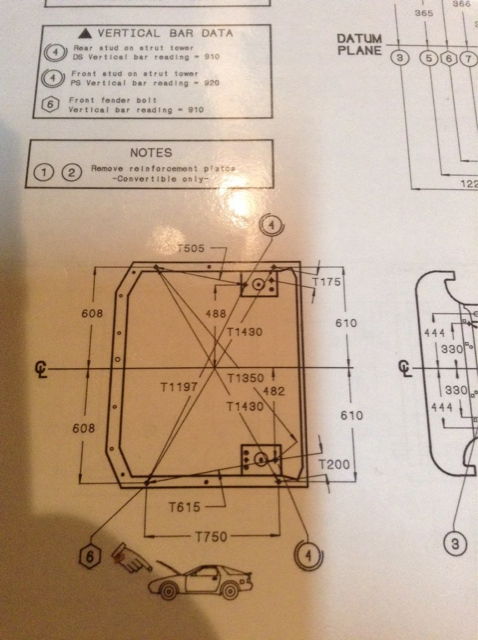

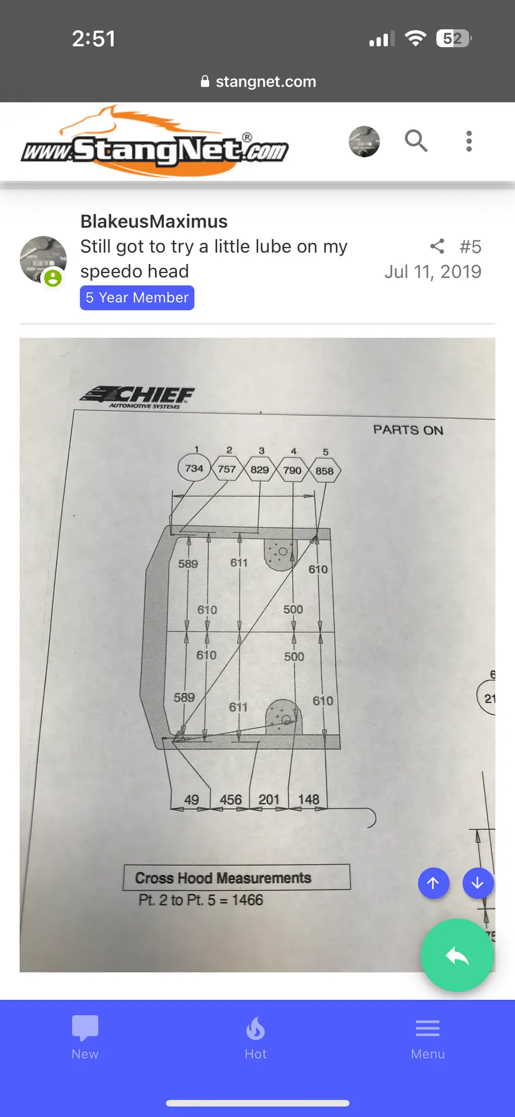

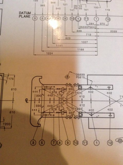

Pulled these off of FourEyedPride a few years back:
1979-1987 Mustang
1990 Mustang
1993 Mustang
From what I understand there is a different in the shock towers starting in 1990 that can cause some slight fitment issues but nothing horrible. 90 and up shock towers were supposed to have more camber in them which makes sense as Maximum Motorsports offers a different caster/camber kit for these models.
Mind if I steal those? Ha ha ha!!! Man they are much easier to read than the ones I have. Just to clarify (I have heard this and want to say I have even read it here) that the 1995 chassis is still a Fox chassis dimensionally, correct?
I think they are. As far as stealing them @AeroCoupe, they are in the stickies. I posted these 4-5
years ago and one of the moderators stuck them in there. I don’t have the specs for pre 94 cars.
