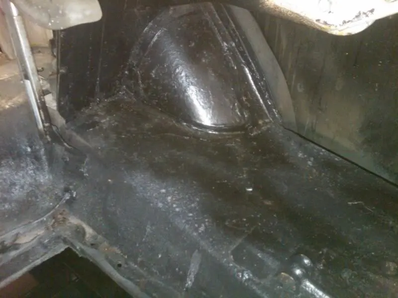

Heres a pic
Where trunk floor meets wheelhouse, a previous owner had hidden this under some fiberglass.

I was gonna cut the rust out and fab a replaement panel until I found bondo in the fenderwell and saw how bad it really was, fyi, theres already a little bondo in the wheel flare openings, making me wonder if full quarter replacement may be best way to go.

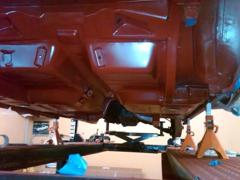

Thats how my project started, this is what it looked like until I started to remove goo..not bad
, but the wheelhouse was bad on both ends, and the drivers side was just to far gone and the rust had eaten enough of the transition panel to talk me into replacing it.
Then I ended up with a six month project that involved everything from the rear trunk brace to the toe boards, I'm just lucky I had no frame rust I guess. EDIT: I just remembered that my rear frame rail to leaf spring area was shot and I had to replace that...
Looks good, you did a great job.

Just keep in mind that using an aftermarket panel doesn't mean you have to replace the entire panel. If the rust is limited to the bottom of the wheel house, you can section out the bad metal, cut the replacement panel to fit the gap and weld that in. If you do a good job of fitting, welding and grinding it down, you won't be able to see a seam afterwards.
Once you get into the quarter panel, the might-as-wells could cost you more and more. You could use a magnet to figure out how much bondo is there.
I would also add that the repop wheelhouse parts are not exactly like the 65 cars, they dont make them without the spare tire dimple and the other stamped ribs are not the same either, so matching is a bear.
