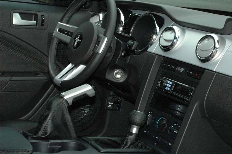

After waiting and waiting for Ford to come up with a way to input my ipod into my Shaker 500, I decided to buy a new head unit. My Alpine 9857 has controls for the ipod, will accept a satellite tuner (either service) and sounds great. It cost me a little over $500 to get it installed including the Sirius tuner and the ipod cable. I thought about buying a aux cable but it was going to cost $150 or more installed and I still had to use the ipod controls. I could have used the Alpine 9856 and had the same controls for about $150 less but the display on the 9857 is much better.
The unit sounds so much better than the Shaker 500 it is not funny. And the ipod is awesome through the unit with controls at my fingertips on the dash.
So far I haven't touched the speakers. There's an Alpine head unit for just over $200 that will control ipods. And the ipod cable is only $29. It works great. Makes all the other ways to connect ipods outdated in my opinion.
The sound system sounds much better with the new head unit, even with the factory speakers. I only have a 1 cd player but with easy access to my ipod which will hold 5,000 songs and satellite radio, I don't think I will miss the changer. If I do, I can add an Alpine 6 disc changer for $299. The head unit and the changer all play mps and wave files. I've very pleased with the change.

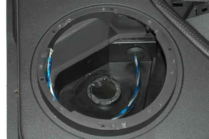

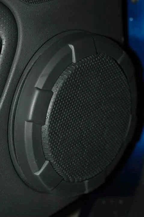

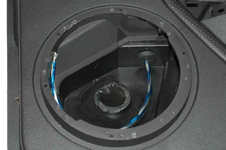

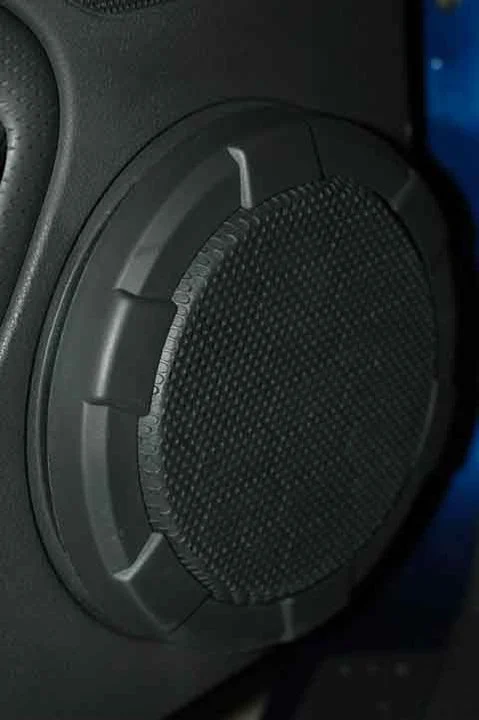

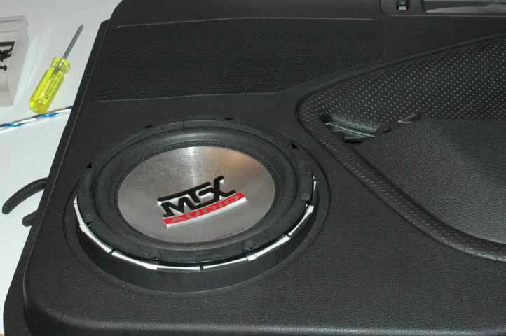

Install wasn't too bad. The 4500 aren't too much bigger than stock, but the sound was a big improvement. Here's what I had to do...
  • Heat gun to gain about 1/2" of clearance.
  • Different hole pattern, so I added some 3M 2x tape in addition to the screws.
  • Dremel tweaks to the stock grill to fit speaker.
  • Foam baffle on the MTX speaker pushed the cover out about an 1/8" from stock, and exposed the 3m tape when looking from the side so I covered it with black electrical tape (no one has ever noticed)

So, you had to use the heat gun to create enough side-to-side space for the magnet? Did the depth work fine? I'm making a database, that's why I am asking a ****load of questions about this one.
Side-to-side was good. I only had to use the heat gun on the center part where the stock sub bolts to the panel.
