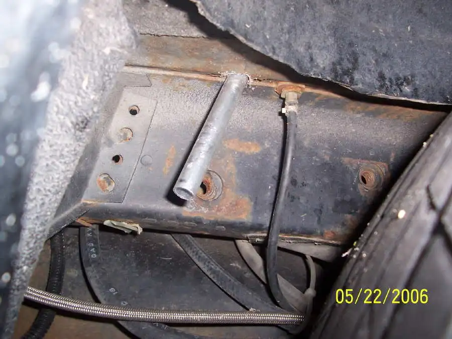

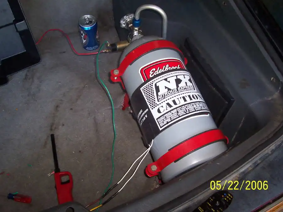

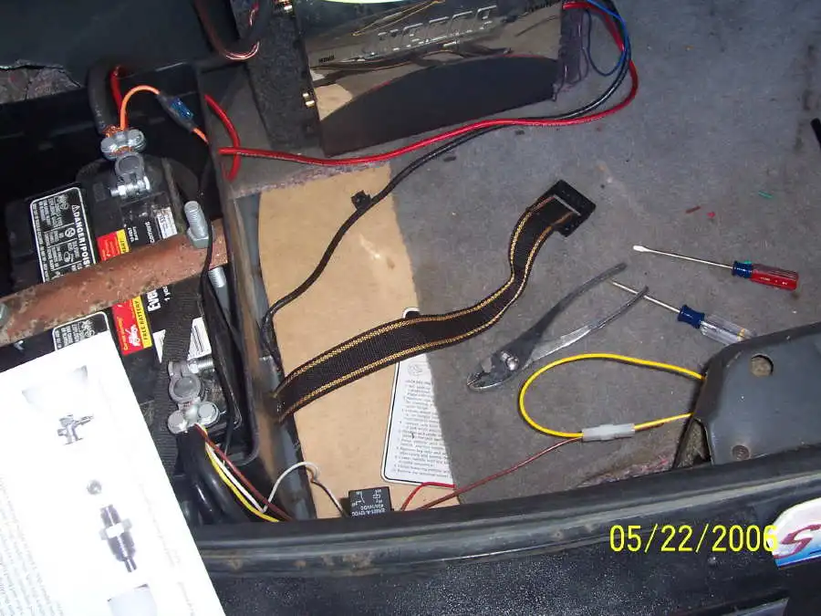

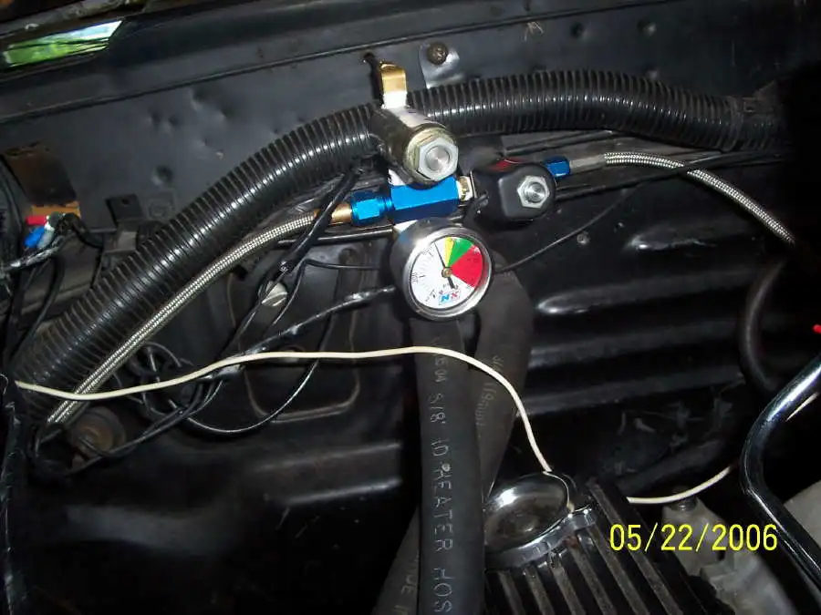

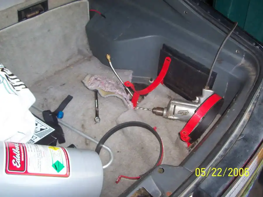

ive had the stuff sittin in my garage since last year, finally decided to put it on.

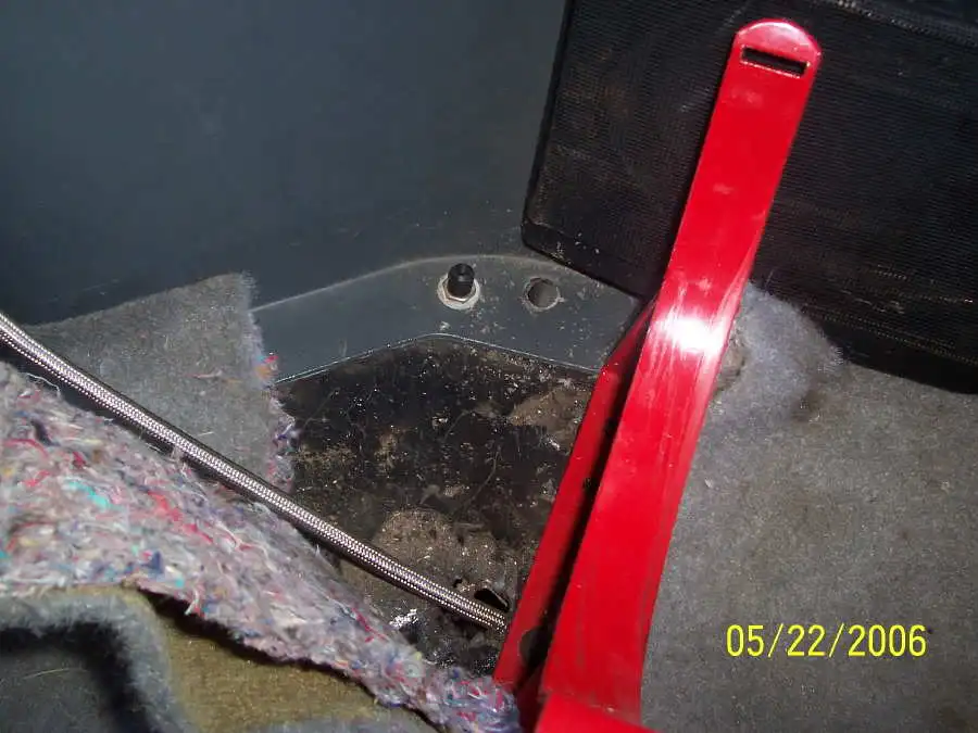

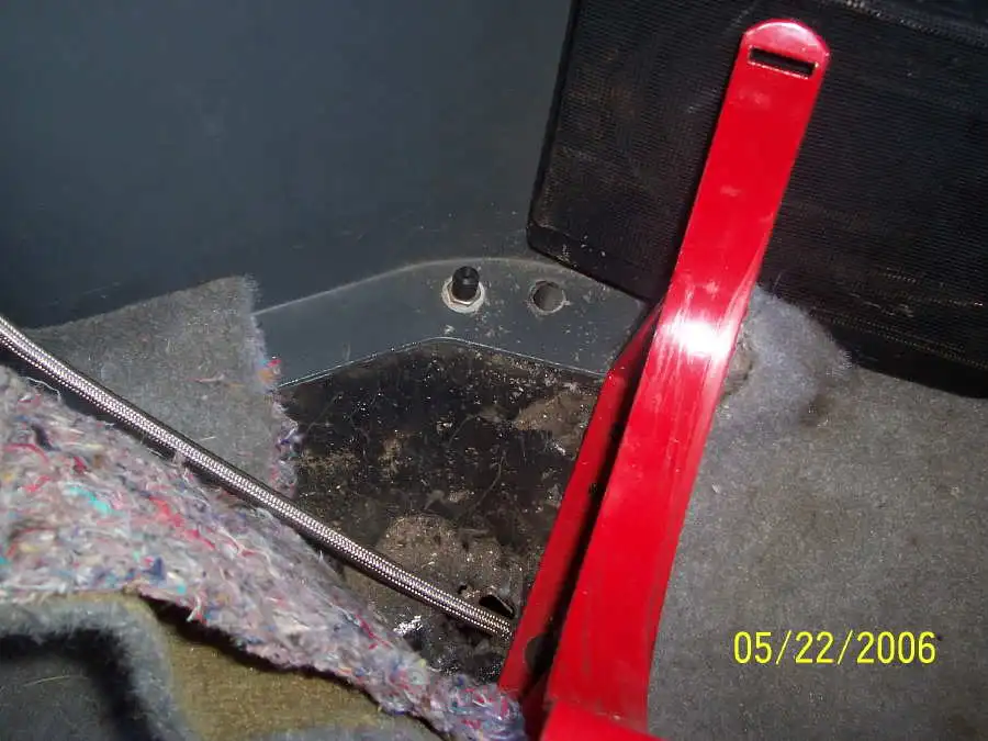

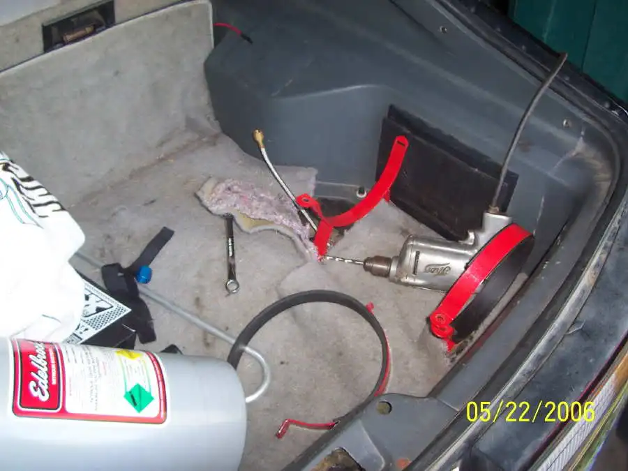

finding a place for the hole.
the hole

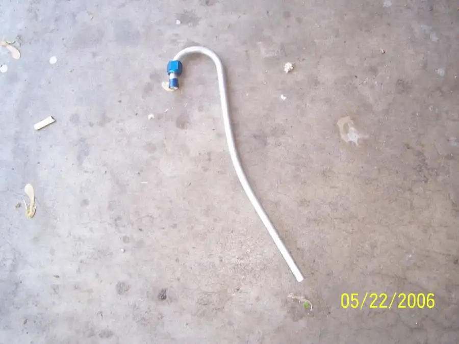

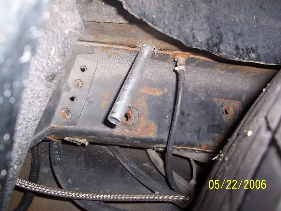

bent to fit blow down tube
blow down tube exit

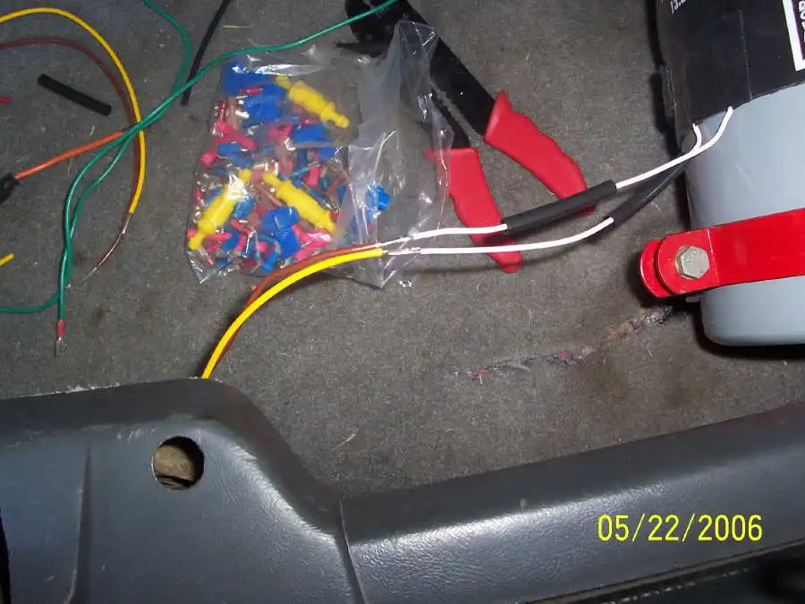

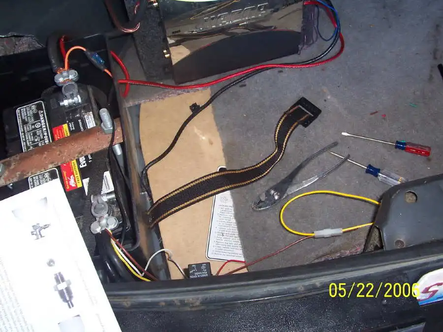

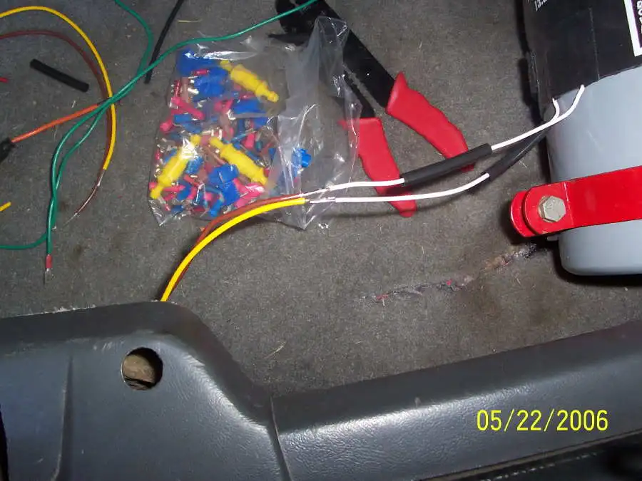

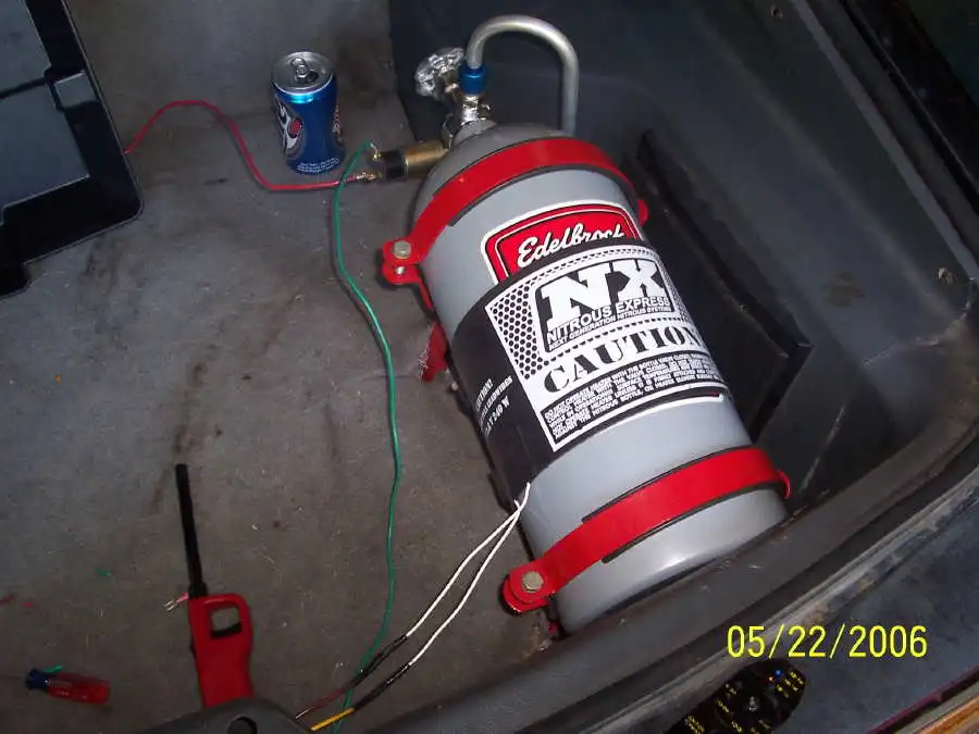

soldering connections

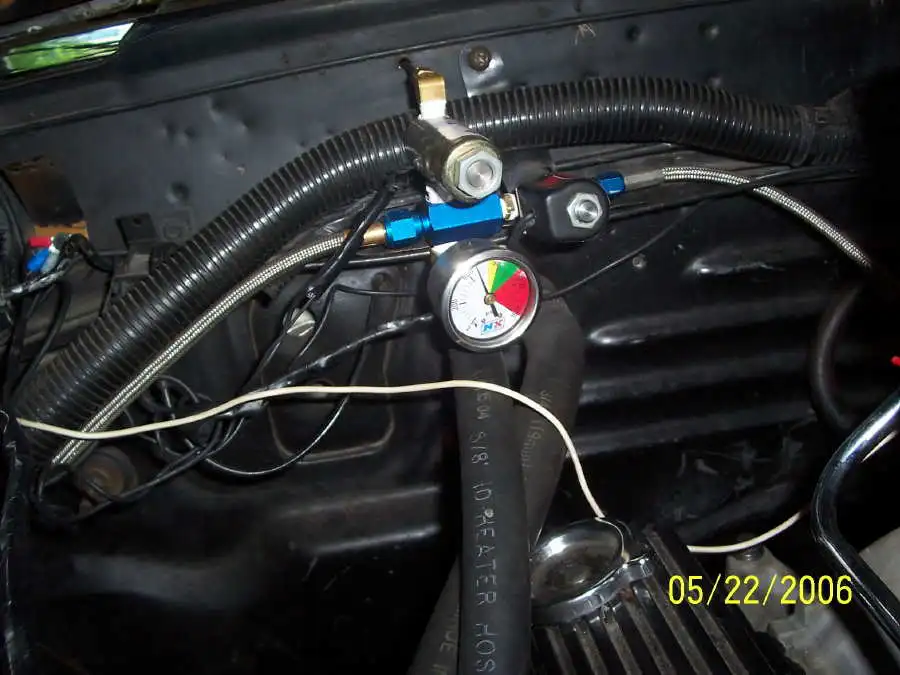

i put a quick disconnect for easy refilling and a fuse for safety

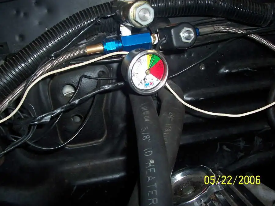

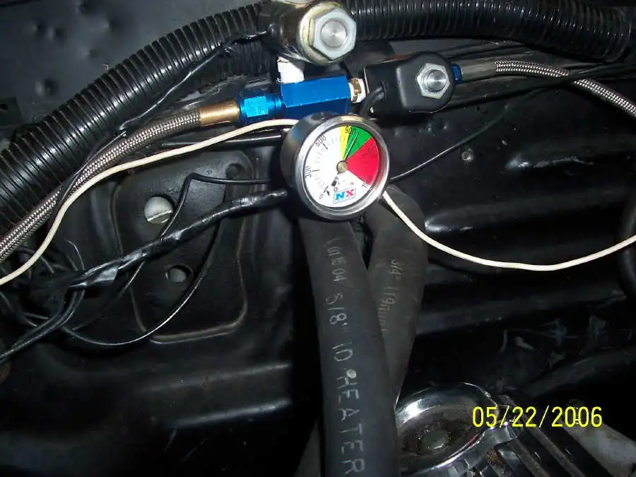

pressure at about 700 PSI
after the bottle heater was on for 20 minutes about 950 PSI
