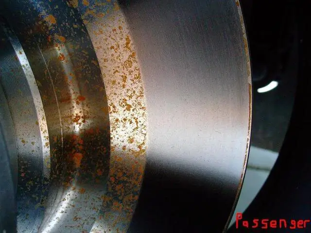

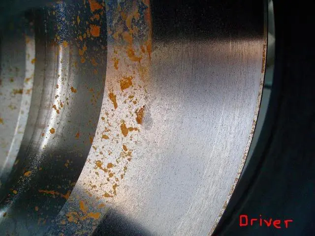

i installed bullitt front brakes on my car yesterday and i have a problem. whenever i'm going 40mph and apply the brakes i get this pulsating feeling in the brake pedal. it doesn't pulse as fast as the abs kicking in, it seems to go with the rotation of the wheels. i can't feel it in the steering wheel but i can hear the noise. it sounds like a thumping sound. i'm pretty sure i lubed all the contact points good.
i went outside a few minutes ago to check the rotors and i noticed that the drivers side pads weren't contacting the rotor as much as the passenger side. what could cause this? is this where my thumping sound is coming from?

looking at the pics side by side, it looks like the drivers pads aren't even applying at all. maybe siezed caliper? i got the brakes from a wrecked bullitt. hopefully this wasn't the reason they wrecked

It's possible. You could try placing a block of wood in the caliper and pressing the pedal to force the pistons out (but not too far). Perhaps one is seized.

Depends. If you can get the piston(s) out, then anything can be rebuilt. But if it is rusted in solidly, you might find it impossible to extract the thing. Best bet is the block of wood, with motor cranked to get the hydro-boost kicking in and see if you can develop enough pressure to push the caliper out. Once out you can remove any rust easy enough...
BTW 99% of the time, pedal pulsation is a direct result of a warped rotor...
