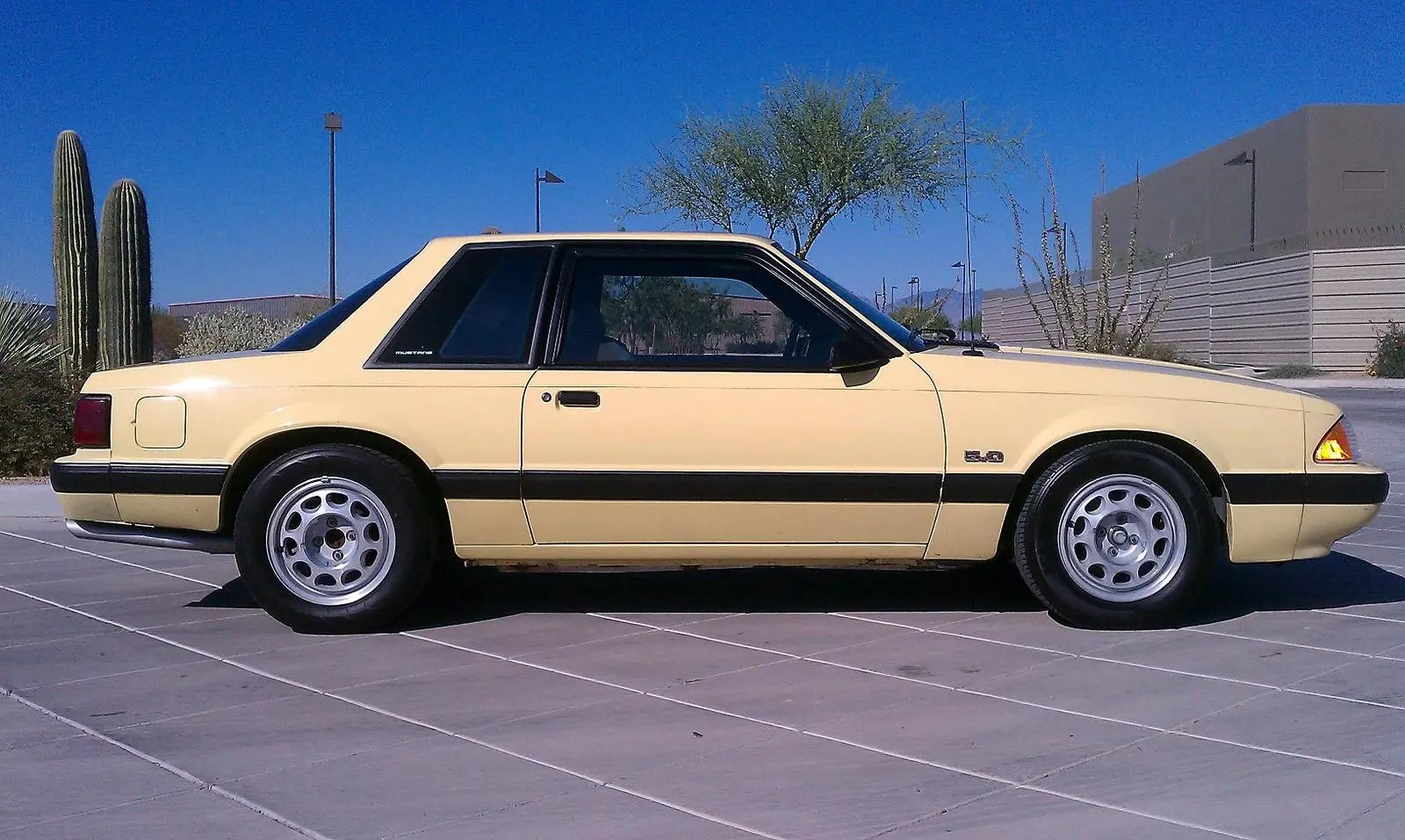

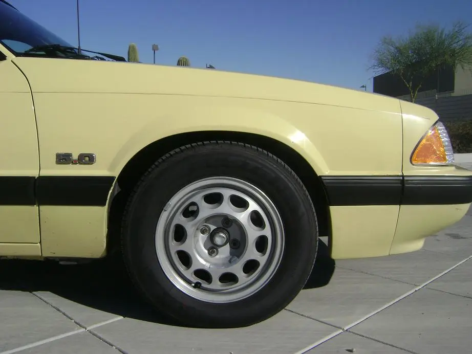

Fender height now with Mach 1 springs, stock rims and tire size, 3 core radiator and AOD trans
Front 26"
Rear 26.5"
