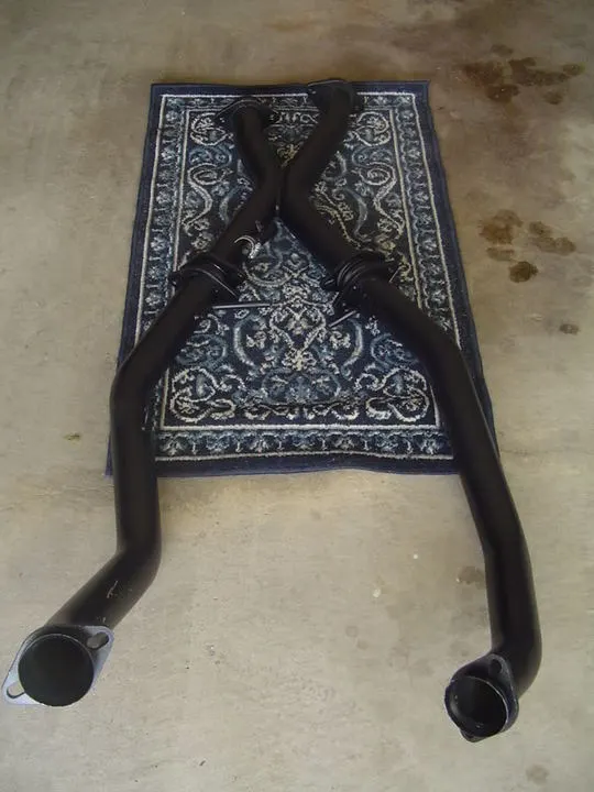

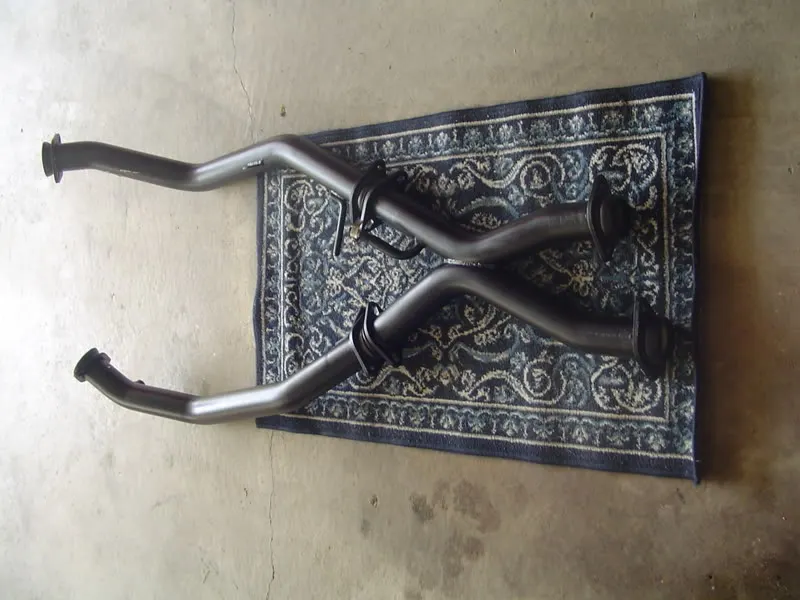

heres some pics of it before i installed it and i'll post some later on the car.
