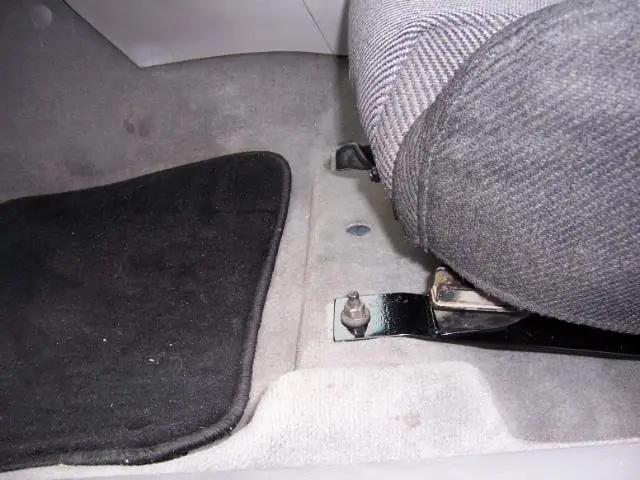

Installed seat track extensions and a manual seat track today
I installed the seat track extension I got from LRS and a manual seat track from the pick and pull today.
I got a gift certificate from LRS for Xmas and paid $10.00 for the manual track at the pick and pull.
The gear on my power seat track was completely stripped so even though I had power it wouldn't move back and forth.
I am 6'4" with a 36" inseam so the extender made a big difference. I finally fit in the car. I highly recomend the extenders for tall guys.

Cool, I'm glad you posted this - I'm 6'5" with a 36" inseam so I know what you're up against. I might be interested in a set of these. I used a Fox manual track & rail which is supposed to sit a little lower and a little further back than the SN95 power seat track but it's not a lot, maybe 1/2" vertically and an 1" horizontally - it's enough that my wife complains she can't reach the pedals anymore.
How's the overall driving position and ergonomics now, especially the shifter? The problem I have now is that if I could move my seat back further, I don't think I'd comfortably be able to reach the shifter. My arms and definitely legs could probably use a little more room but with the stock shifter 1-3-5 would be too far away, and now with the Pro 5.0 shifter the whole damn thing would be too far away - I may try to grab an MGW handle for it though.

These are the seat track extensions I got. Mustang 79-04 Seat Track Extensions at LRS - Same Day Shipping!
They give 3'" more legroom and raise the seat 1/2" higher than stock.

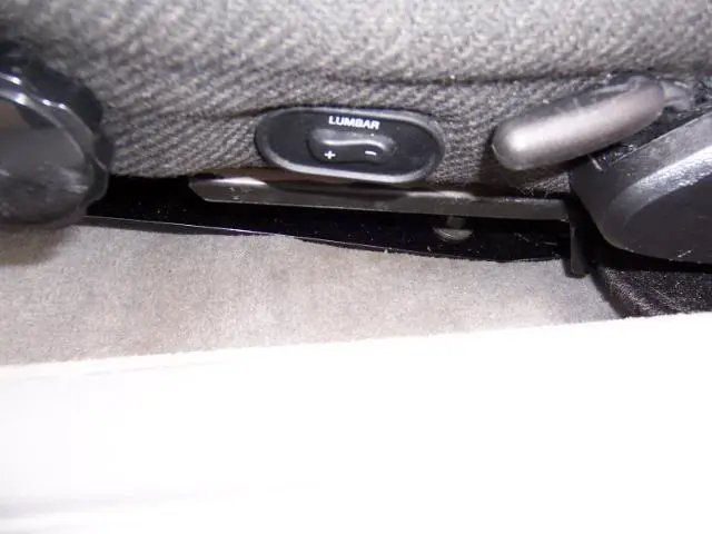

I kept the power lumbar function and just got rid of the power seat track.
The overall driving position is much better but I would like a longer shift handle than the Triax has. I have seen a Roush shift lever that looks alot longer so I will look into that.

Do you like the seat up higher? I've been thinking all along it should be lower but maybe I'd think differently if I was further back.

I can't really tell a difference in the seat height but it's so much nicer being about 2" further back.
