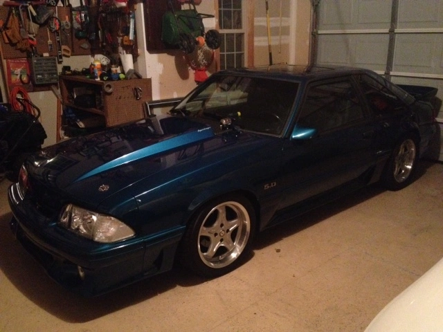

Installed the Cervini Ram Air hood today

I mounted them where the rubber bump stops went. Put some white grease on top and them drilled an 1/8 pilot hole and then a larger drill for the final hole from the top and bottom. I used UPR billet hood pins. They come with a circular snap ring instead of lanyards and keep pressure on the pin to keep it in place. Picked them up for $20 at UPR.

I had the functional ram air that is on the blur car pictured above about 15yrs ago. I had the K&N kit that goes with it. I liked the hood but hated the water that came in the scoops. It was a daily driver back then. I had no problems with it staying latched when properly adjusted. I would never drill a Cervini for hood pins. I would imagine it moves around a lot without the bumpers. I have a Cervini cowl now and it latches well too.

not sure about the OP, but mine doesn't move at all with the pins in place of the bumpers. it's all nice and snug.:nice:
