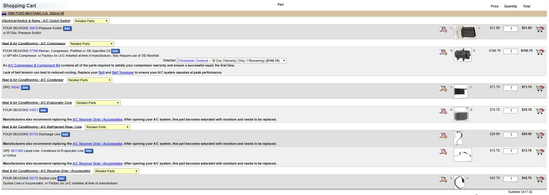

Their kit features a reman compressor. So here's a rockauto cart (click to expand) with all the same components and a reman compressor PLUS an evap core. The only parts missing are the AC manifolds (get from LMR) and the r134a conversion fitting (get from parts store). With shipping to me plus tax it works out to $490. There's a 5% discount code on the internet for RA if you search around.
So you save almost $200 and that includes the evap. You could splurge for a NEW compressor as well off RA if you wanted.
One thing i will note though. If you have an issue with the parts, LMR will go above and beyond to make it right. RA will tell you to pound sand. So that's really where the extra cost goes. Up to you to decide if that's worth it or not.
I restored my A/C system using RA parts.
