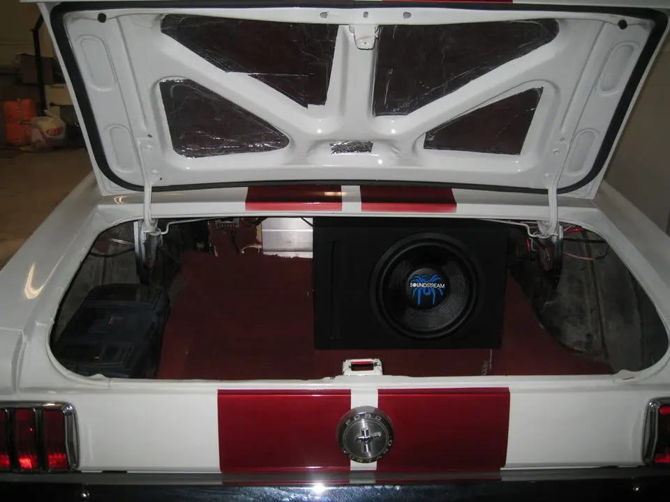

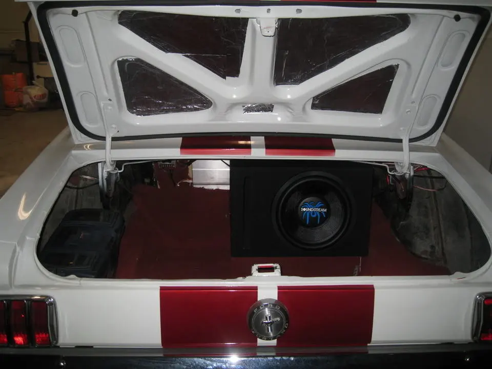

iskwezm's box
Not much modification needed, i had extra molding from the house sitting around, i screwed that to the bottom of the box covered it in carpet and from there used a corner metal bracket to connect one side to where the fuel tank bolts in and the other i drilled a hole to hump behind the seat.
The only rattling i had was the horse on the gas cap. after a month the decklid started to rattle but that was an easy fix , i just put a rubber spacer between it.
