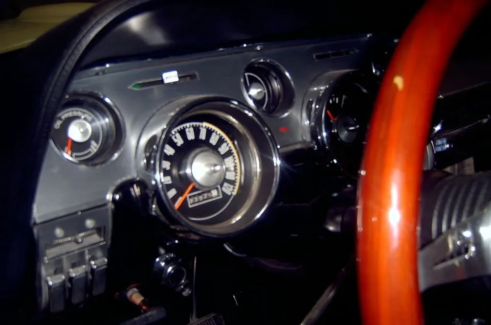

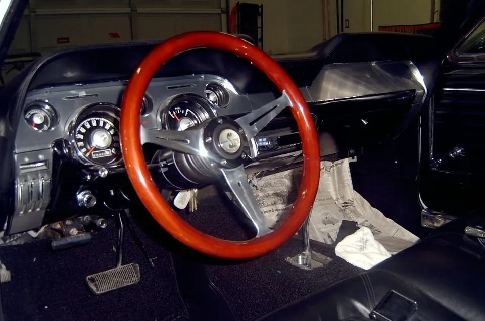

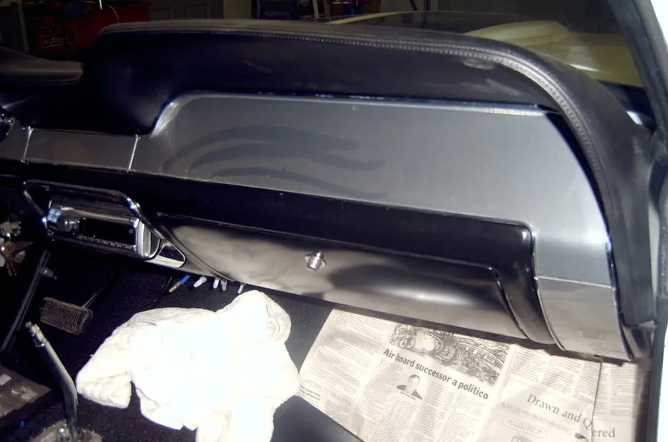

Bullitt said:
zookeeper, do you have pictures?
thanks in advance!
Since you have such a bitchin' fastback, I'd be more than happy to! Sorry they're not the best pics in the world, but it's as good as I could get. My digital camera kinda blows in low light.
BTW, those smears on the passengers side are my kid's fingerprints in the dust. I didn't see them before I snapped the pics or I would have wiped them off. The only part you need to re-use from your original dash parts is the heater control cover, everything else is new and the aluminum panels are pre-mounted and fit perfectly. I did have to do some very minor trimming to get my gauges to fit, but it took about 5 seconds with the X-acto knife. Other than that, no problems. Hope this helps!

Looks good Zoo! Didn't know he made a 68 version, nice horsey for the high-beam indicator too
Edit: is that bench seat?
The high-beam horse is another reason I like the Burton parts. I always did like the '68 horse, but was about to install the '67 aluminum panels when found Burton's stuff on ebay. It's not exactly the same finish as the Mustang/Shelby orginals, since it is clear coated, but I really think it'll look new a lot longer. Take my kid's dusty finger prints for example. As we all know, the more you touch bare aluminum, the worse it looks, but the Burton panels allow you to just wipe anything off with no damage to the finish. And yes, it's a bench-seat fastback. I was going to swap to buckets, but since bench seat fastbacks are kinda rare, and likely for a good reason, I kept it in there to add some character to the car. Plus it's comfy. Please excuse the mess, but I'm in the final few days of finishing the car and the present task is fixing the sloppy shifter and wiring the stereo. Hopefully I can make a local car show that's this coming Sunday.
