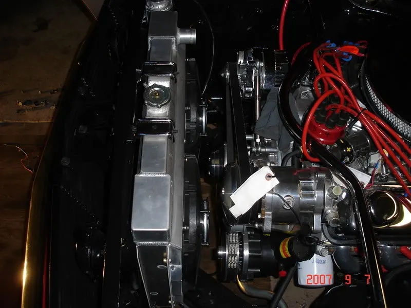

I need it
because I have a serpentine belt front end on the engine and when I mounted the power steering pump, there was no way the fuel pump would fit. So I "needed" to switch to the electric and just put a blank off on the engine.
I would rather have stuck with the manual. :D

I have a serpentine setup on a 5.0 with a mechanical fuel pump and it fits just fine. I have a hard time believing that a mechanical pump wouldn't also fit on a 351w. Does your timing cover have the provision to put a mechanical fuel pump in it ?
Looks like an Explorer setup, I can see now your reason. Mount the pump as close to and below the tank as you can. Electrics are made to push fuel, not pull it. Make sure you run a regulator too and it wouldn't be a bad idea to source an emergency impact switch off an EFI car to wire in the system.
