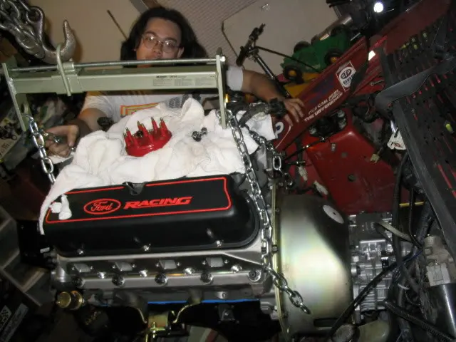

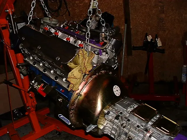

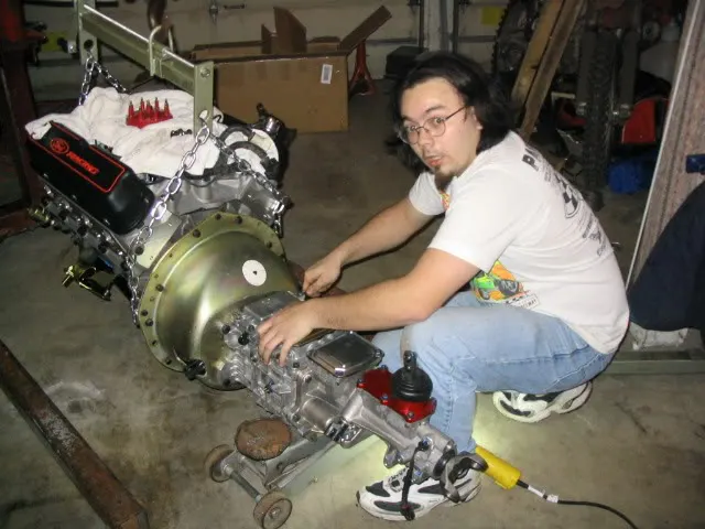

with a manual tranny i find it easiest to install as one. jack the REAR of the car as high as possible on jack stands or whatever safely. a engine leveler is your friend when doing this as well. the more you put on outside of the car, makes it less to put on later while hunched over the fender. the less you have to install on your back the better. you wont be scratching the paint at all. wrap the tail shaft with a rag or whatever. take your time, and make it as easy and painless as possible.
yes i look like a goofball in these pics
and here is mine hanging
