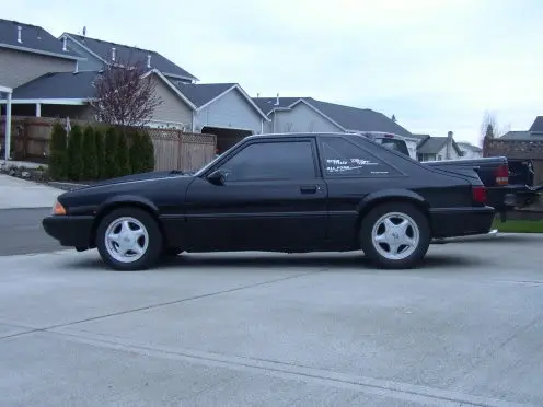

Thanks guys here are some pics of it. Took them today I wish the front was alittle lower though the back tire is tucked up alittle more then the front. What do you guys think wheels are next after a couple more suspension stuff. I was thinking about going with 03 Cobra wheels in chrome 17's up front and 18's out what how do you think it will look.

lol... Thanks for the props. They are the Steeda Super Sport Springs. No rubbing issues at all. Handles ALOT different the car's body doesnt twist as much as it did befor when I got on it. I am overall happy with it I just want the front alittle lower. I am thinking with different struts it will bring it down alittle more I hope anyways. I still have uppers and lowers and shocks to do in the back so I am thinking the back might drop alittle more when I do thoes other mods.
89white50 said:
honestly, looks great man...nice job. are you happy with it? any rubbing problems? what springs are those? im drunk:p
you could get a coil over kit, which lets you adjust ride height. its not that much $. but i have C spring and i know what you mean about the MUCH better handling, though mine are about as stiff as you can get.
when i did the suspension mods in my sig, my front is slammed hard, but my rear end is higher than your front end. i literaly have more fender gap on top of the wheel than on the sides :nonono:
the problem is the steeda lca's... the spring sits level with the stock control arms, but these jack it up about an inch.
