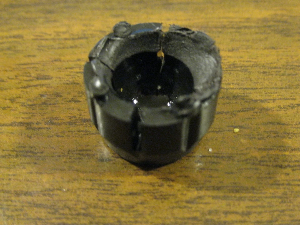

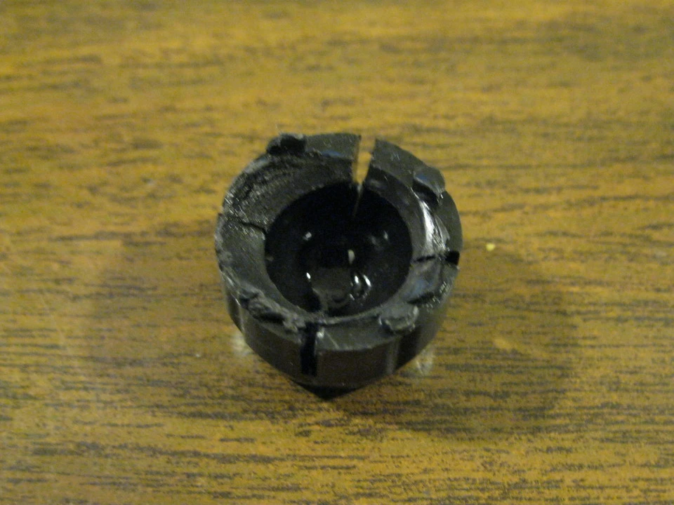

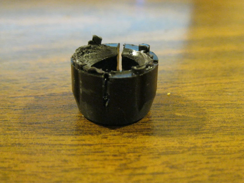

tracyballard New Member Jul 4, 2011 15 1 2 Feb 28, 2012 #1 Feb 28, 2012 #1 This plastic part from the bottom of the shifter seems pretty worn out - is this a problem? and if so, can I get another one?? thanks in advance!
trinity_gt 10 Year Member Jan 31, 2003 3,125 81 99 Canada Feb 28, 2012 #2 Feb 28, 2012 #2 Definitely done. What year is the car? T45 and TR3650 transmissions will require different bushings. For the T45 you might try: http://www.latemodelrestoration.com/item/LRS-7453A/84-04-Mustang-T5-T45-Shifter-Dampener-Bushing The TR3650 seems a little trickier to find. I've read that you need to go to Tremec direct for that. You might even need to purchase a new control turret (Tremec part no. TCEC1310)...
