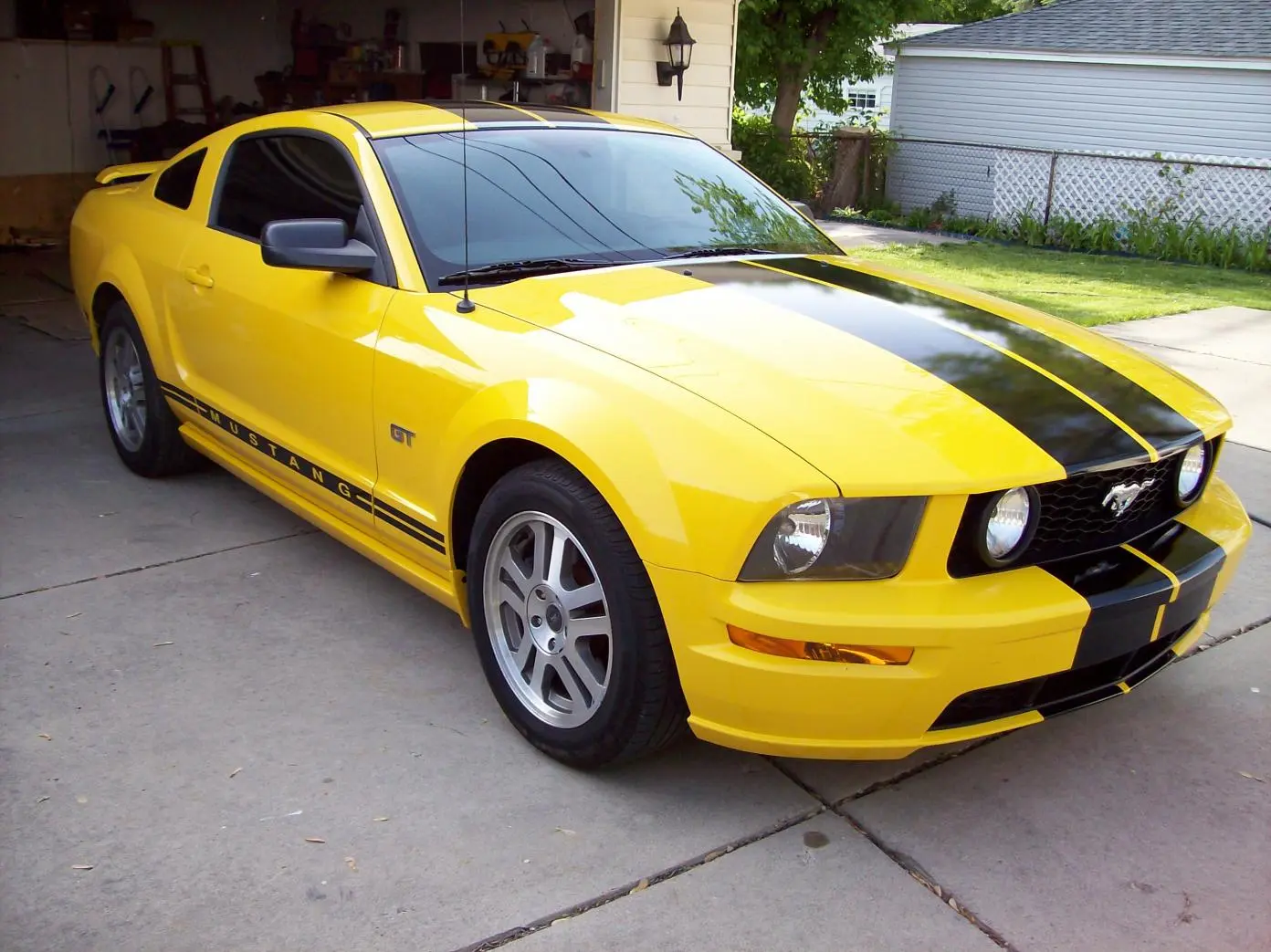

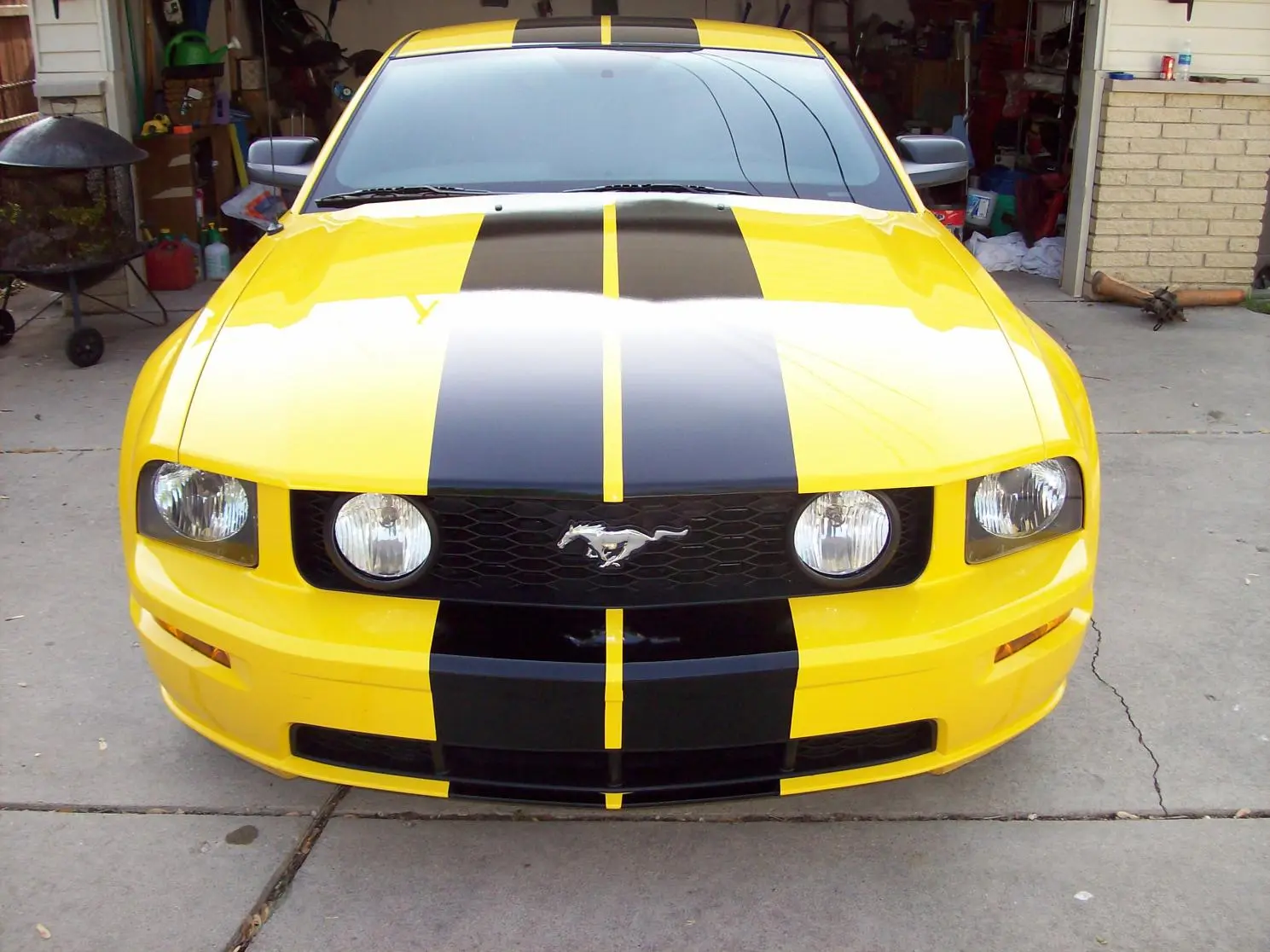

Im installing my racing stripes as we speak. Well actually im on a break as we speak, LOL!!! But ive got the roof, hood and front bumper all done. Just have the rear of the vehicle to go. Looks good so far, I cant beleive I was thinking about paying to have this done!
Pics will be on the way as soon as Im done.:D
Here are some pics, took about 8 hours total
Bought the stripes off Ebay for like $70 shipped. It was a precut kit from the DecalShoppe. And they look sweet, its like I have a whole new car!
Only problem is now I think im gonna have to buy those new wheels Ive been eye ballin! Then I'll be done as far as the looks department goes and can start with the good stuff. (as a whipple is in the future) :D
