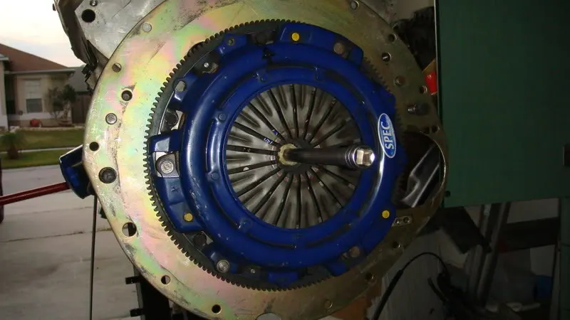

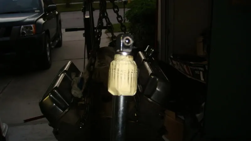

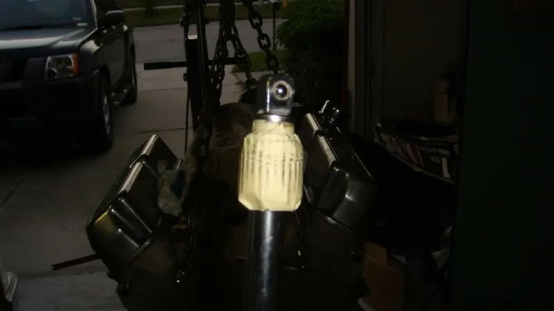

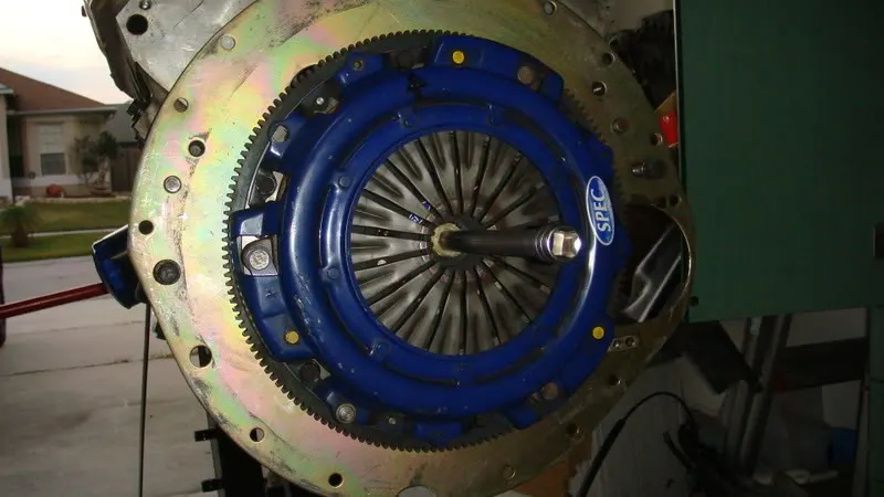

Just make sure you have a clutch centering tool or make one. Here's what I used:

Hmmm ... never seen it done like that before. Cool trick to know, in case a clutch kit doesn't come with the alignment tool, or you've misplaced it by chance. :nice:
LOL, building a beast on a budget sometimes you need second hand parts. With that comes sacrifices to luxuries that come with new parts. Too keep from spending more money you are only left with ingenuity. :nice: Write that down :lol:
