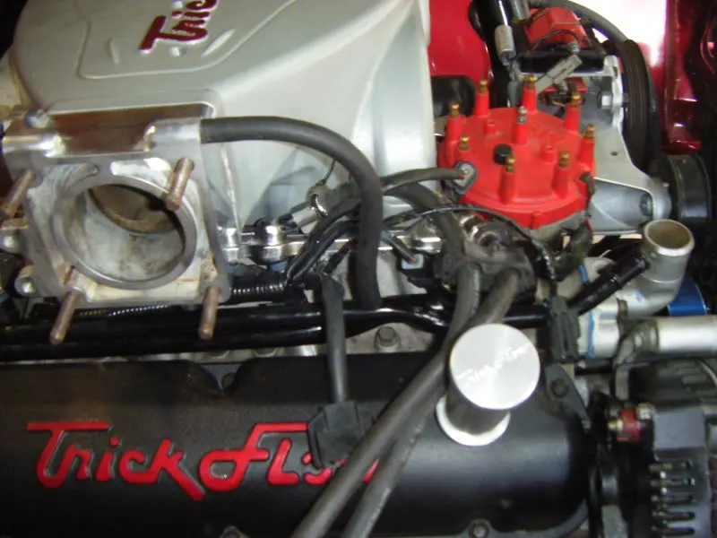

DO NOT use a 1 1/4 hole saw!!!!! its too big and will leave your grommet sloppy.... i think trickflow said the hole needed to be 1.181'' or something alone them lines 1 and 1/8th works perfect.
My hole saw skipped around at first and left a small recess for the gromet to fit in.... it actually worked out lol.
shows my placement quite well in this pic.... any questions send me a pm or just give me a call:nice:
