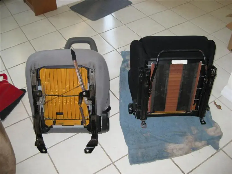

At a quick glance, I had a feeling this wasn't going to work...

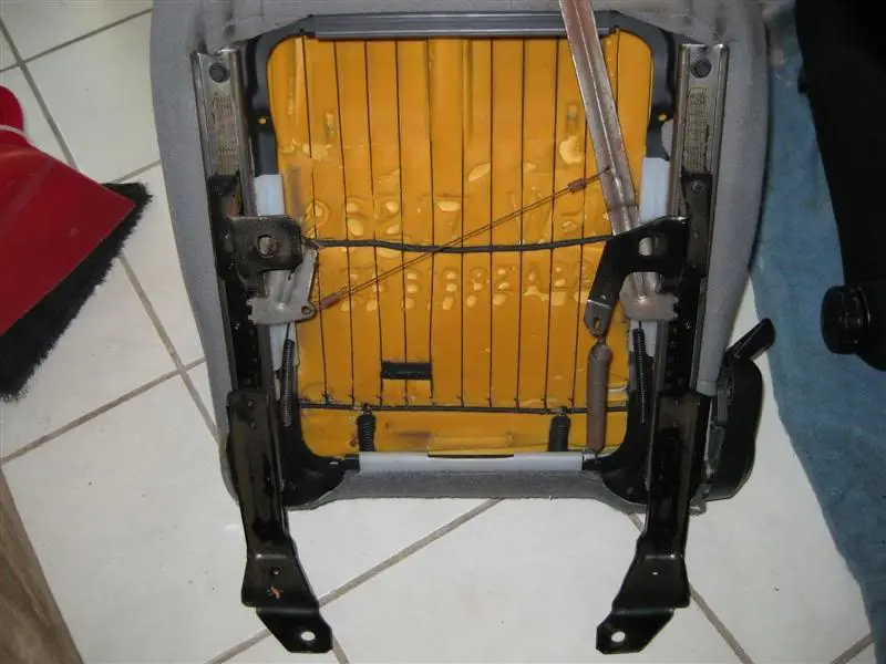

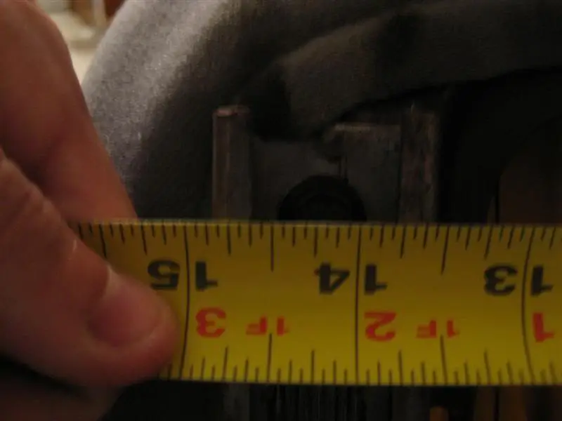

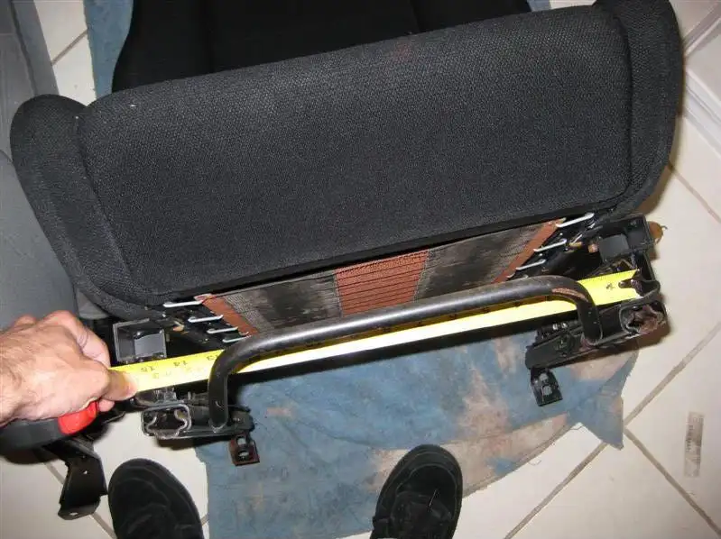

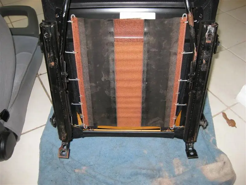

The more I looked at them, and thought about how the hell this would work, I finally thought of something. I measured the bracket that holds the sliders on the recaros...
Its 15 inches from bolt to bolt. Then I measured my 89s factory seat...
Its about 14.5. So my thinking is that if I mount the 89s brackets with sliders onto the Recaros, the bolts on each side will be off by .25 inches. The metal part that gets bolted to the carpet on a fox are pretty large, and I'm pretty sure those holes can be enlarged without problems. I have a friend bringing me sets of brackets with sliders this weekend.

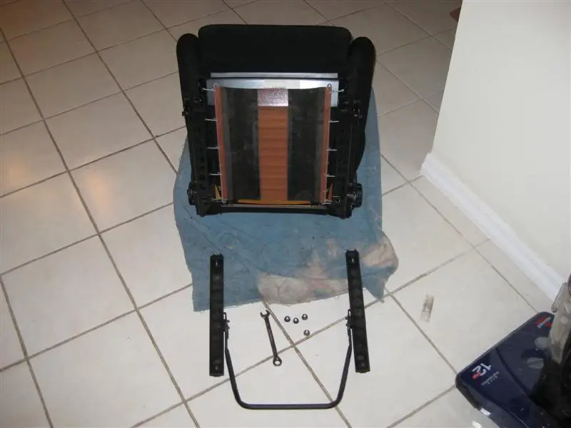

I already removed the Recaro's brackets.
Hope this works!

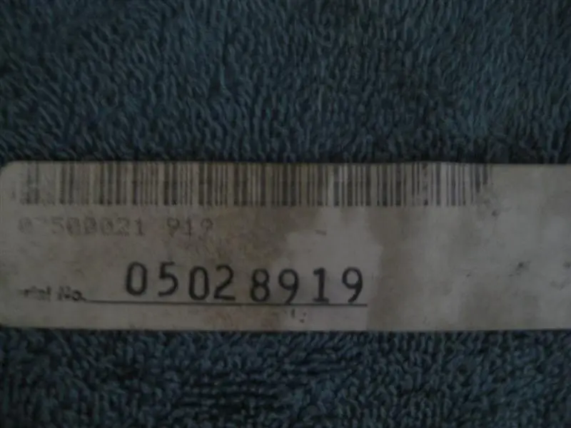

They didn't come in any factory car. They were in a 82 volvo the last 8 years however. They are in beautiful condition and only set me back $400.

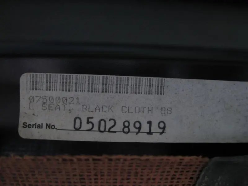

Here's two stickers I've found on the underside...

enlarging the holes will work. i did it on my car. adding some washers won't hurt though, just in case the worst happens. i even reused the stock seat to bracket bolts on my aftermarket seats.

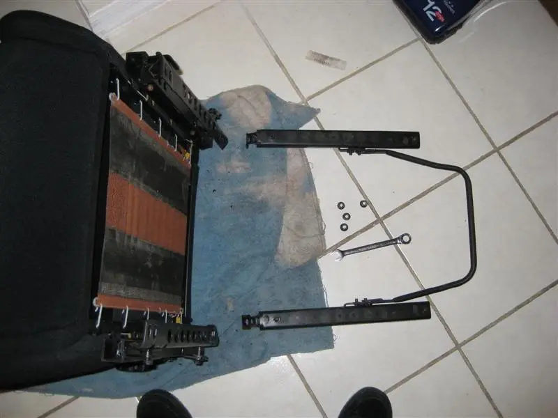

Got the sliders.
My fault, but I forgot to tell me friend to bring the 8 bolts that hold the sliders to the seats, so I'll be making a trip to lowes tomorrow.
