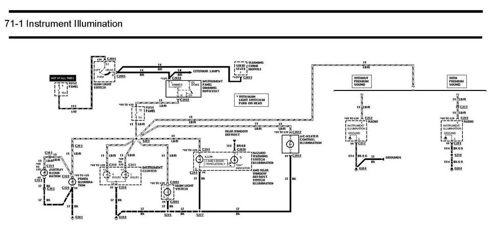

Instrument Lights Wiring Diagram Please...
Dont quote me but power is from head lite switch pin I.at cluster lt blue with red stripe is hot than black is grd. You can jump at headlite switch use jumper wire b2 and I lites should lite
