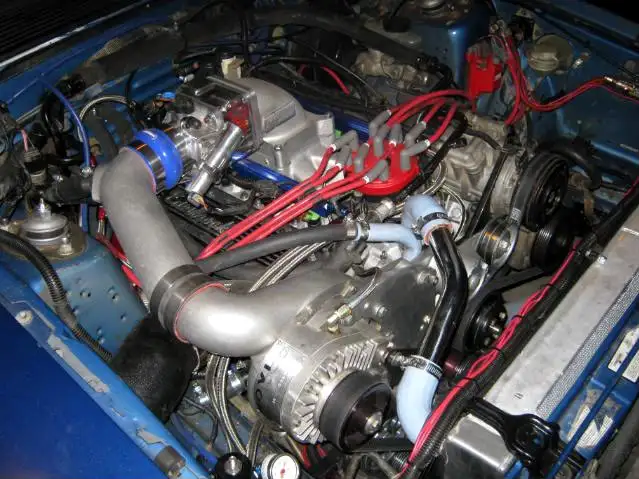

So I took off my discharge pipe to the throttle body, I haven't taken it apart since I put everything together (about 2 months) and it is BLACK! The TB is black, discharge pipe and even the supercharger discharge is black. Obviously there is an issue, what can cause that? I have noticed a backfire when giving it about 1/4 throttle after shifting into 2nd, it just doesn't like anything but 1/2 or more. I thought it was an exhaust backfire, but obviously not.
Could it be that my valve lash is too tight, causing unwanted overlap? (just throwing ideas) These are the first rollers I've set, but a hydraulic lifter is a hydraulic lifter, no?
Let me know what info you need, this pic should help:
Edit: After doing some reading, it could be timing or lean...timing is bang on 10..vacuum leak on the intake? I am using used injectors, could the orings be messed?

Backfiring out the intake is either a valve stuck open or a lean mixture or spark plug wire(s) connected to the wrong cylinder(s). Check compression on all cylinders and then look for vacuum hoses loose, cracked, or misconnected. Check the line for the vapor recirculation system – it is easy to knock loose and not see it when you connect the air pump plumbing. If the vacuum line for the EGR valve and the air pump are cross connected, some very strange things can happen. Check the mass air flow electrical connection and see that it is tight, the same goes for the fuel injection wiring harness connectors up on top of the manifold near the firewall.
Sticking valves: If a intake valve is bent, has a bad spring or is misadjusted, the engine will sometimes backfire through the intake. Use a vacuum gauge connected to any convenient spot on the intake manifold. Run the engine at 1000 RPM & look for 18-21 inches of vacuum with a steady needle. A problem intake valve will make the vacuum gauge needle sweep 5-10 inches.
