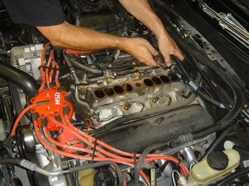

Things are going smoothly.... :)

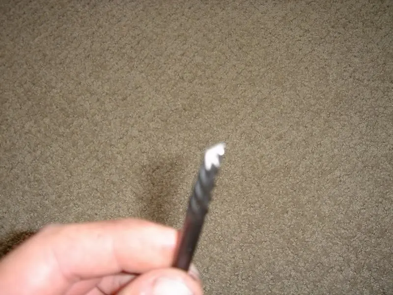

Things take a turn...but I take it in stride, head to the store, and pick up an ez-out :mad:
Now I don't know what I'm going to do.... :bang: :shrug:

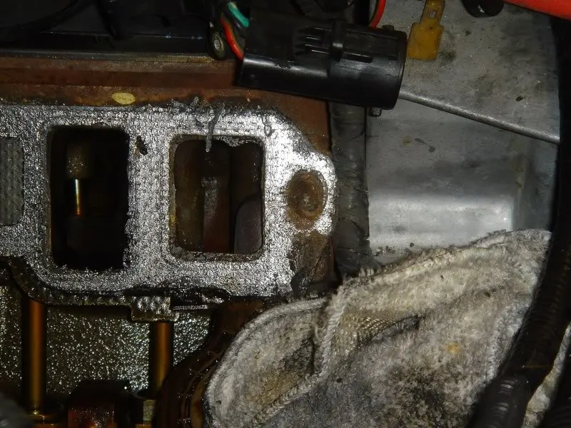

Any and All, thoughts, idea, or possible solutions would be greatly appreciated. Right now the tip of the EZ-out is in the center of the bolt still in the head. And none of my drill bits are putting a dent into digging through the damn thing :nonono:
I've been trying that as well as chipping it out. The things in there pretty good. I'm sure with enough persuasion I'll get it out eventually. I've stopped working on it for a now since I'm having a BBQ at my house (My little brother got back from Iraq today for two weeks leave :flag: ) I'll get back to it later and hopefully many of you will have good ideas for me. Thanks.
- Justin
Get a good set of drill bits start with the smallest bit available and work your way up to a size smaller than the extractor bit with alot of PB blaster.Then use the extractor bit in reverse and you should be in business.Use a nail or a hole punch to mark the center of the bolt so the drill bit can start straight.Good Luck:nice:
Take the head off, it'll save you a LOT of aggrivation on a workbench than it would still in the car, getting metal flakes in the engine. Luckily, it's one of the end bolts, so it goes all the way through and you can get to it from the bottom. I had a set of GT40P heads I sold that had a bolt broken off in them, and I was able to drill it out from the bottom side of the head using a bit that was just smaller than the bolt itself. If you have a steady hand, you can do it with a hand drill and spare the threads.
I've heard of people using a carbide bit (a couple of them) to drill through the High-density ez-out.
They're very brittle though so you have to make sure your are going straight down on it and the drill doesn't move around...also, pb blaster is your friend.
It looks like I'm screwed. All of my craftsman carbide tip bits are either making no progress or breaking. Any kind of punch or sharp point chisel type piece I use, the metal just mushrooms out and doesn't chip the EZ-out at all. And then on top of this, the outside edge of the head where the bolt hole is crumbled off. This might really end up with me replacing the heads. Pretty soon I'm not going to know what else to do :notnice:

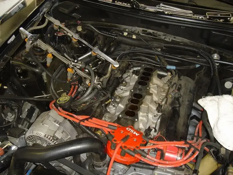

I usually don't pay too much attention to pics :shrug:
but
In this case :D
Be careful those inj's don't drop away from the rail :Word:
don't wanna crack any of those Pintle Caps :nono:
Hope that bolt breaks loose easily for ya :nice:

I went to Sears and looks like I'm going to try some Cobalt drill bits. On the label it says that they are for all types of metal including "hard". They seem to be working a little better than the Carbide so far, so I hope now it's only a matter of time and patience.
