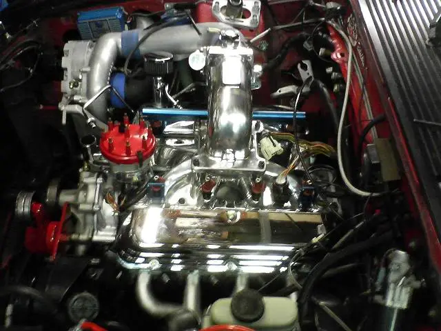

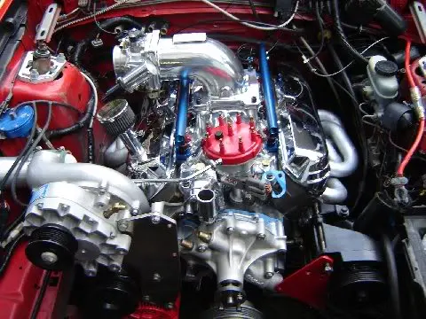

i need to know if it is possible to run my 91 gt without the act sensor. reason i am asking is i just insalled the spyder intake and the only place i can put the sensor is in a coolant passage on the lower intake. from what i understand the act sensor should pick up air temp. what are my options? will it kill me if i leave it out? here is a list of mods on the car
306 ci. i-beam rids, hawks crank, forged pistons, stock e7te heads ported w/ crane springs. 1.7 rollers. e-303, s-trim, 70mm throttle, 70mm mass air, spyder intake, 36lb injectors, fuel press set at 43lbs vac line off. if anyone has this intake how did you set up all the sonsors? thanks in advance joe.

sounds like a very well detailed plan. here is the problem, i have no problem extending the wires to the new location. i have no air box, and the inlet tube in mandrel bent aluminum being i have a bower on the car. the only location i can see fit to put the sensor in after the mass air meter just before the blower, there is a plastic elbow. will it work in thisl ocation? thanks . joe
Since you have a supercharger, the intake air charge will be hotter that atmosheric air. You will need to locate the ACT after the supercharger to get an accurate reading of the intake air temp. Any place after the supercharger you can make a secure, leak proof mount will be OK.
If you had an intercooler, the best place would be to mount the ACT after the intercooler near the throttle body.
On a stock 86-93 the ACT is mounted in #5 intake runner.
