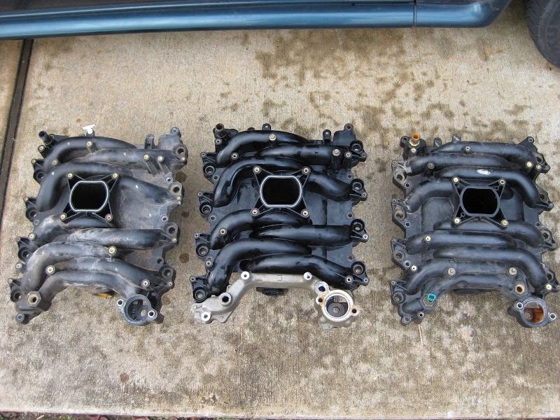

The two on the left are PI intakes, the one on the right is NPI. Note that the runner closest to the front of the intake goes to the right on the PI intakes and to the left on the NPI intake.
PI intakes (top) have more rectangular ports compared to the round ports of the NPI intake (bottom)

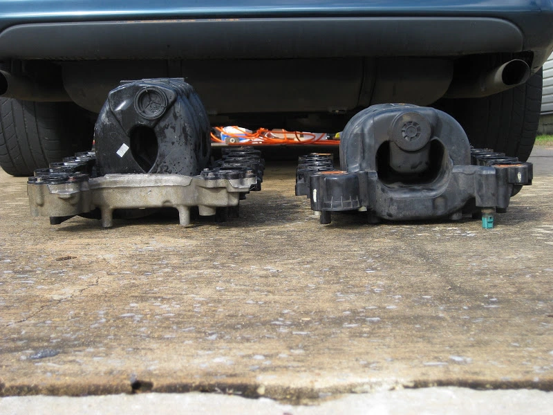

PI intakes (left) also have much longer runners than NPI intakes (right)
