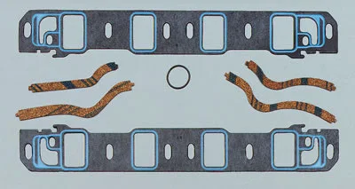

Just ordered these intake gaskets, fel pro 1262, do you guys use the cork strips or just a bead of RTV sealer? I couldn't find the felpro blue rubber ones.

ultra grey RTV here, i've bene taught to use that and nothing else, so i dont have any experience with the cork except pullign apart an engine that used em, without problems it seemed, but they can slip out of palce easily
~Mark~
The cork gaskets work fine. Jrichker helped me do mine a while ago and we used blue silicone on the ends, and the cork gaskets. Ive also used the blue ones. You should be fine either way.
My favorite trick that saves time and effort is the stay in place gasket. Be sure that you scrape (don't use a wire brush) all the old gasket material off, then clean all the surfaces with acetone or MEK.
When the surfaces are clean, use weather strip adhesive on the head to manifold surface. Also use the weather strip adhesive on the side of the gasket that mates to the head. When you are done, the head surface and the gasket surface that mate together will have weather strip adhesive on them. Follow the instructions on the tube or can and when it gets tacky, press the gasket down on the head.
Clean the area where the rubber rails mount to the block in front and in the rear with more acetone or MEK and do the same trick with the weather strip adhesive that you did to the heads.
Coat the rubber seals and the gasket area around the water passages with lots of Blue Silicone gasket sealer and put it together. Wala! no leaks, and no gaskets that shifted out of place.
