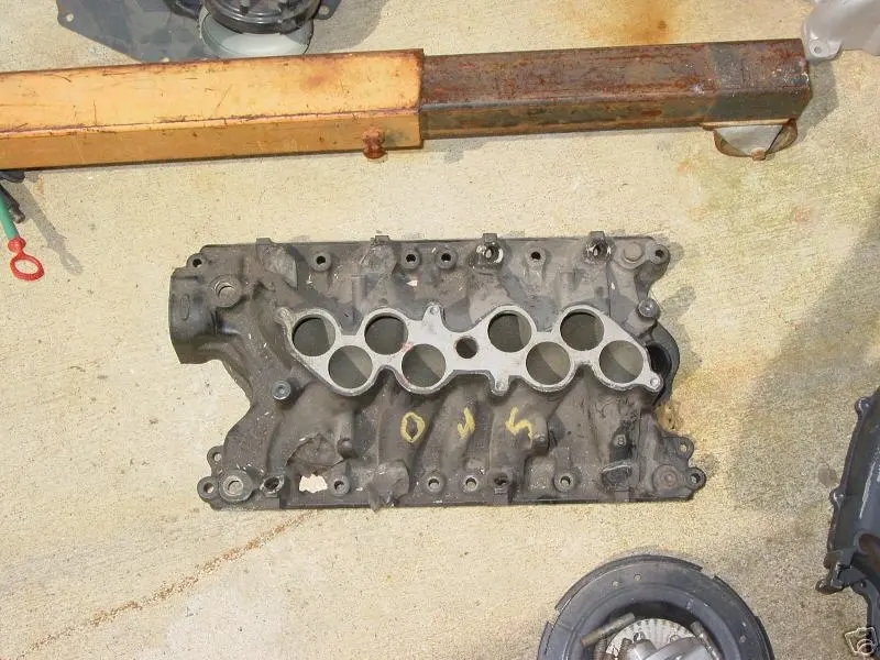

stock 5.8 lower intake

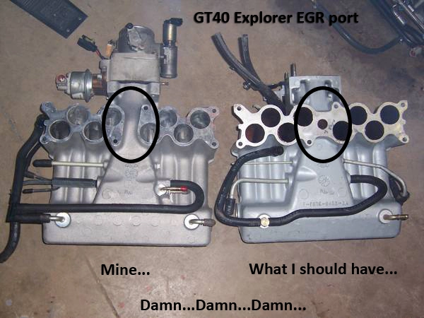

351 GT40 lower intake manifold
+ 1996 Explorer upper intake w/EGR passage (or 1993 Cobra intake)
(one on right)
That's about your best shot at a 351 EFI intake that will pass smog.

you are exactly correct. i'm wanting to put a stroked 351 into my '87 GT. i found a couple of possibilities on LMR. i believe they were trick flow units. i already have an explorer upper. i'll have to look in the morning to see if has the EGR hole. not sure what year it came off of. without doing too much digging, it appears that i'm pretty limited on lower intake options. as i get closer to putting this motor together i'll have to really look at "the numbers" to see if it would be worth the effort to run a 393 or 408.
by the way.......thanx for the pics!!!!!
