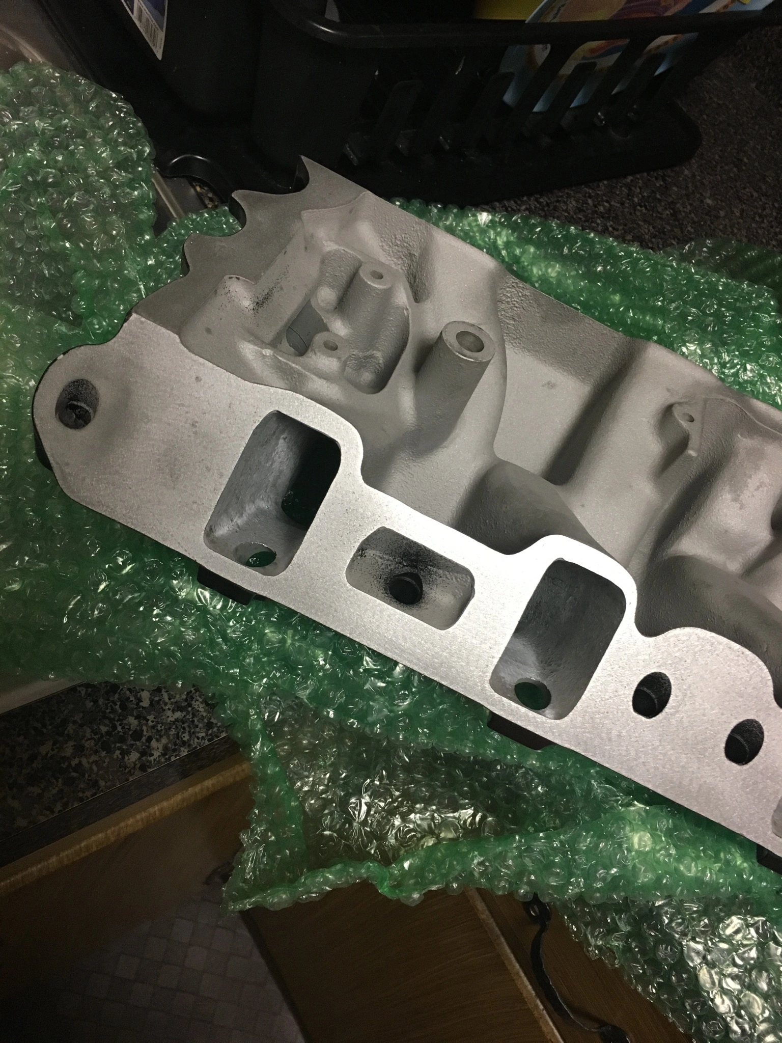

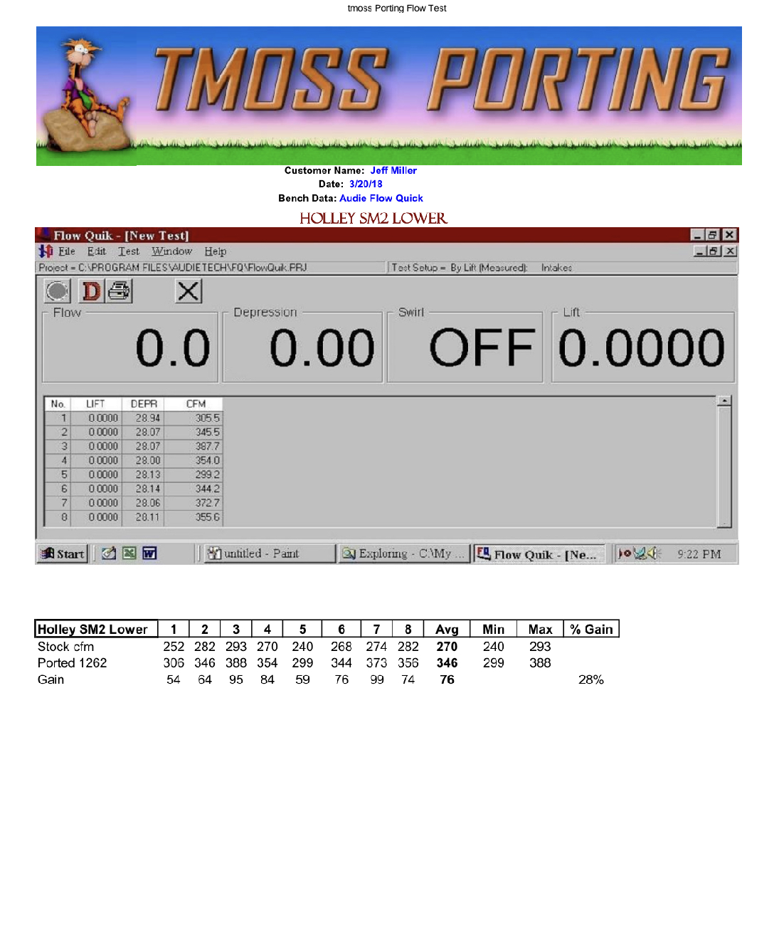

send your intake to Tom Moss and have them port it. It will flow about as well or better as most after market intakes for far less money
I’ve heard good things about TMoss porting. I’ll have to check him out and that will most likely be what I end up doing.

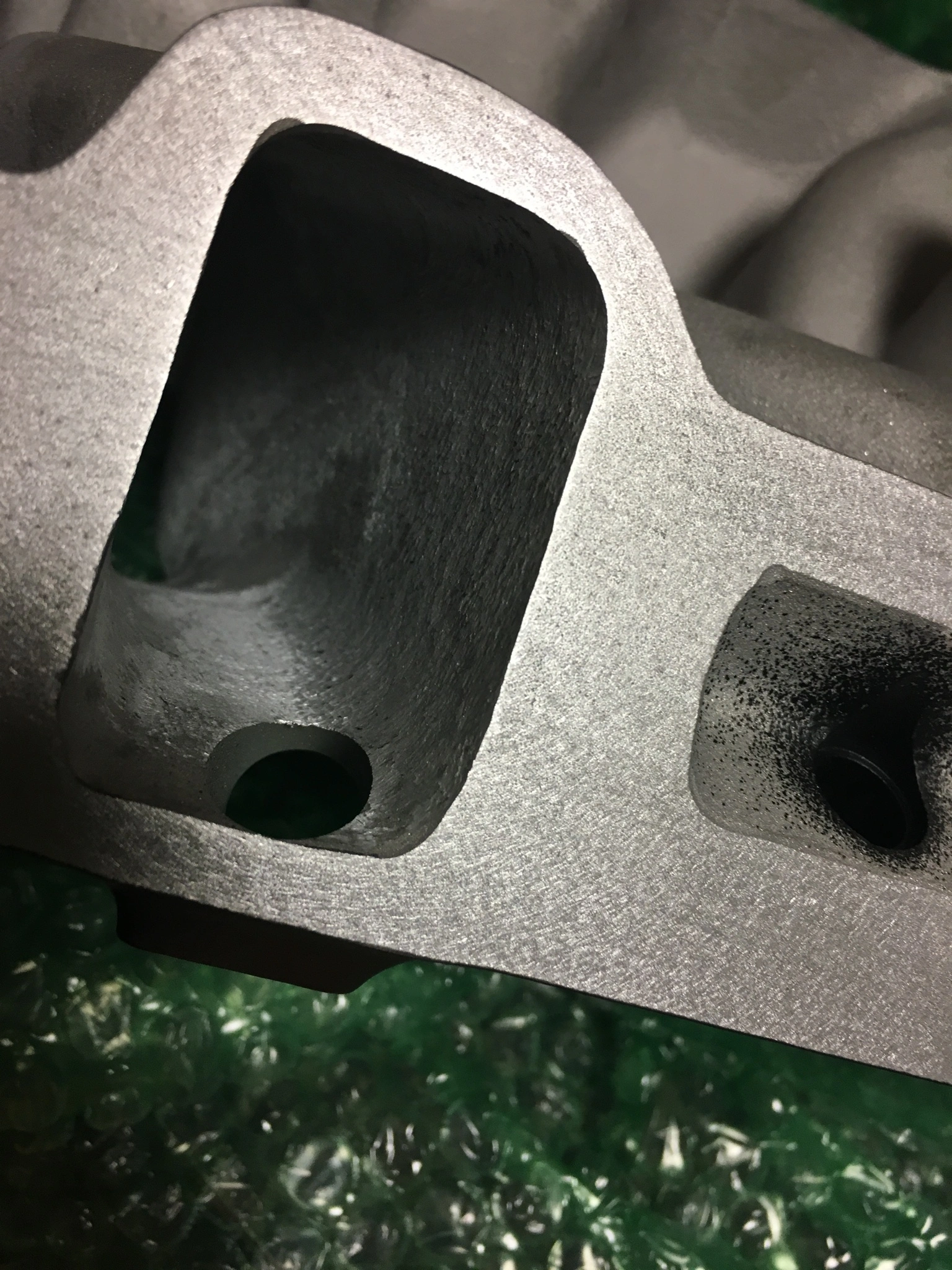

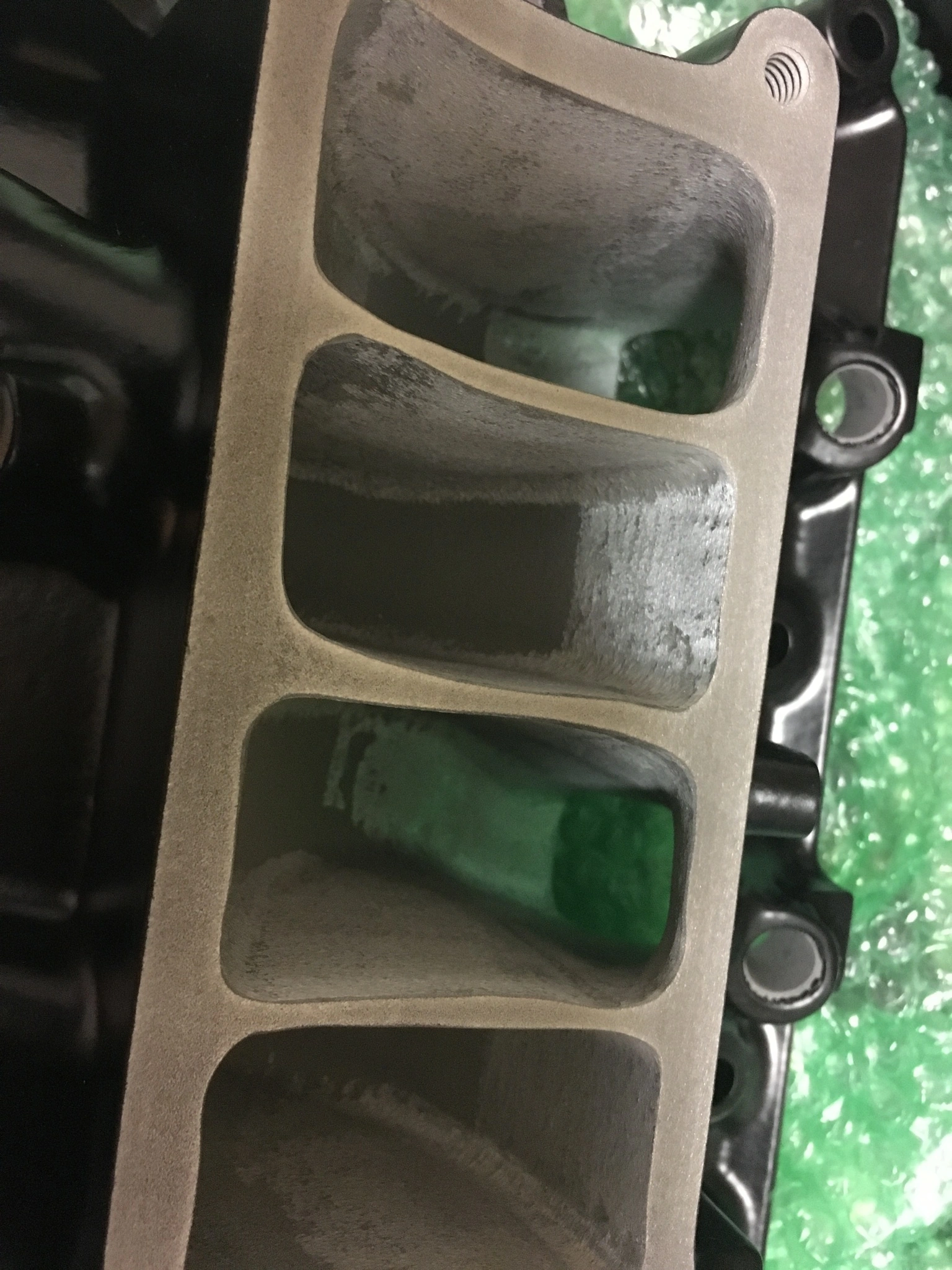

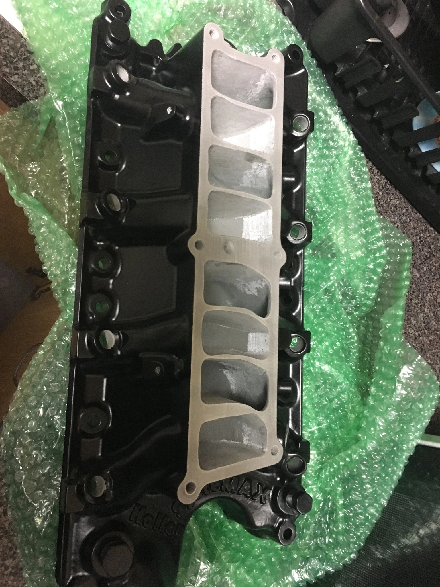

I have a Tom moss ported systemax on my car . It works very very well . Was worth the money for sure .

My Cobra intake was done by tmoss. Actually, it's his son Matt that does the porting now.

Yes , I have a box r I may send to him before it gets re coated and goes on the car this winter .

Another vote for TMoss porting. Ask him if it would be worth sending both the upper and lower intakes as I cannot remember if there is a restriction past the throttle body on the Explorers. I will be sending him the Edelbrock Performer RPM II upper and lower on my Coupe at some point but in the middle of selling and buying a house and then will be building a shop so the car is on hold for a bit.
