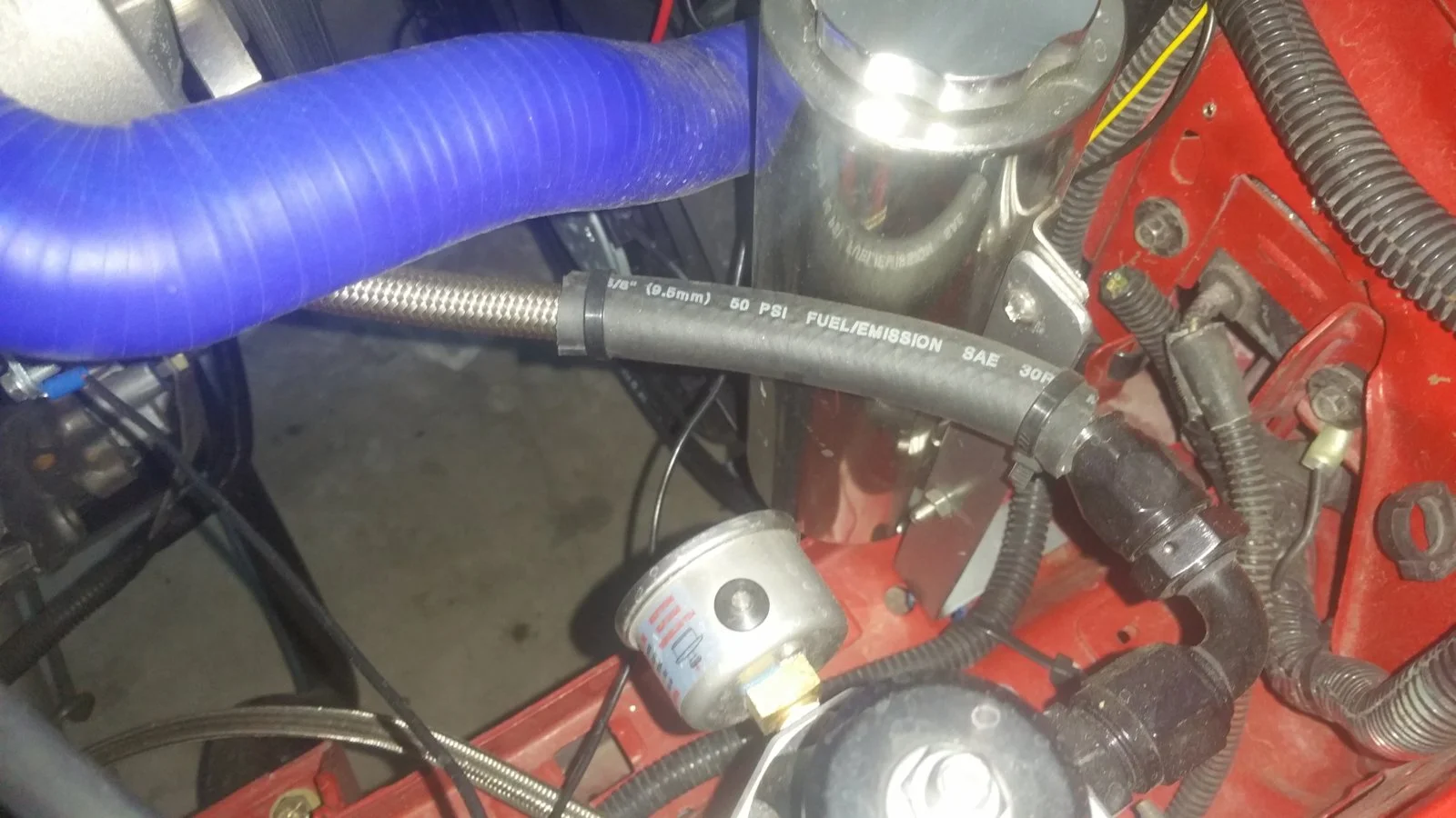

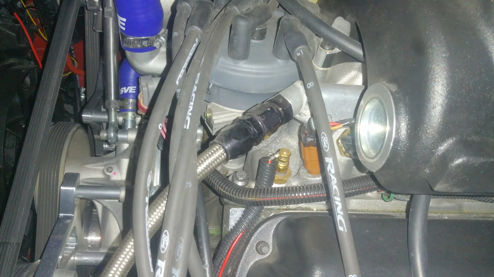

I have a small coolant leak. I'm fairly certain that it's coming from the lower intake, front driver side mounting bolt. I want to remove and reseal my lower intake. I have a Glenn's Fuel system. Would unbolting these 2 fuel lines be ok to do with a small rag ready to catch any fuel that may leak from the disconnection? I don't know how much pressure would be released when I unbolt the 2 fuel lines to get "access" when removing the intake. Any other intake removal pointers? Thanks guys.

Use the schrader valve on the supply line that is or the fuel pressure test gauge to the relieve the pressure in the fuel line. You won't get more than 1/2 of fuel out of it
Relieve fuel pressure and continue disassembly. Use eye protection.
Be careful when removing the front most and rear most intake manifold bolts.
Corrosion is common and may result in significant additional work if the bolt breaks off in the head.
