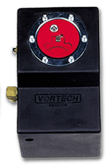

my stock intercoler tank cracked, dosent surprise me, its a saleen part, well the problem is i dont like the chicane one and i would like a black one, gettin it from saleen is a small project and i wouldnt see it for a mounth, so does any where else sell it? should i repair it? its a small hairline crack in the top RTV mabey?

Another option is to relocate the battery to the trunk and run the Vortech intercooler box. Here's a link...
Vortech Reservoir
