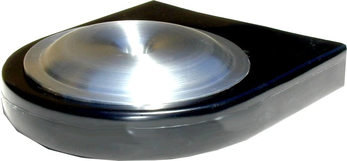

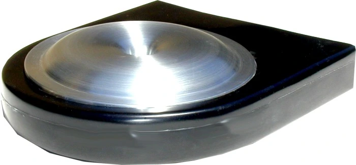

Let me get a pic of mine and throw it up. Fabricated from aluminum and uses the Edelbrock type air cleaner.............................

Here you go, using Shelby style hood scoop. With no scoop just run at least one 3" diameter flex hose, two would be better, from under front valance into this box.
