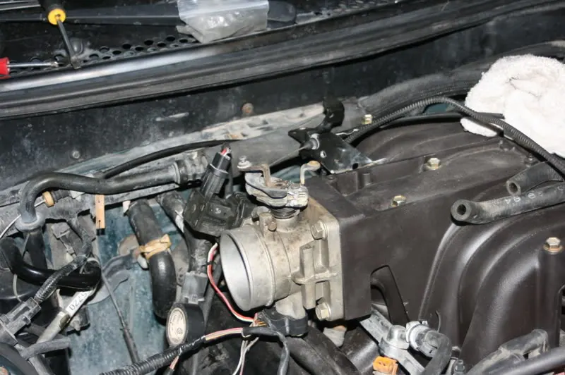

mounted mine like this. with the iac in this position, there was a strange noise coming from the air filter (sounded like a donkey, hehehe). we flipped the iac around to where the connection was on the bottom and the donkey noise went away and the car ran a better. guess it was on backwards. hope that helps.
